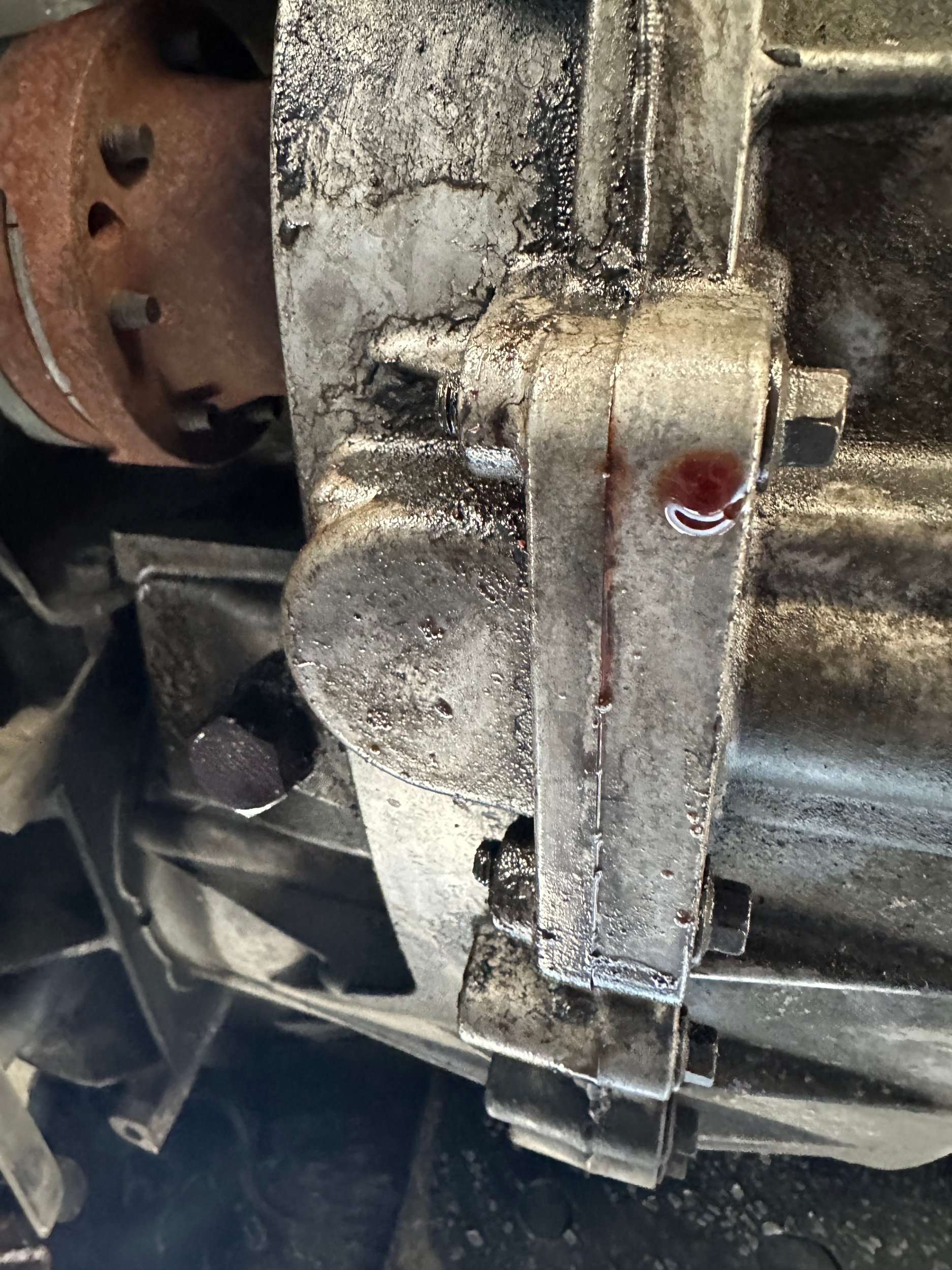

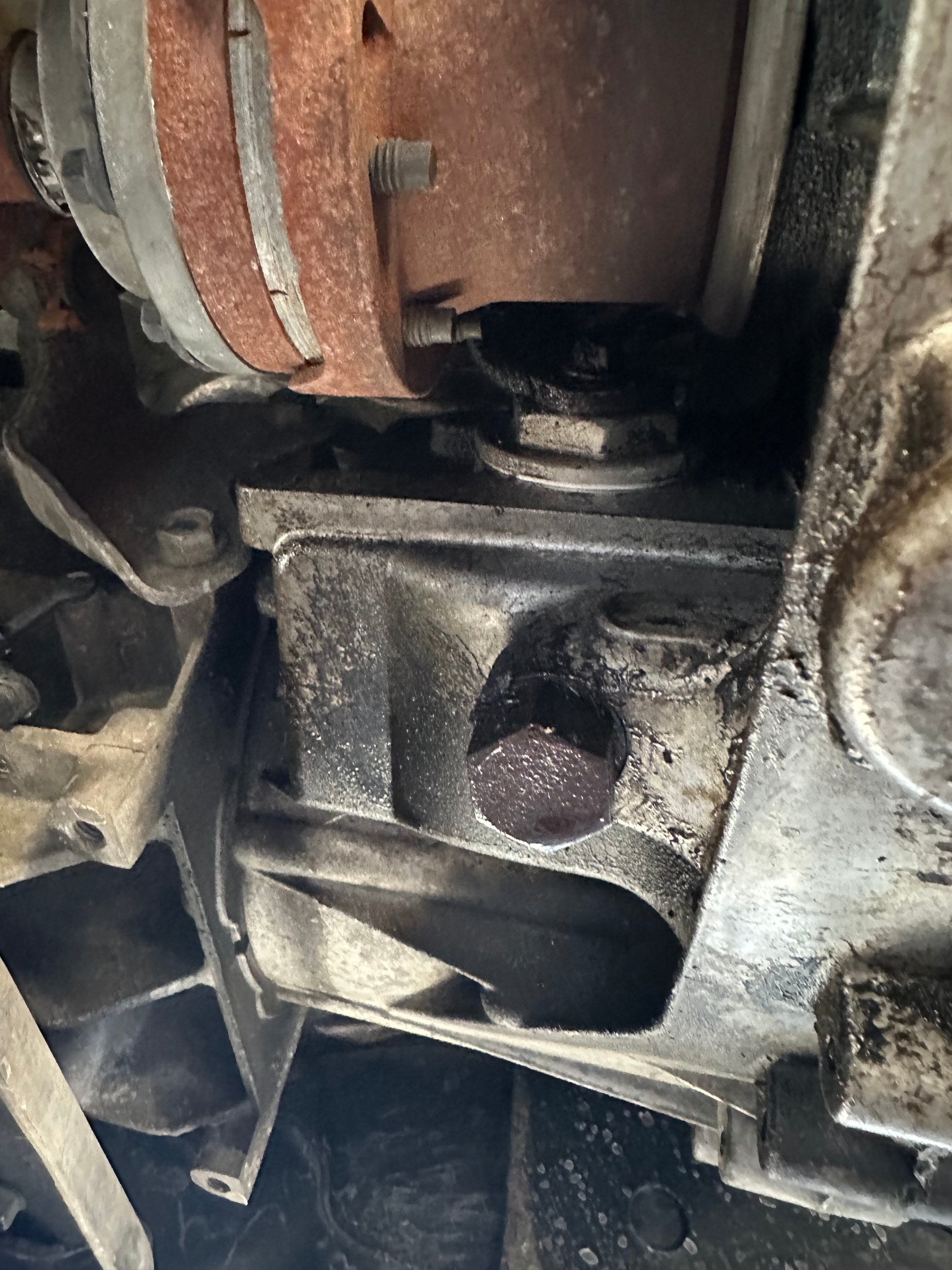

My 2010 2 door sport transfer case is leaking. Haven't been able to find the source, looks like it is near the rear of the unit. I'm guessing this is going to be a real pain if I need to drop the case.... Any thoughts on probable leak source?
The reddish color indicates transmission fluid.
