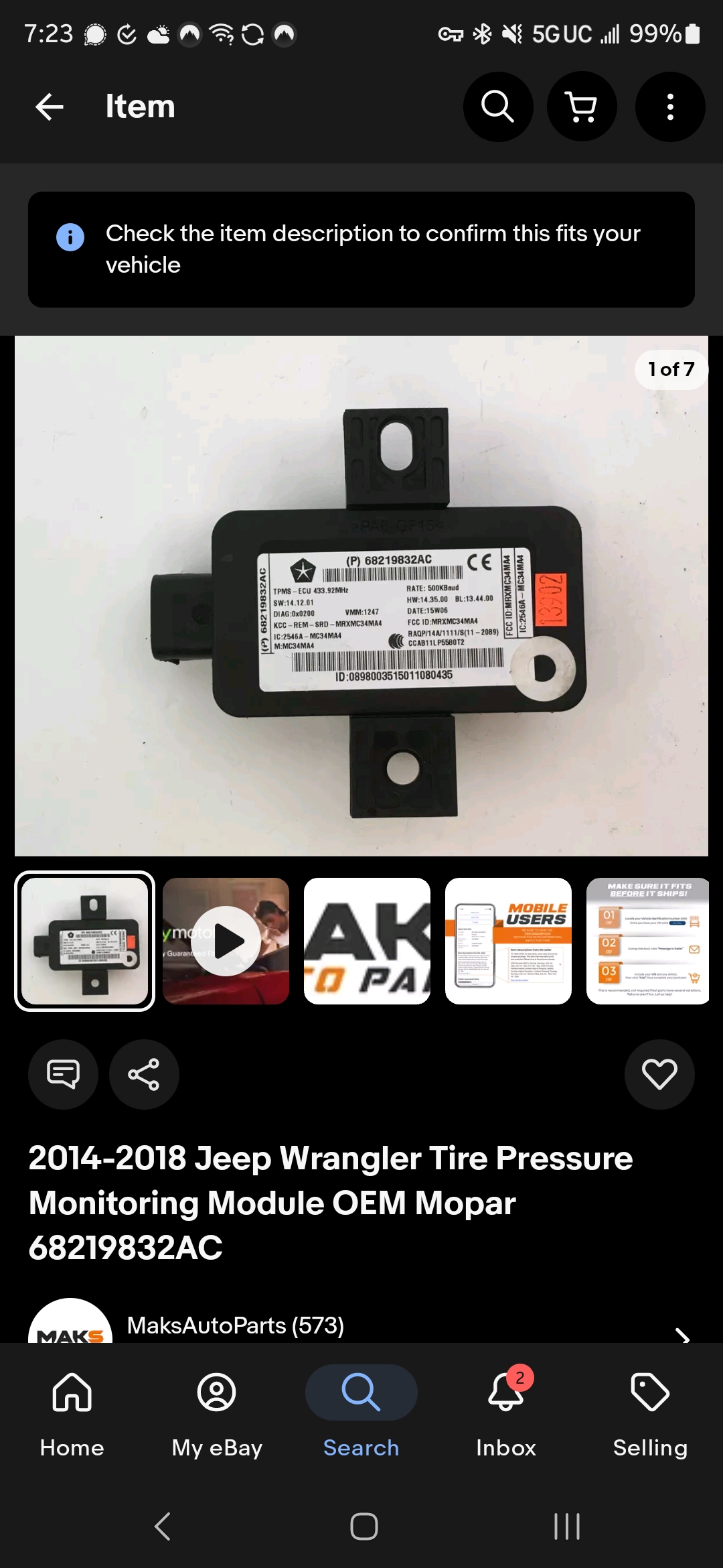

So im getting error codes regarding communication error with the TPMS receiver. I have 5 brand new transmitters in my tires. I saw a past thread that showed a diagram of the receiver locations. Im assuming there is a receiver for each transmitter, correct? Because I have no idea how many of my receivers might be broken so i ordered 5 of these on ebay.
Did i make a mistake?

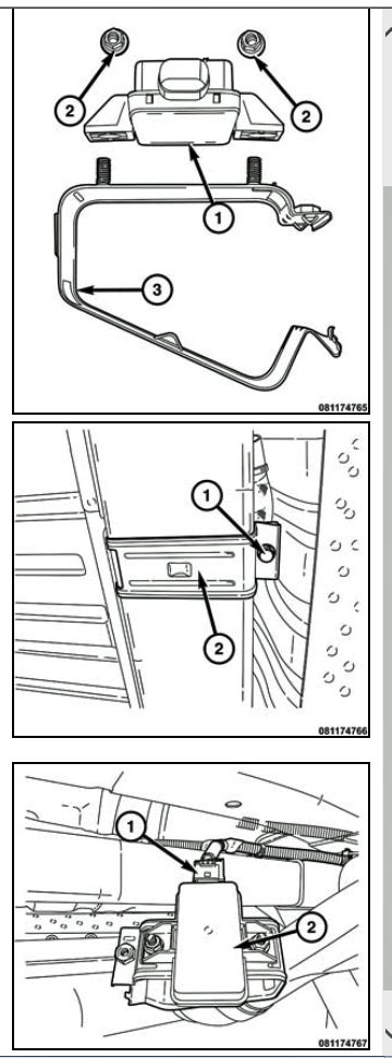

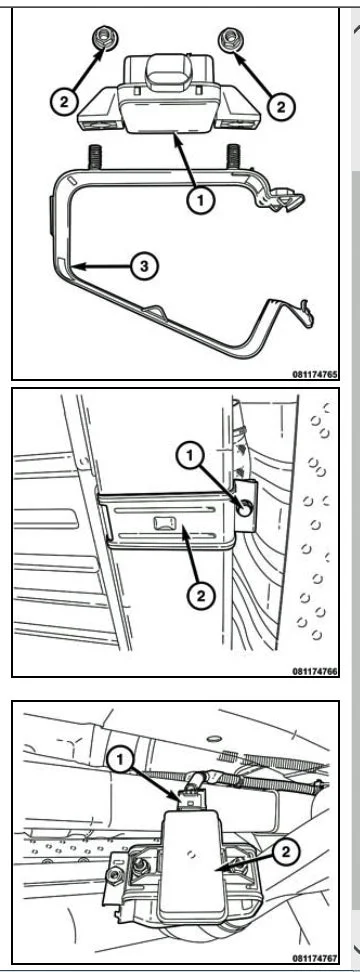

I found this diagram for receiver locations but now im confused if these are possible locations, or all locations

It is my understanding there are 3 receivers.
1 is located on a cross-member bracket near the rear axle, which monitors the rear wheels.
2 & 3 are located in each of the front wheel wells

Which of all of those numbers on that label is the part #?
Everything I search for comes back as the monitor that goes in the tire, not the 'receiver' that mounts to the vehicle.
The part # is the number after the P at the top the module. There are modules that end in AC and others that end in AD. They use the same Mhz and the same FCC ID number. The only thing thats different is the RAQP # and the ID.
