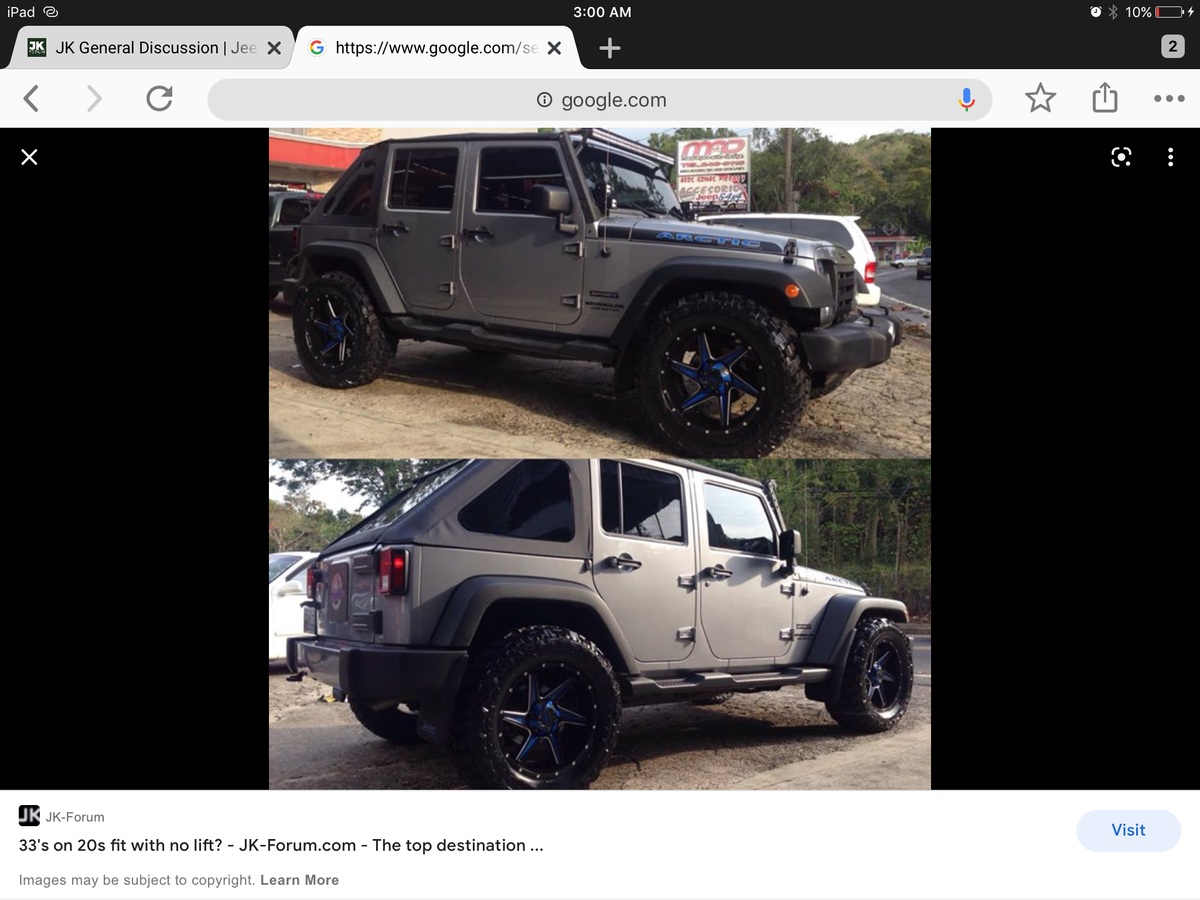

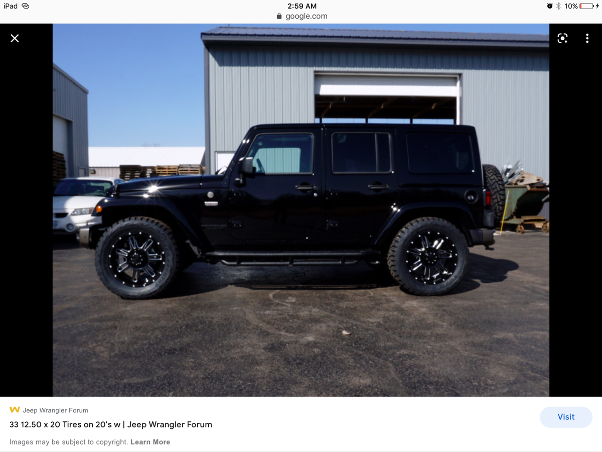

Agree 100 percent. Here are a couple internet pics . Not a huge fan of look and ride quality would
be harsh with C or D load tires. Not much if any sidewall flex.
