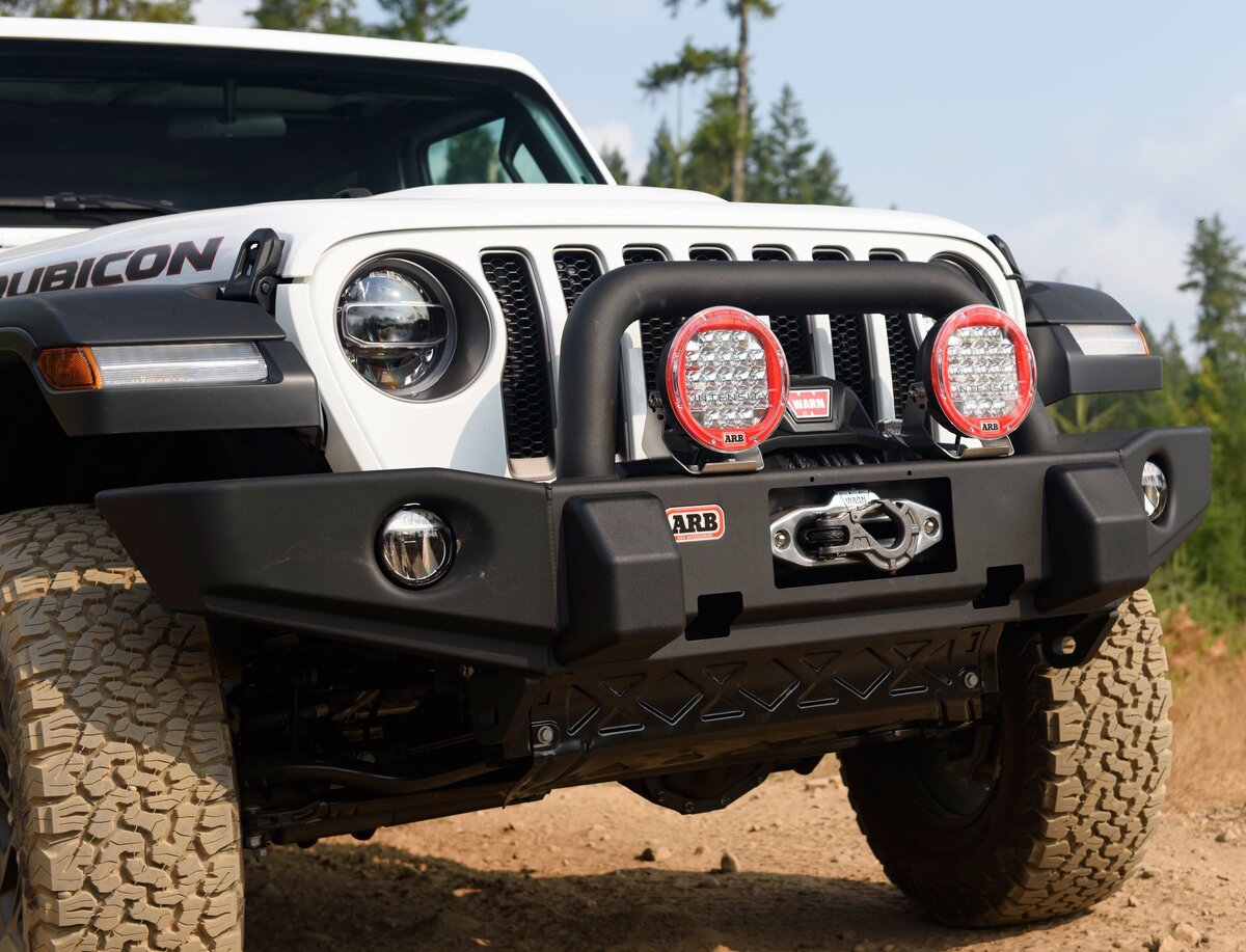

One might wonder why we haven't upgraded the front or rear bumper as this is a two part answer. First the front bumper hasn't been upgraded because we're still not done with the suspension, then learning the caster angle is off and the steering components gave up the ghost, So I'm reluctant to even having a new heavy duty front bumper installed until these issues have been addressed.
As for the rear bumper, according to the site, it hasn't even been made yet. We're going with the Pronghorn companies front and rear bumpers just as soon as I get word back from them. But then again, reviews on the BBB site have shown that the company hasn't been responding to customers. One has to realize the with the pandemic, everything has been pushed back. So even though I've said pronghorn, we may end up with something else or retain the factory bumpers.
I've not ruled out my second choice for a front bumper,
However, as always, I'll be sending this bumper or any bumper I select to the shop. Once there, the shop will make a few adjustments, and re-powder coat these the same color as the jeep.

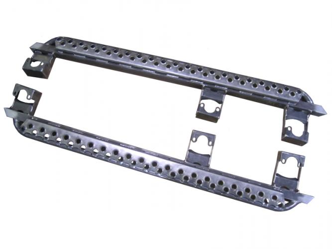

As long as we're on the subject of bumpers etc, I've also selected the side steps for the jeep. TNT off road is the next company i've contacted. I asked if they can send they side rail/step to my powder coater untreated on not coated at all. This would save a step when allowing our shop to coat these parts before their installed on the jeep.
Again, these rails would be sent to our powder coated/shop a few adjustments made and the parts powder coated the same color as the jeep.

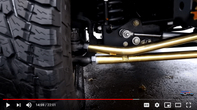

With the Metalcloak Drag link, Tie rod & Track bar just weeks away from being installed on our 017 wrangler, I've been researching video on how others have been installer systems. One case in this attached image from a video found last week. I'm having an issue with how this fellow installed the drag link, as the bend in the bar is hanging down and seems to be touching the tie rod.
According to other sites even metalcloaks site, this bar should be parable to the tie rod and inline with the left and right ball joints. So I'm hoping this fellow ended up correcting this issue or he could be hearing a clunk/knock while driving about.

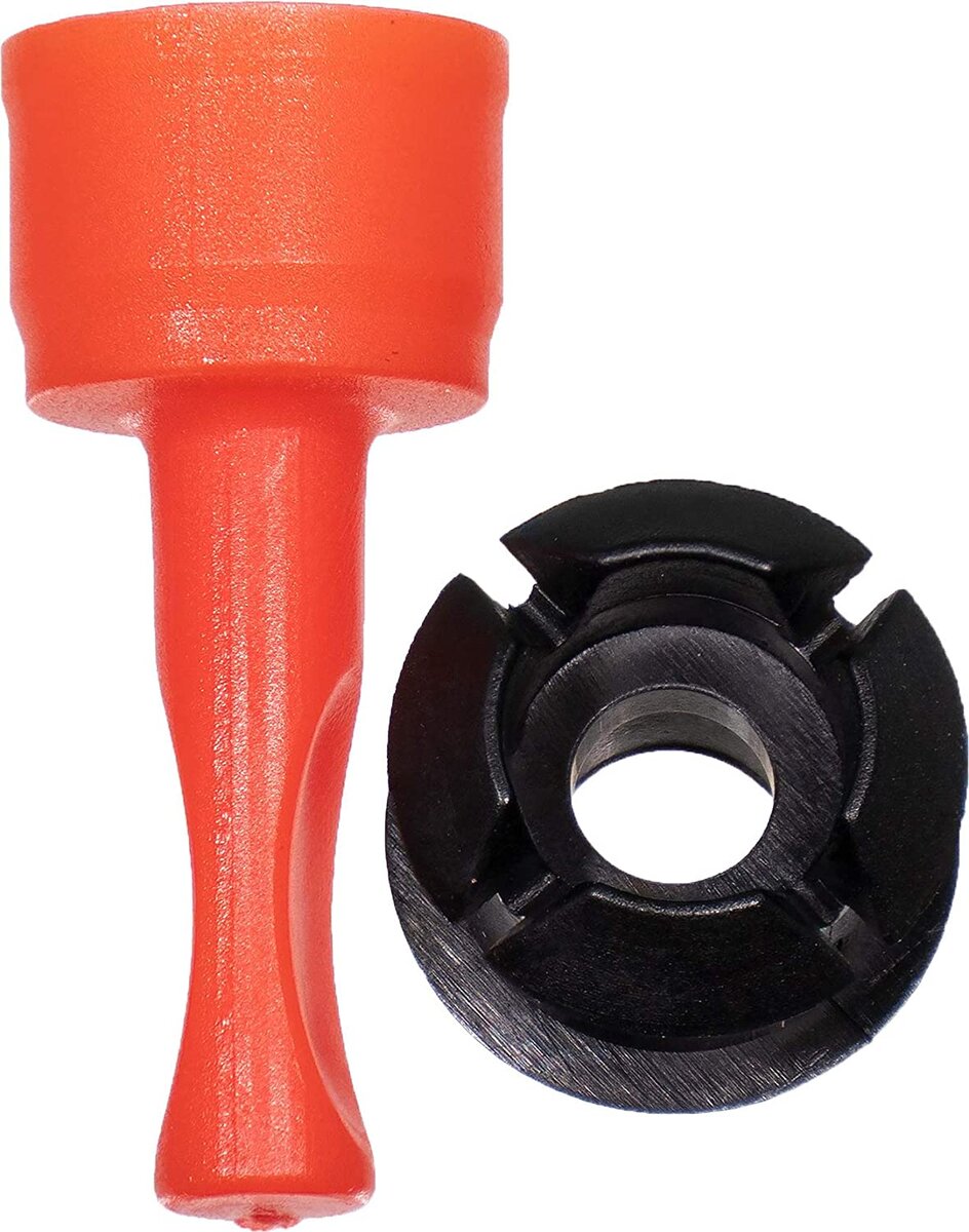

Something else thats also in the tool bag is the above part. This is a new replacement bushing for the shiftier cable as these have also been known to fall off leaving your jeep in limp mode or worse drive mode. Again just a few simply items one should think about keeping in their jeep just in case. This little plastic part coast less than $30.00 if you install it. Have the dealership install it? its going to cost you over $300.00 and they wouldn't hesitate to replacing the cable, which doesn't even need replacing.

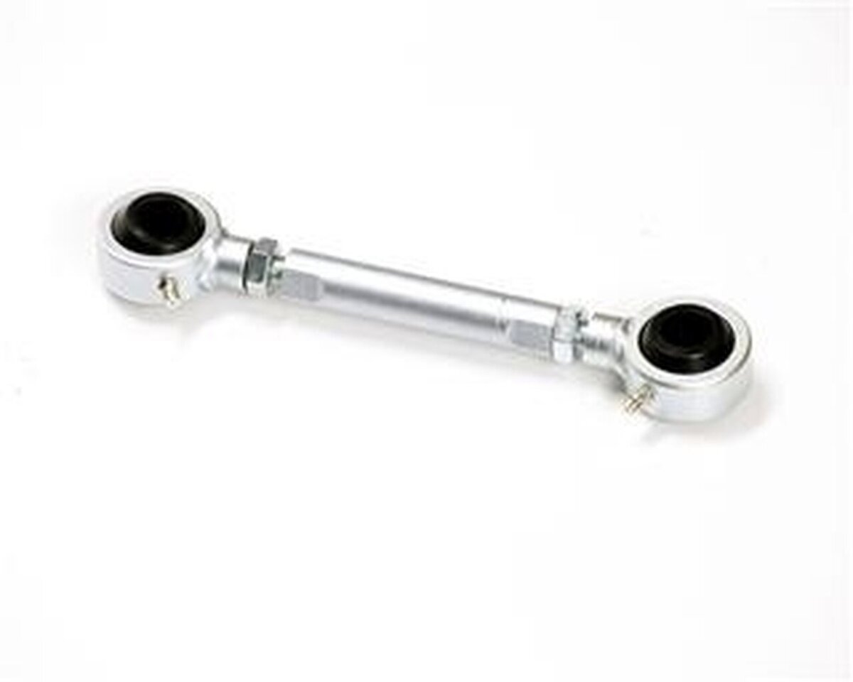

( 2 ) TeraFlex 4'' Sway Bar Center End Links for (0''-3'')

So far with all the items ordered last week, most will arrive on time within 1 or 2 weeks. Then I can get to work on adjusting the 2 sway bar end links to the correct length. I may also have to run to Tractor supply for a new set of zinc plated grade 8 bolts for the new components being installed.

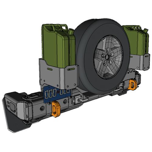

I really like the rear bumper design, make sure its going to work with your future plans (drop in camper). The side steps are pretty nice, I like them a lot.

Also, Just learn something that was important to me which I wasn't able to locate at the Teraflex site. I located this info on the Rebeloffroad site which shows that sway link can be adjusted to 6.5-8.5 inches long. Currently, our sway link is 8.5 and I would consider this to be too long. when the jeep flex over bumps in the road or offroad, these sway link ends keep hitting the frame. ideally there are perimeters for the setting of the sway links. So the factory or moog shorts are too short where as the factory or moog rear links are too long. This is all due to having a jerry rigged lift kit on the jeep.
So for the record, I informed Teraflex to deliver my sway links to either my P.O. Box or home address but use USPS. According to Teraflex spokesperson, they are going to use Fed-ex 2 day shipping and ignore my request to have the items delivered USPS. We will see how this pans out..

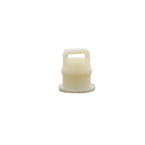

I've never seen this before. I'm familiar with the replacement (68064273AB) which is white & looks like this
And the Heavy Duty JK Cable Shifter Upgrade from Advance Adapters, but this is new. Can you share a link?
