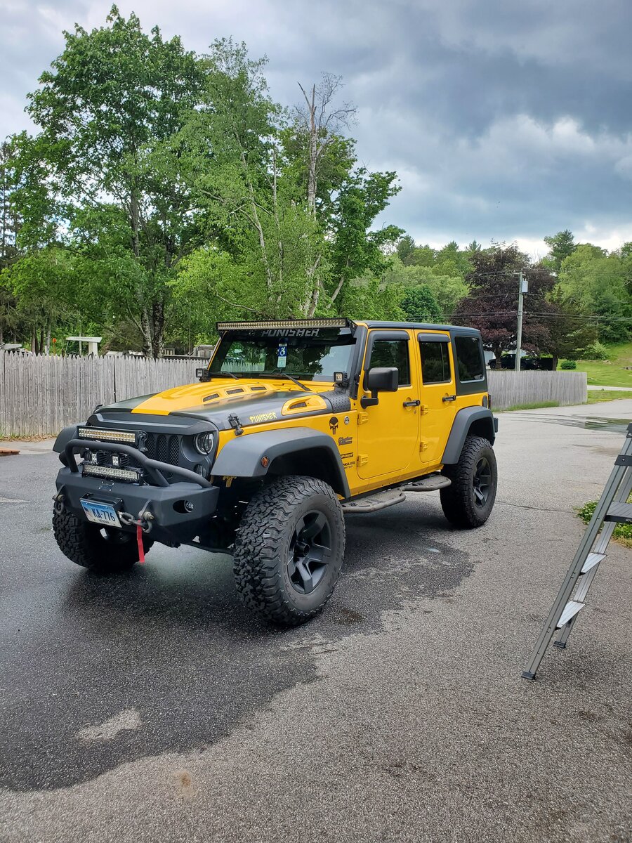

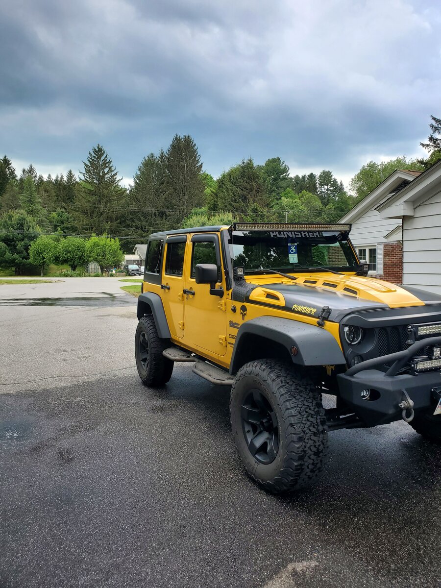

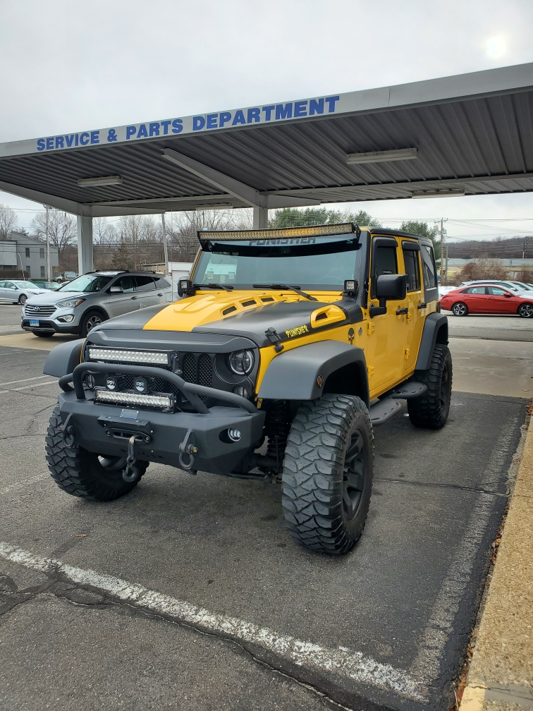

I would make sure your electric fan is going to high speed. Also did you change tire size? Before I re-geared my axles my JKU did the exact same thing. I also removed a couple LED lights that were mounted on the bumper when I bought the jeep. I feel like too much stuff up front disrupts the airflow into the radiator.

Nice ride! I did a bunch of troubleshooting. I never did get a code reported on the OBDII port. First, I replaced the engine coolant sensor. That didn't have any impact on the gauge reading high temps when downshifting up a hill. So then, I just straight up replaced the thermostat. Cost me $20 for it, and took relatively little effort. I bled the line of air, and took it for a test drive.
