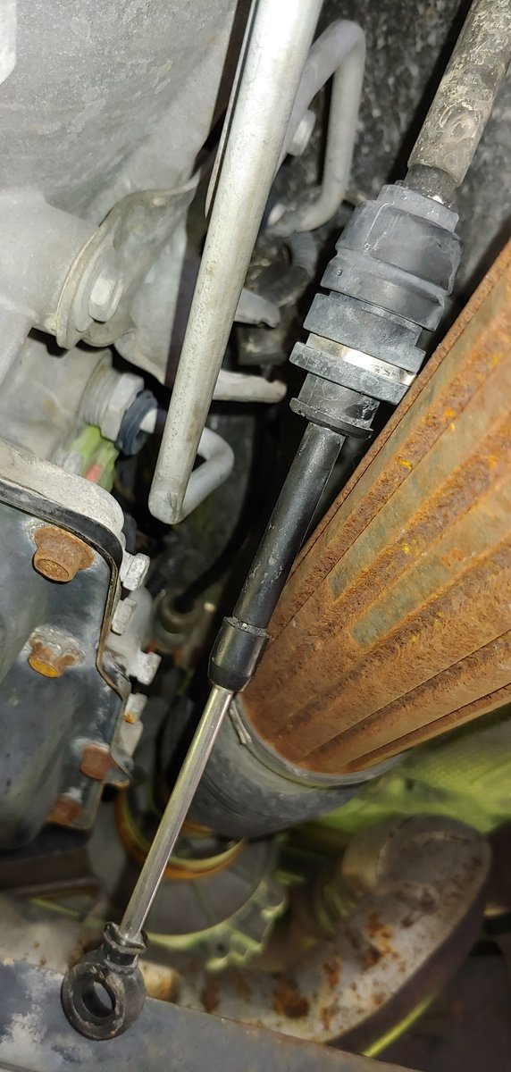

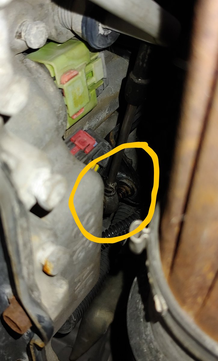

So it is the bushing, but it is the one that's under the Jeep. I was able to manually push it into Park and it now starts.
Is it the same bushing on the inside of the center console, that it is for the outside under the Jeep? I only found one part (68064273AB). Some guy who answered the phone at 4WD said it was a different part for underneath and that I should come in and have them do it. He gave me a part number that when I looked it up didn't match my vehicle (14057).
I think it's the same bushing for inside and out, but I want a second opinion before I spend more on shipping than the actual part.

Also from what I was reading it's the same bushing that's used for the T-case shifter. Let us know how it goes.
did you fix it?
Not yet, it's in such a tight area. My hands fit up in there and I can set it in place, I just can't squeeze it all the way in. A friend of mine is going to come by, hopefully his hands fit up in there.
I saw videos where the linkage was hanging down and they had better leverage. I just can't figure out how they got the linkage to hang down.

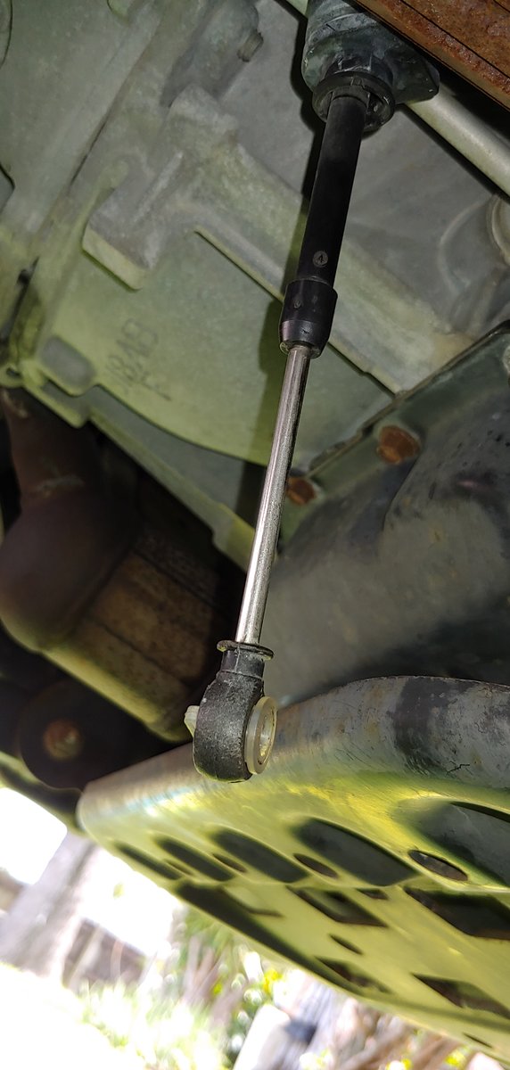

I DID IT! Thankfully for me, this happened while I was backing up in my driveway. I used the Crown Auto 68064273AB Shifter Bushing from Amazon sold by Extreme Off Road for $5.96 free shipping. People will say that it doesn't fit underneath, but it is the correct one.
I had to detach the shift linkage in order to make it hang down to get better leverage. I then used a pair of pliers to squeeze it into place. It only took about a minute to get it in with the pliers. I then reattached the shift linkage and pushed the bushing back on the shifter underneath.
