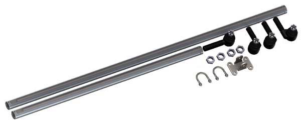

Wife's 13 JK is in need of a steering refresh. We tried a few replacement tie rod ends but the bar itself...the threads are messed up enough that I broke a Rigid pipe wrench trying to get things to move enough for a proper tape measure alignment.
There are lots of aluminum options out there. Seems like the Doetsch is favored but is very expensive.
RPM Motorsports has a version.
But I'm really leaning towards Barnes.
Price is much more affordable and I've used their stuff a lot on my TJ.
What's everyone think?
-Mac
Depends on usage I think. Use it harder and upgrade. Put around on easy dirt roads Id go OEM type replacement. Oh wait......I just realized its you. I have some 2" OD 1/2 wall pipe I can send you and some Peterbilt tie rod ends you can weld together. :p
Reactions: macleanflood
I just rebuilt the D30/D44 in my daughter's Islander and did a full suspension and steering refresh...
I went with the Moog Steering Linkage Assembly, Part# DS800982A. The kit is complete and essentially "bolt in ready". For the cost, simplicity, and OEM fit, unless you're wheeling in situations where you're beating on the steering linkage, I wouldn't hesitate to use this on a solid 35" or smaller JKU build. I live in the rust belt and her OEM steering linkage was able to be freely adjusted, as was mine (and my JKU had 209,000 miles!).
We're planning on Rubicon Trail and Moab. So I'm definitely wanting beef.
-Mac
To be clear, both of those trails have been tackled successfully, thousands of times, on MB Jeeps running 30” tires.
Heck you can rent stock Rubicon's for both of these as well. Are you lifted? Plan on trying the hardest lines? Running bigger tires? I’d argue that those are more important contributors to your decision/needs than what trails you intend to tackle.
All that said, if you’re hellbent on spending the extra $$, the F-ton steering from Fusion would be my choice.
