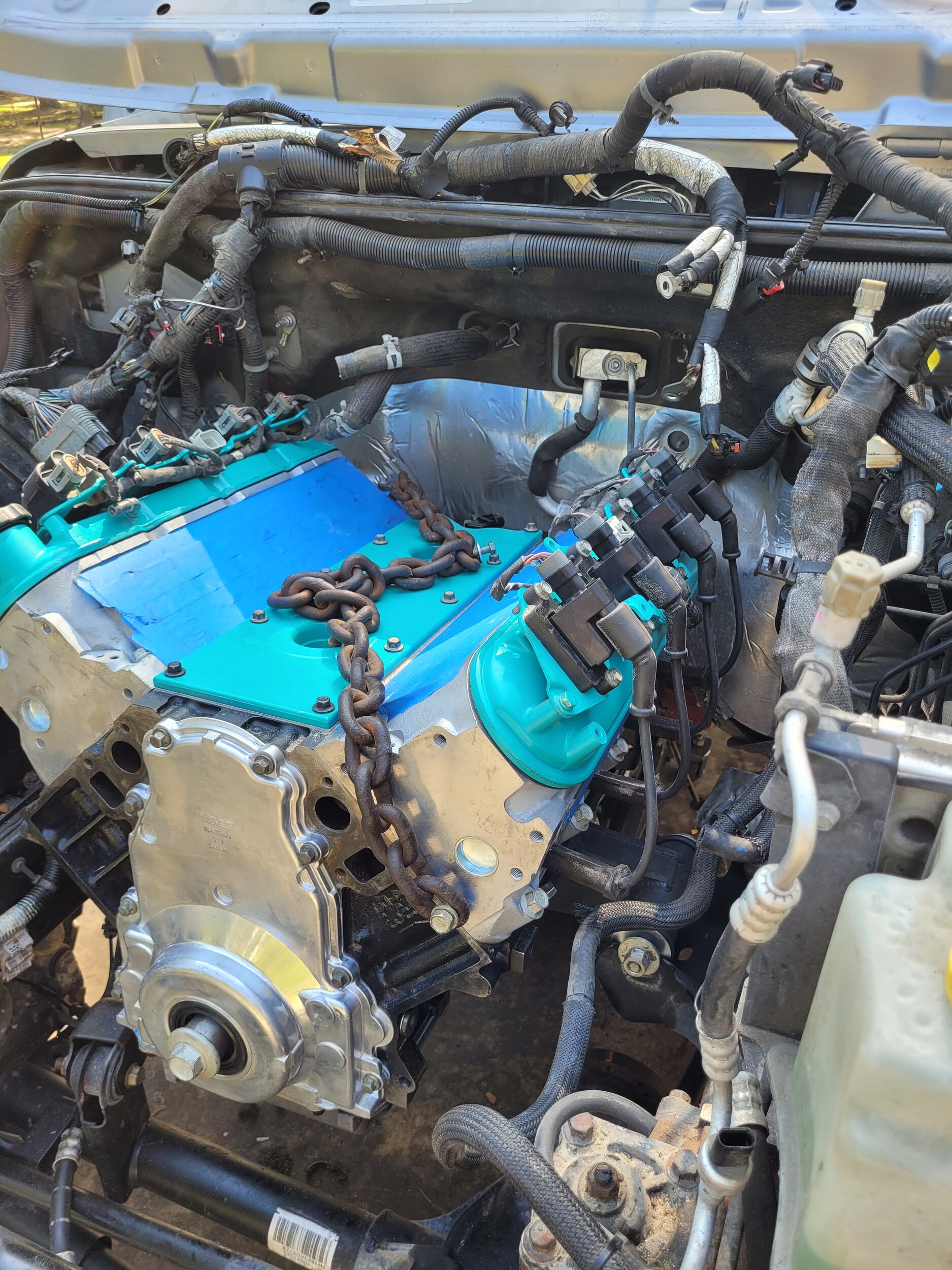

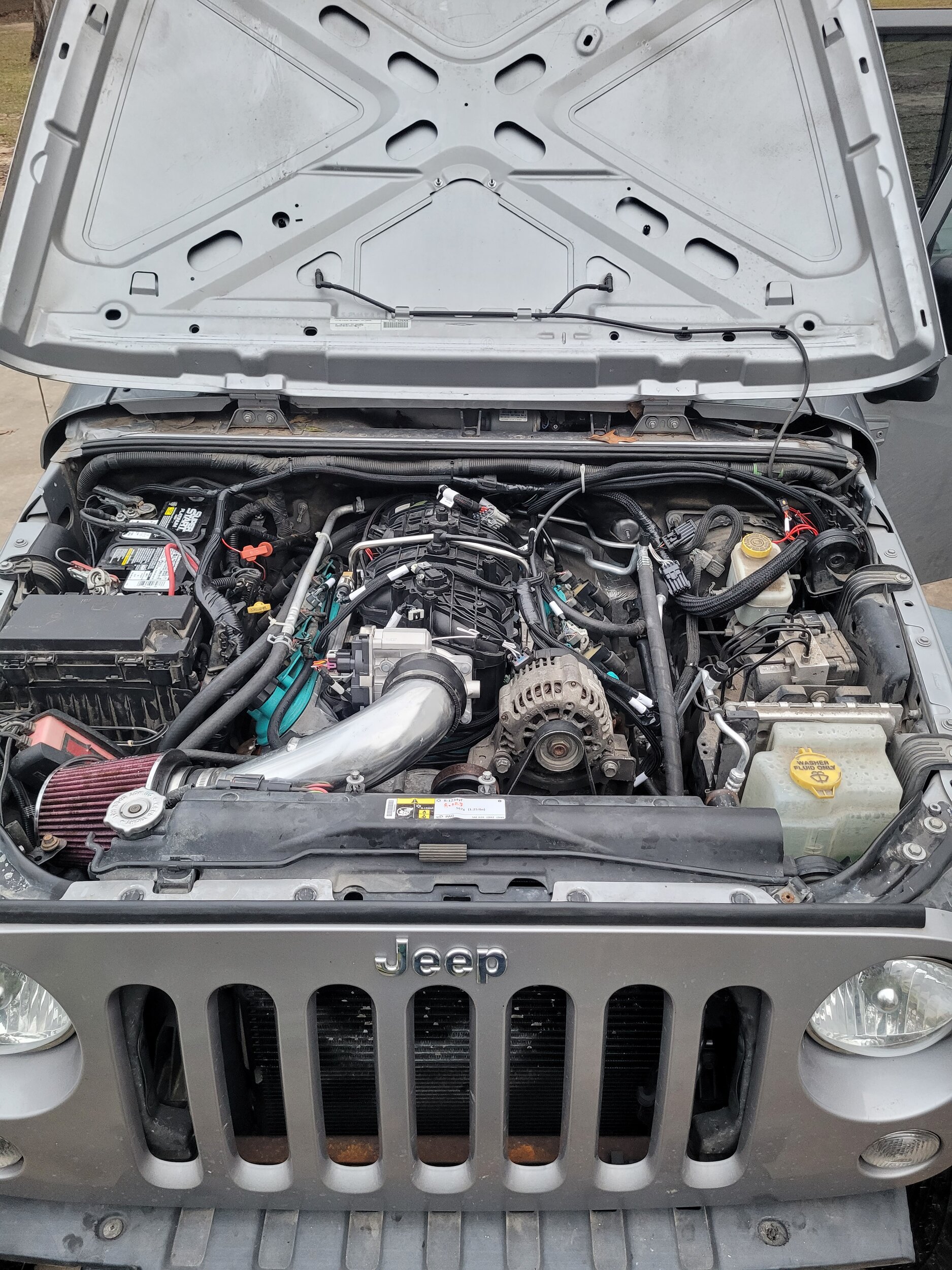

Here is a couple of pictures of my swap. One is of the initial test fitting and the other is the completed project.
