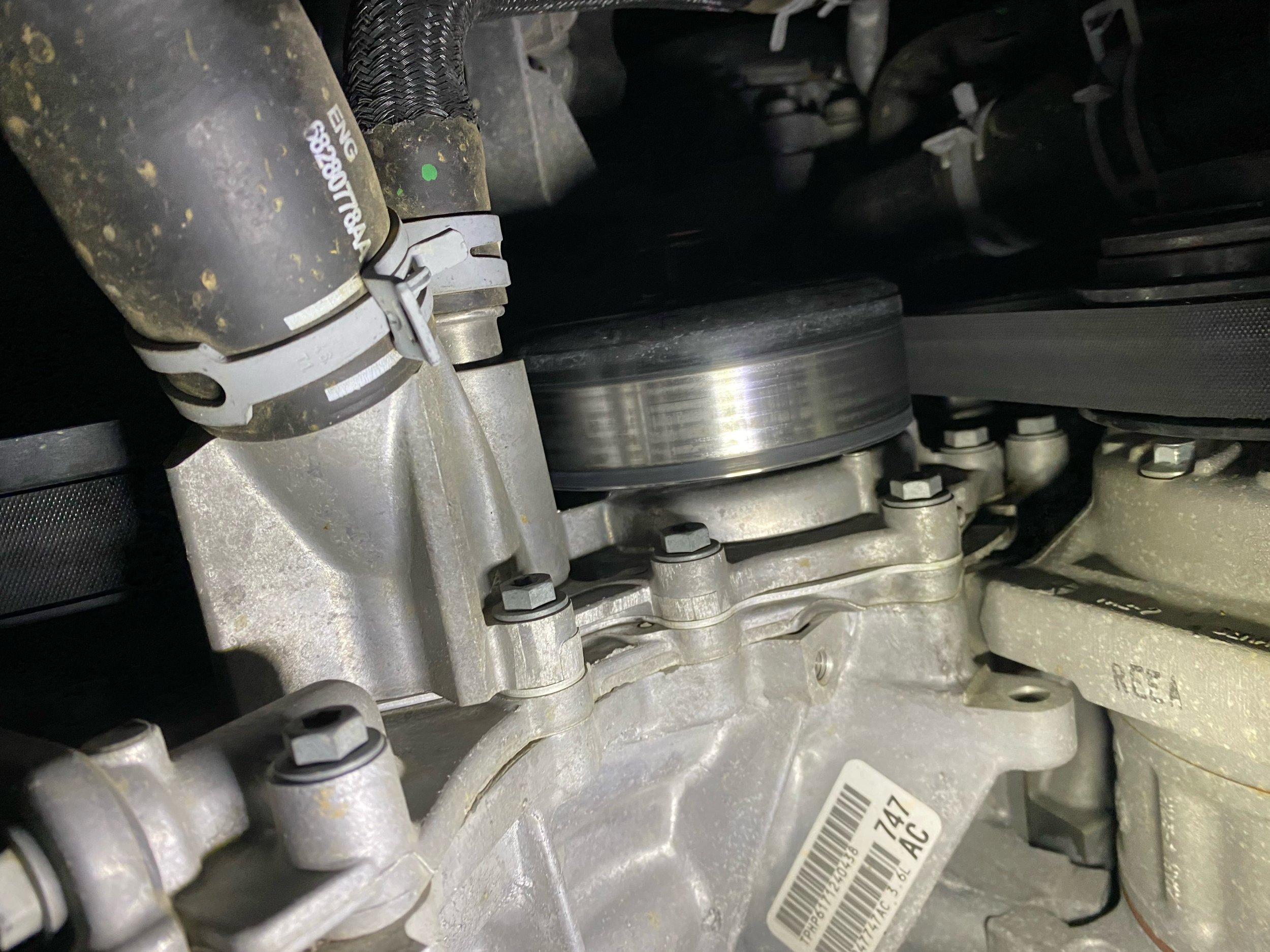

Water pump, perhaps? I may yank the belt and feel the pulley to see if there is any lateral motion detectable. I've also heard of belt alignment issues on these engines. Usually turning on the A/C would detect that, however.
