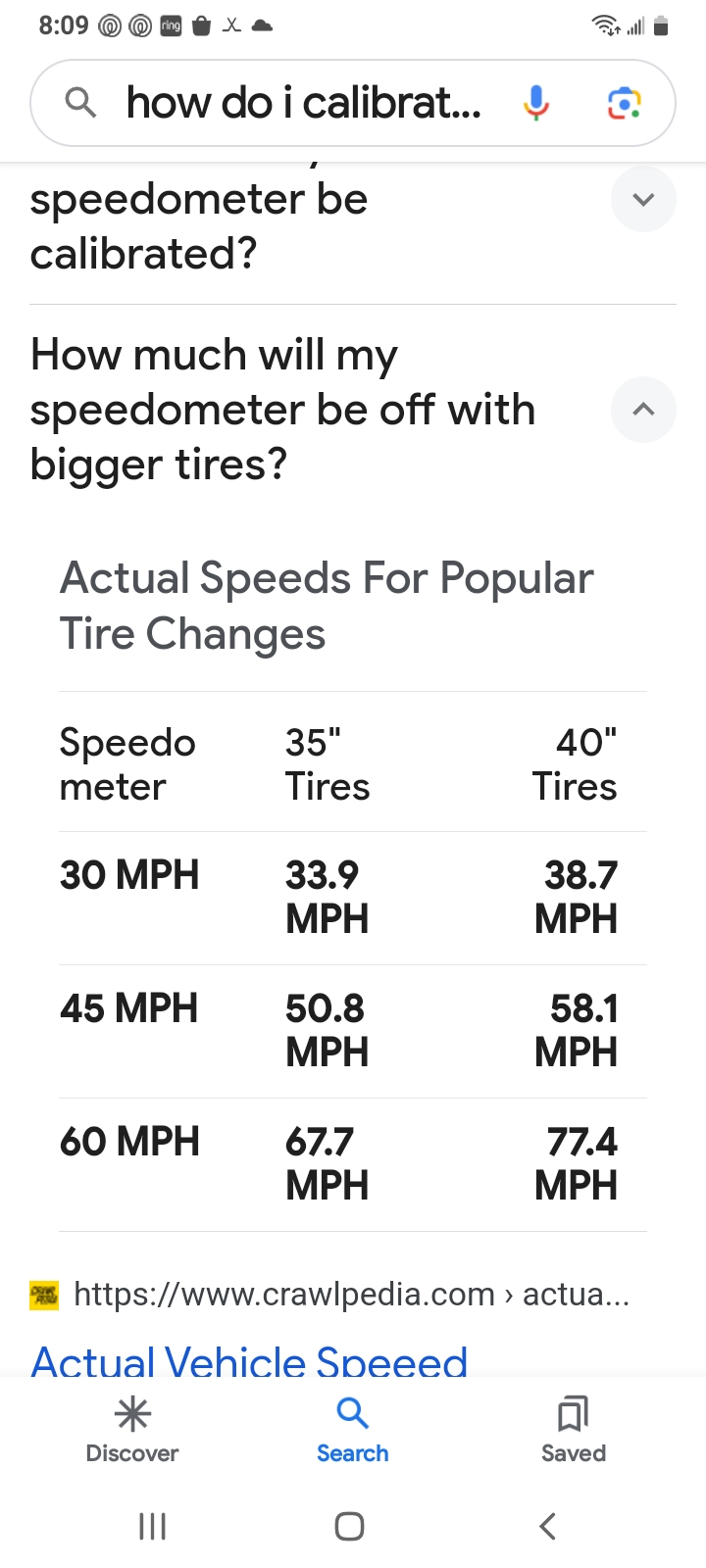

Here you go I had a better chart but this should help you
