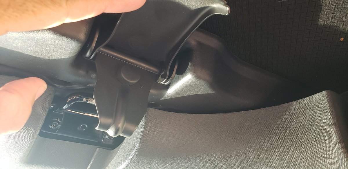

Just bought a JK for my wife and she cannot unlock the front locks for the soft top without using something to pry it open. Is there a fix or a mod that can be used to help her out?

Not that I'm aware of. Pretty sure you just have to use some force. They get easier over time, seriously.
There should be a rubber bump stop in the clamp/lock. They tend to break off allowing the clamp to go in too far for your fingers to grab it. Make sure they are still there. Quadratec sells them for pretty cheap.

I will check it out, I'm sure they are gone since the clamp is flush. I've bent the prongs on a old fork and that work pretty well floor them.
