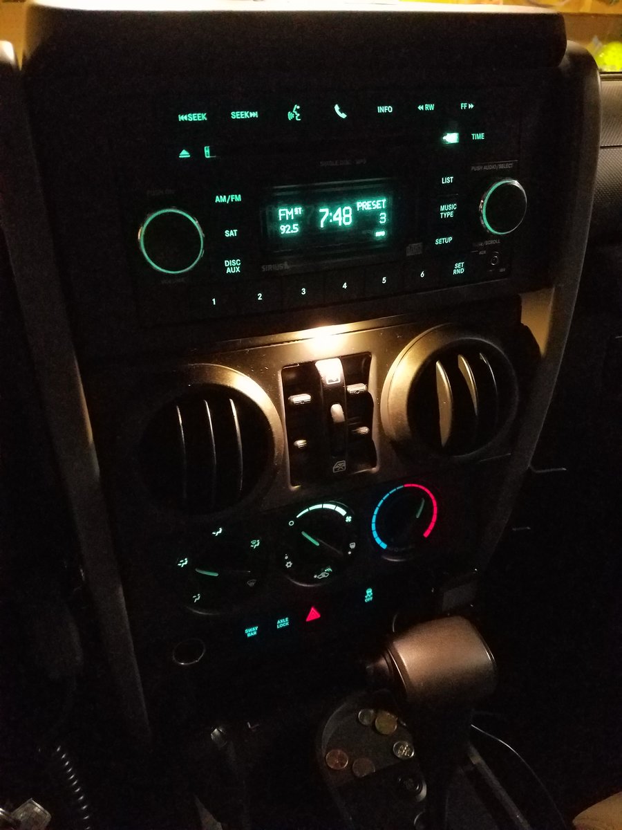

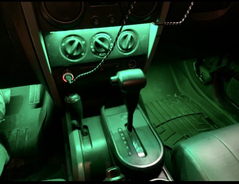

Our problem was the window buttons. We couldn't see them at night so I added a single LED from Amazon. It lights up the shifters and cup holders too.

I had wondered the same thing about my used JKU '07. Figured it was a bulb or a short/dirty contact. Smacked straight down on the shift lever with an open palm. Shazam! Got lights now. Love a cheap fix.

How did you add the led?
I'd love a dim purple led, something not so bright. But I don't see anywhere to add it.
Mines a 2016.
I just bought a flush mount 12v LED from Amazon. Removed the bezel and drilled a small hole, then just spliced the led wires in with the other dash light wires.
