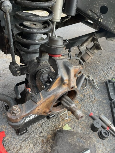

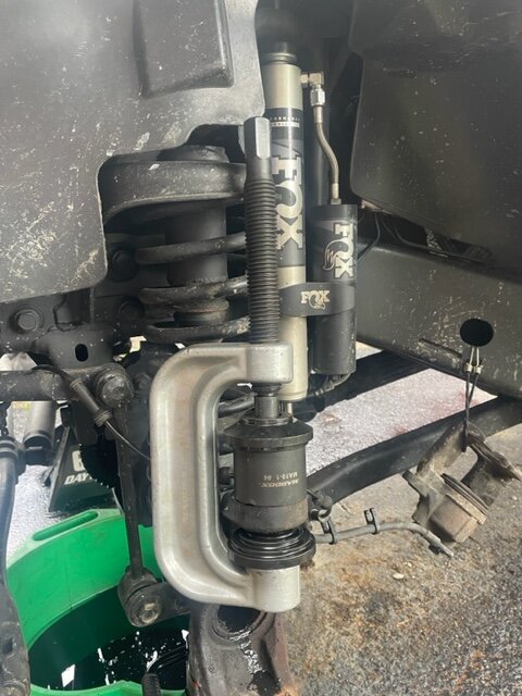

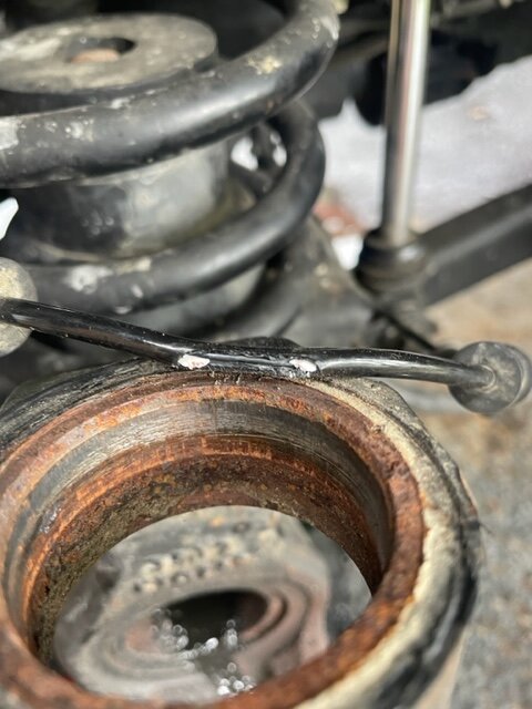

Tore everything down Saturday and was expecting that my new ball joints would arrive that day. They were delayed (not sure why), so I ended up doing a few extra items. There are a few lessons that I learned along the way: 1. ABS sensors and ball joint presses don't get along. 2. ABS sensors do NOT fit through the dust plate with the hub installed completely. Well, they do, but you can't install them into the hole without seriously torquing the line itself and I didn't want to break it.

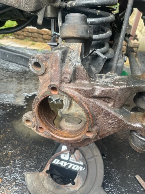

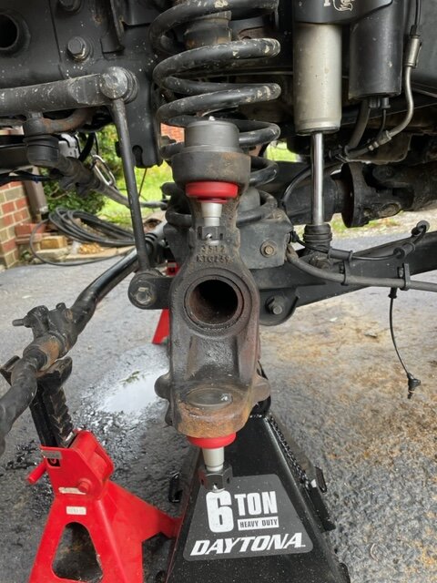

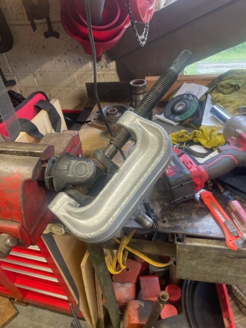

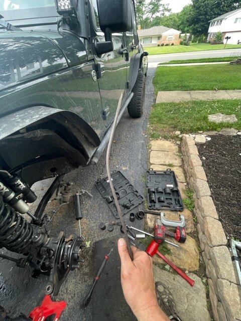

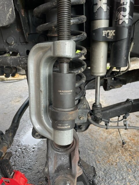

So, I worked both sides at once, rather than do one at a time. Seemed to be a bit more efficient for me to do it that way. So, jack up, jack stands, pull wheels and brakes, pull unit bearing, pull axle shafts, pull knuckle, remove ball joints. I had the Harbor Freight standard issue ball joint press with accessories, but for the Jeep, I needed the extra set. 25% July 4th coupon here I come! Cleaned everything up and painted most things. I didn't paint the knuckles just because I didn't want to take the time to tape all the surfaces. About everything else got some paint. Pulled the axle cover and inspected the gears, all good, no chunks but did have some fuzz on the drain plug. Nothing to worry about. My guess is this is the first time that the lube has been changed. It was awful dark. Went back with a gasket and I always use the black RTV as well. I probably could have gotten away with copper spray or no gasket at all, but I like the combo. I haven't had one leak that way. Since the ball joint shipment was delayed, I went ahead and started the axle shaft u-joints. I had ordered the Spicer 5-760X and they turned out to be the wrong size. Too small. I had found those digging through forum posts. I looked at the ones I had and found the casting number and that turned out to be a Spicer 5-7166X (Casting Number SPR 1411). Oreilly up the road from me had one, and they help one at another store that was a 15 minute drive. No big deal, I'll just go pick it up. Wrong, the guy at the counter transferred it to another store another 20 minutes away instead of holding it. Ugh. Lots of driving later, I had both. Ball joint press makes quick work of u-joints, but since the head of the joint is larger than the press, you have to be careful when they are stuck. I ended up driving right through one that was seized and it blew up. crap went everywhere, including a small shard of metal right into my finger. Not to be deterred, I pulled it out and went on. Unfortunately, the "ring" was still in the yolk. I tried a regular punch to work it out and that didn't work. I also have an arbor shaft out of an alternator that I use as a punch. It works really well and is a solid piece of metal. I tried a dremel and a hacksaw blade, but they didn't want to touch the hardened steel interior ring of the old cap. Took a bit, but I got it out without having to heat it. New ones went in without much of a hitch. I painted the ends of the shafts after a little work with some emery cloth where they had rusted. After that, I decided to go ahead and change the transfer case fluid. I pulled the skid plate and noticed a bit of rust on that, so I hit it with a wire wheel and painted the top side. Pulled the transfer case plug and drained that as well. I wish new process had put a magnet on the drain plug on these instead of putting a magnet inside the case. By the time I had all that done, it was beer 30 and time for dinner.
Next day, the delivery still showed delayed, and I had to get the tow bar from the coach so I could swap the ends out to fit Demco base plate. Ran down to the coach and grabbed that and by the time I got back, the ball joints had arrived. Got all the tools back out and ready to go. The ball joints were pretty easy to get out because the orientation of the press was good enough to use a long breaker bar and cheater pipe to get them going. Unfortunately, going back in, I had to flip the press over to get the right attachments in in such a way that the press throat was long enough to get in place. That meant that the bottom ball joints had to be pressed in using a wrench only. That made for a hard and slow process. Tops were pretty easy. Once those were in, I put the first axle shaft in, got it all the way in, and realized that I needed to put the knuckle on first. Back out with the shaft, knuckle on, shaft back in. From there, I installed the unit bearing, nut, and bolts holding it in. At this point, I realized that the ABS sensor would fit through the hole, but wouldn't install in the hole. Loosened the 3 bolts holding the unit bearing in enough to get it in there and retightened it all back up. Brake install went easy, wheel back on. The only other problem I had to deal with was the ABS line I mucked up with the ball joint press. The connection is behind the shock tower and is a bit of a pain to get to. In the end, I had to swap both of the ABS sensors. I think that I damaged the passenger side one when installing it.

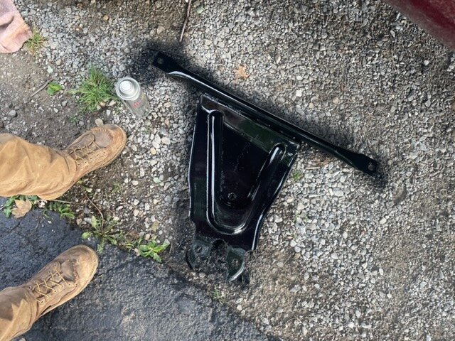

All fluids back in, skid plate reinstalled over transfer case and painted the underside, off to the alignment shop. The called 10 minutes after and said the toe bar was seized. They managed to get it loose with heat but he said I should consider getting a new one next time. When that happens, I'll probably pull it, mark and measure the location, pull it apart and clean it up and use anti-seize on it. I love that stuff! I used it on various bolts and on the unit bearings when putting everything back together.
Next up is a transmission fluid/filter change and the rear diff lube. Hopefully I can fully test the flat tow soon behind the motorhome and make sure all that works as intended. Alignment was a success and the Jeep drives much better than it did. I had some wheel shimmy around 40-45mph that's not there any more, which is nice. On to the pics!

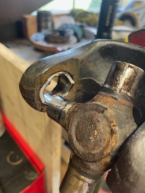

Well, I figured out what the weird, intermittent noise was while out west on vacation. Flat towed the Jeep from Cincinnati to Teton and then Glacier and back over the last two weeks. We were driving up Going to the Sun Road in Glacier and the noise came back full force. Sounded like a cross between a crunchy bearing and a rock in a metal hubcap bouncing around. And didn't happen all the time. It also didn't change tempo with speed or stop under braking conditions. Didn't seem to be affected by engine speed or vehicle speed. It was making me crazy!
On the trip back from East to West Glacier, it occurred to me that I should check the front driveshaft. I had already wiggled it and it seemed pretty tight. No play that I could tell, certainly not in the u-joint. I decided to remove it completely to rule it out. Once I pulled it out, I realized that the CV joint a the transfer case is torched. Boot must have come off at some point prior to my ownership and the joint was toast. Inside all mangled and parts missing. So, I'll need to replace it. I've done a bit of research and there's all sorts of options out there. I think I've settled on the Terraflex Rzeppa high angle factory replacement kit. Seems like a pretty straightforward install as well. Anyone else have opinions on this? My application is really a daily with some minor offroading and not likely to do any real rock crawling. Not any crazy mud either. As always, thanks in advance for the advice!
Finally got the front driveshaft back in and my first oil change since owning the Jeep. Oil change went really easy. No major issues. I did go with Mobil 1 oil and filter. For whatever reason, I prefer Mobil 1 oil and use it in the gas cars. Mobil Delvac 1500 Super in the diesels. I did confirm on the packaging that it conforms to the manufacturer recommended MS-6395. 6 quarts out, 6 back in. Easy.
On to the driveshaft. Firstly, I should have chased the holes in the flange on the transfer case with a tap. I didn't, and I paid for it. Second, I didn't think to break out the ball end 3/8" drive allen stocks I have sitting right in the toolbox. Bonehead moves for sure.
I basically set the driveshaft in place, rested the front portion on a jack stand at a height that I could easily get to the bolts (flat), and eased each one in. The Rzeppa joint is a good one for sure. The problem is, the bolts are pretty tight in there and there's not a lot of room to get even a regular length (short) allen socket in there. They rub on the flange. Dumb.
Once I got one bolt started, I basically just went around and tightened each one a little at a time until the joint was fully seated in the flange. From there, I grabbed my torque wrench. Unfortunately, I couldn't get it to break over and felt that I was overtightening the bolts. So I stopped and left it as is. I'll go back after a few days of driving and make sure all is still tight. For now, no noise or vibration, so I'm calling it good. That same torque wrench worked just fine for the oil filter cap, so who knows.

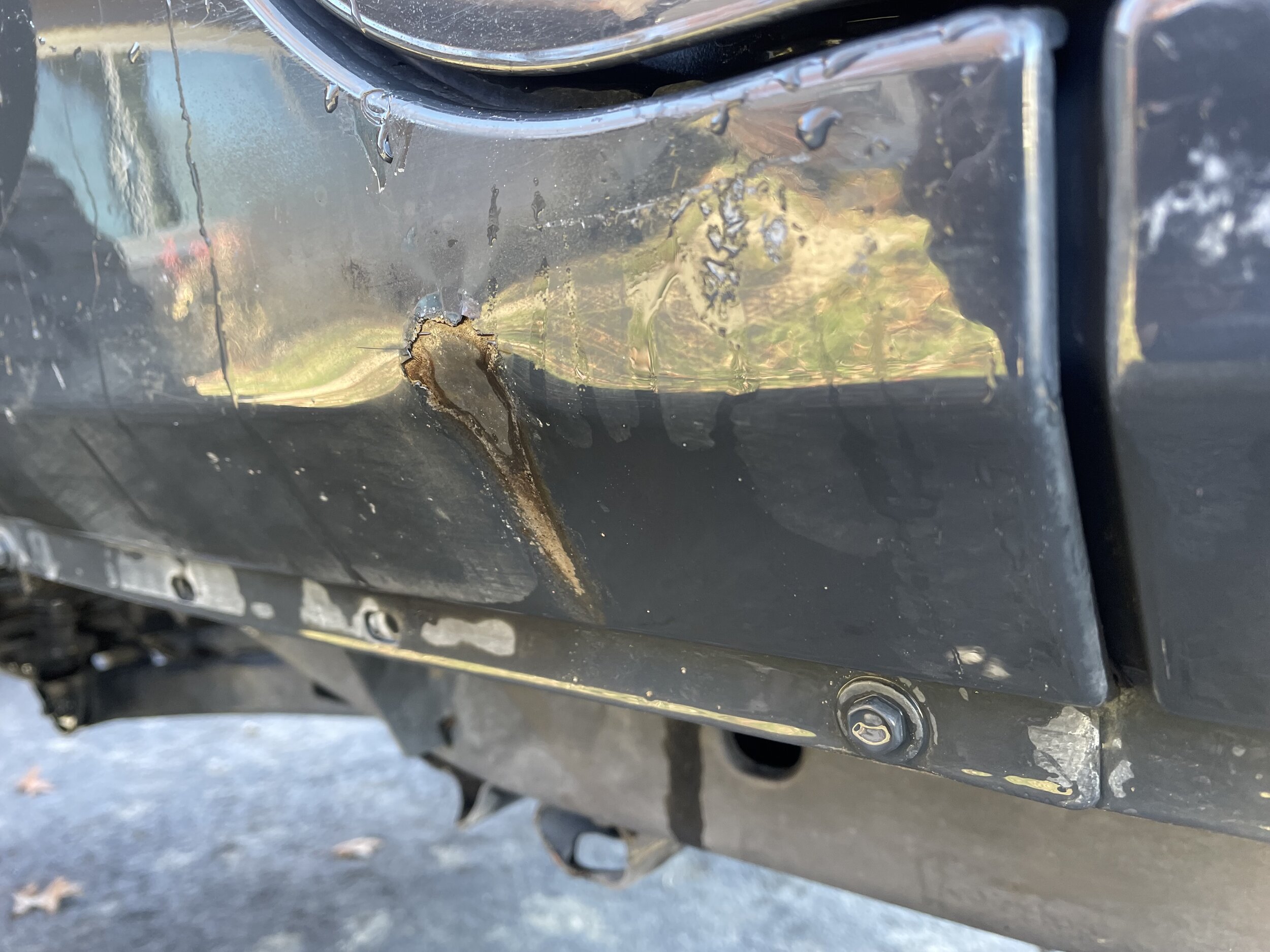

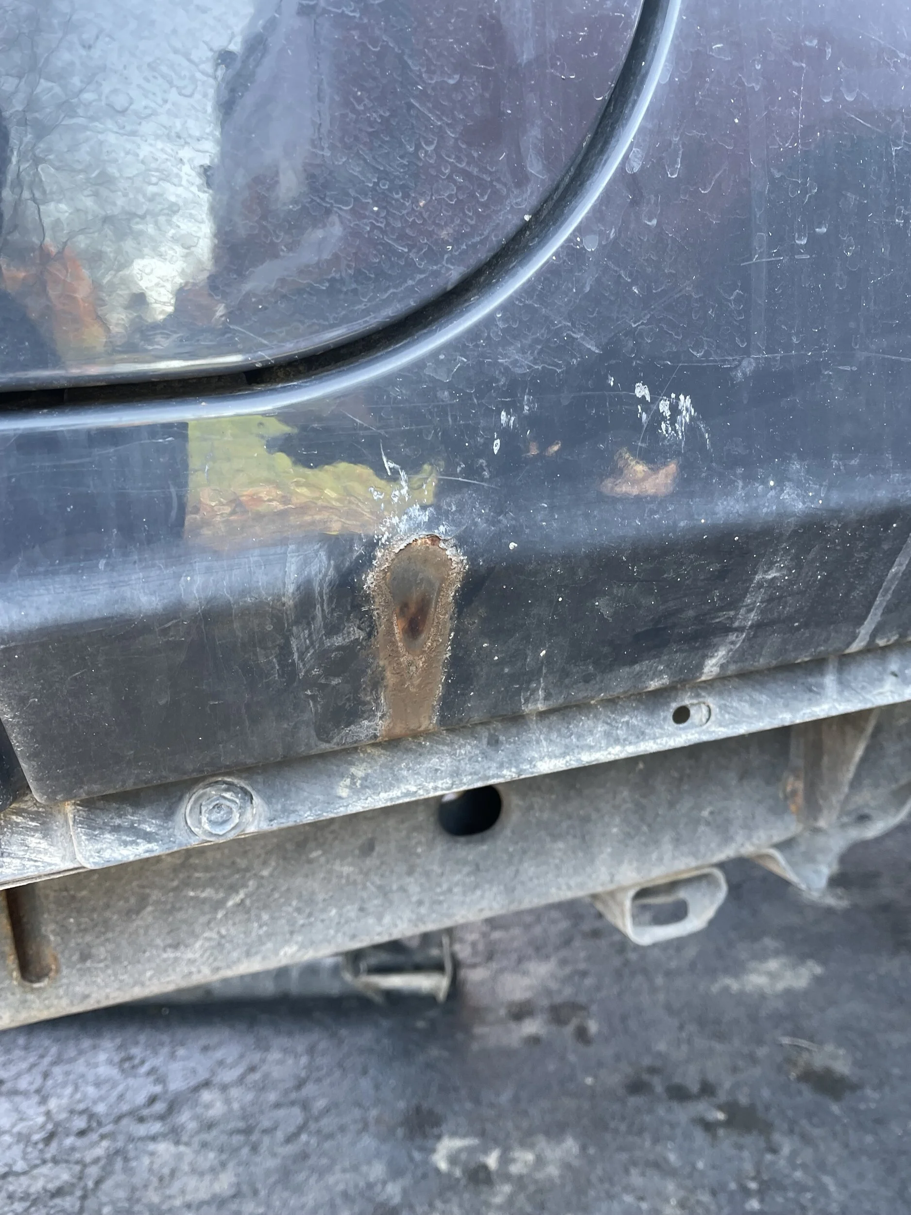

But, before all that, I took it to the local car wash and washed real good including underneath. Got it home and used some of the chemical guys ceramic wax. It’s a little chunky but otherwise went on pretty easy. Wiped it off and the paint looks pretty darn good. It’ll need a clay bar next year and I have some additional work to do. Namely, the area where the rock sliders were installed. I didn’t realize when we were out in the badlands, and the mud was getting everywhere, including on top of the rock sliders/steps. Tiny rocks were wedged in there. With running around town, the tiny rocks created deep scratches in the paint. Also, whoever installed them put them a little too close as there’s some rust staining and paint rubbed off. I removed them and they won’t be going back on. I’ll find a set that mount more flush to the body and don’t have anything sticking out to catch mud and rocks. Also, I’ll have to come up with a way to cover up the scratches or otherwise repair them. Right now I’m thinking I’ll sand them down and use bed liner across the bottom right up to the door bottoms. I’ll have to think on that a bit more. I’m also up for suggestions.

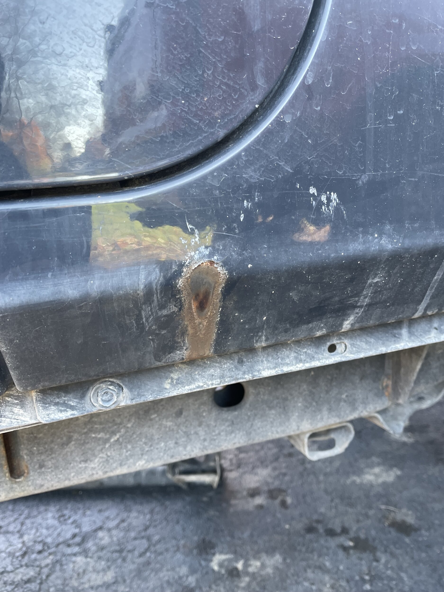

This past weekend, I needed to winterize the coach as we're getting closer to freezing/cold temperatures here in Ohio. I also wanted to get the Jeep "undercoated" in anticipation of the salt they like to spread around here. I had purchased 6 cans of woolwax a while back with the trigger gun and the tube to snake into the cavities. I ended up using all but a small amount of the last can and was able to cover the frame inside and out, all suspension parts, and the bottom of the body. Pretty happy with that coverage, even if it only lasts the winter. I'm pretty convinced that I managed to get all of the nooks and crannies and inside of all of the various parts. I then put it to an immediate torture test as it was raining when I finished and I needed to get back down to the coach to grab a few things. Overall, very happy with it so far. I'll keep an eye on it as winter really sets in. As much as I love snow, I really hate the salt that comes along with it. And I plan to keep this Jeep a good long time, so I want it to last.

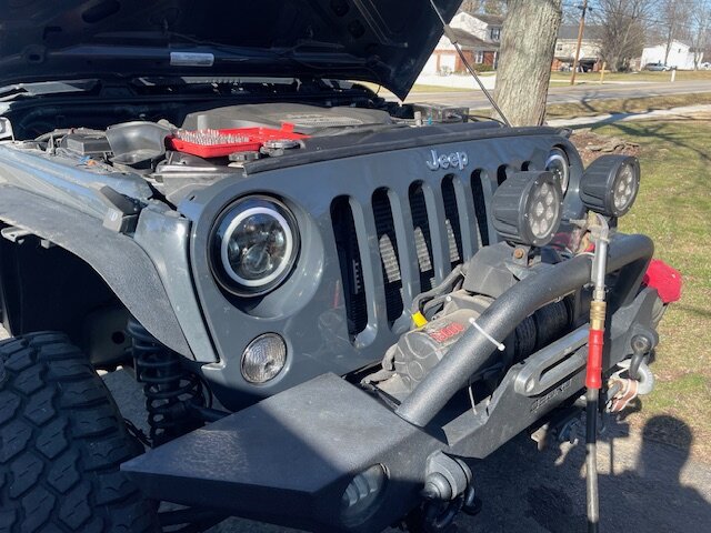

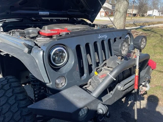

Finally got a bit of cosmetic work done that I was itching to do. Last week I found a stock JK grille in the same Rhino color my Jeep is. And, the guy was local to me so I didn't have to have it shipped (eBay). I'll take it!
Overall went fine except the stupid push lock clips. Even being careful with them, I broke 3 getting them out. Autozone had them so I picked a few extra up.

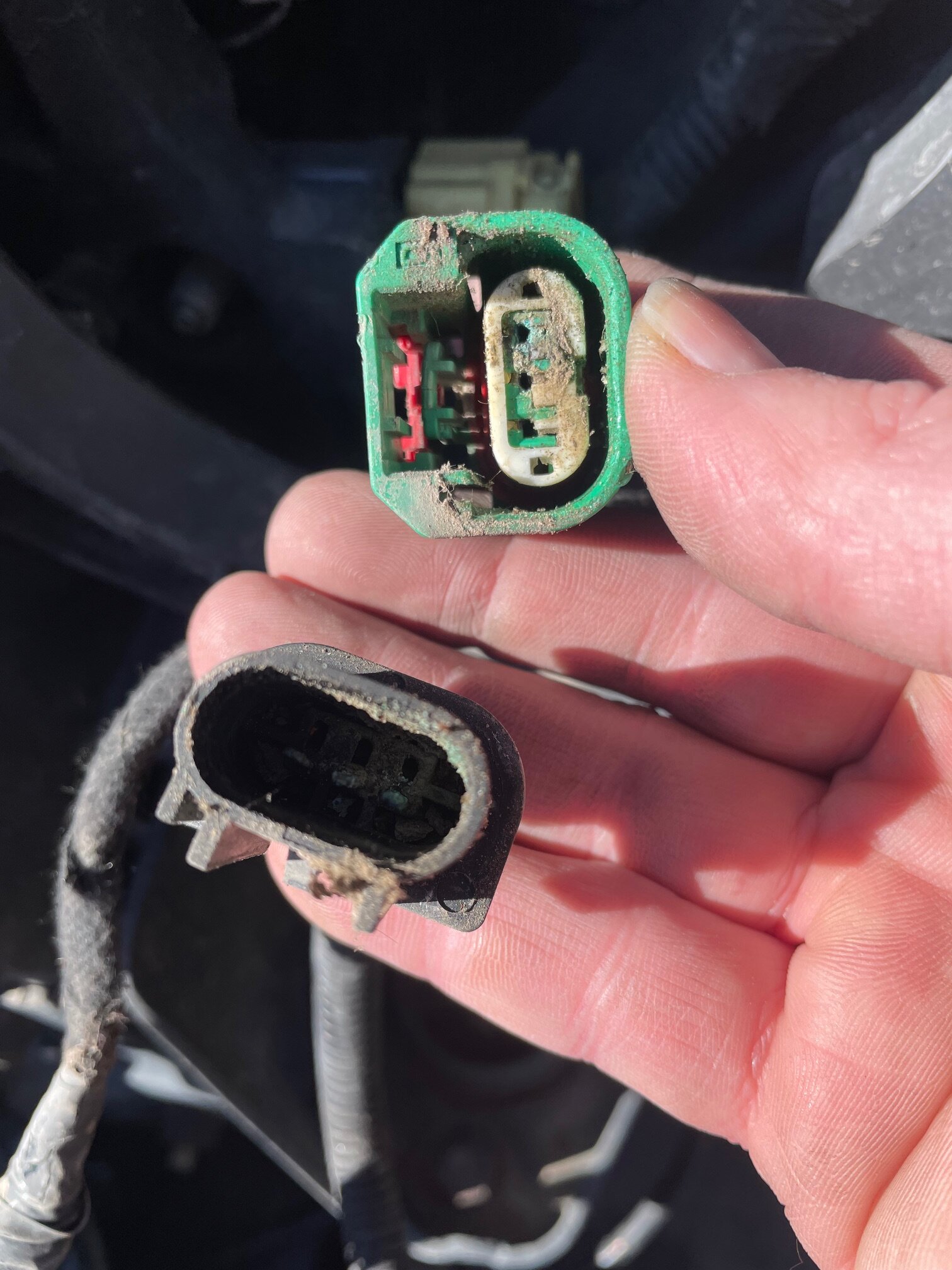

The other thing I've been having issues with have been the driver side headlight and turn signal. These headlights are some aftermarket jobs that are green halos and what I assume are LED headlights. Couple of things. One, I don't like the green. It doesn't even match the paint color. I was told by someone that the headlights might have a QR code to scan with my phone and change the color. No dice on that. So, I'll be looking for new lights (maybe even OEM) in the near future. Second problem is, they only have one adjusting screw (which was covered up by the previous grille). So, they are out of adjustment as well and I'm not sure one direction will get me there. That's another project for another day. So, I figured I'd tear the wiring apart while I was in there and see if anything was going on with my intermittent inop lights/turn signal. Sure was, dirt and corroded pins. Got those cleaned up and I haven't had any issues since. Got the front all put back together and I REALLY like the stock grille over the aftermarket "angry turtle". To each their own, but the color matched grille really does it for me.
Then I thought, why not see why my apple car play won't work half the time. It has an aftermarket Sony, which should be a reasonably decent stereo. The PO put dash mounted USB's in where the cigarette lighter should be, which I like. So, after a bit of research on the stereo model, I read that this particular one does not like additional USB cords plugged in. Pulled the dash apart, and low and behold there's a MESS of wires, one of which is an extension from the stereo down to the USB plug. Pulled that, fired it up, plugged in using the iPhone cord and Viola!! Worked perfectly. Then I really started digging and the were several more wired connected to the USB hub. They had run a cigarette lighter port off of the factory wires (at least they soldered them before using half a roll of tape) and the plugged in some adapter for a radar detector or something up to the windshield. Ripped all that out, and installed a regular charging USB port in place of the previous one. I think I pulled 5 pounds of wires out of the dang dash.
I waffled back and forth on running the stereo factory attached USB cord and where to put it. At some point, I'm going to go to one of those bulletpoint mounting solutions phone mounts that tie into the top of the dash, so I didn't really want the regular phone cord hanging around. However, running it down behind the dash was eluding me and I needed to finish up to move on to another project. So, since my cubby that would normally be where the window switches are already had a hole in it, I drilled the back to feed the USB through. For now, this will work until I get a permanent mounting solution for the phone.
One thing I will look at adding is some sort of screen behind the grille as it's wide open. Especially with flat towing it behind the coach, I don't need an errant rock flying up there and damaging something. Not likely, but I'd rather not have to worry about it. There's enough going on while out on a trip and I don't need one more thing.

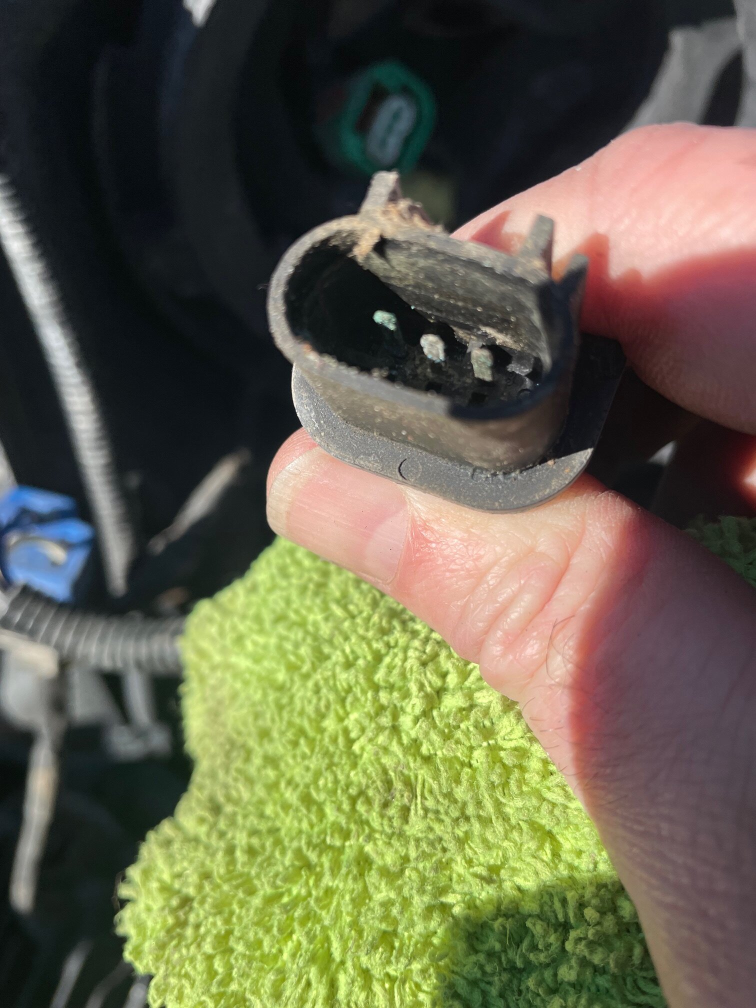

Obviously, this amount of dirt will make things not work....
Corrosion came out pretty easy with a few sprays of contact cleaner and some light scrubbing with emery cloth.

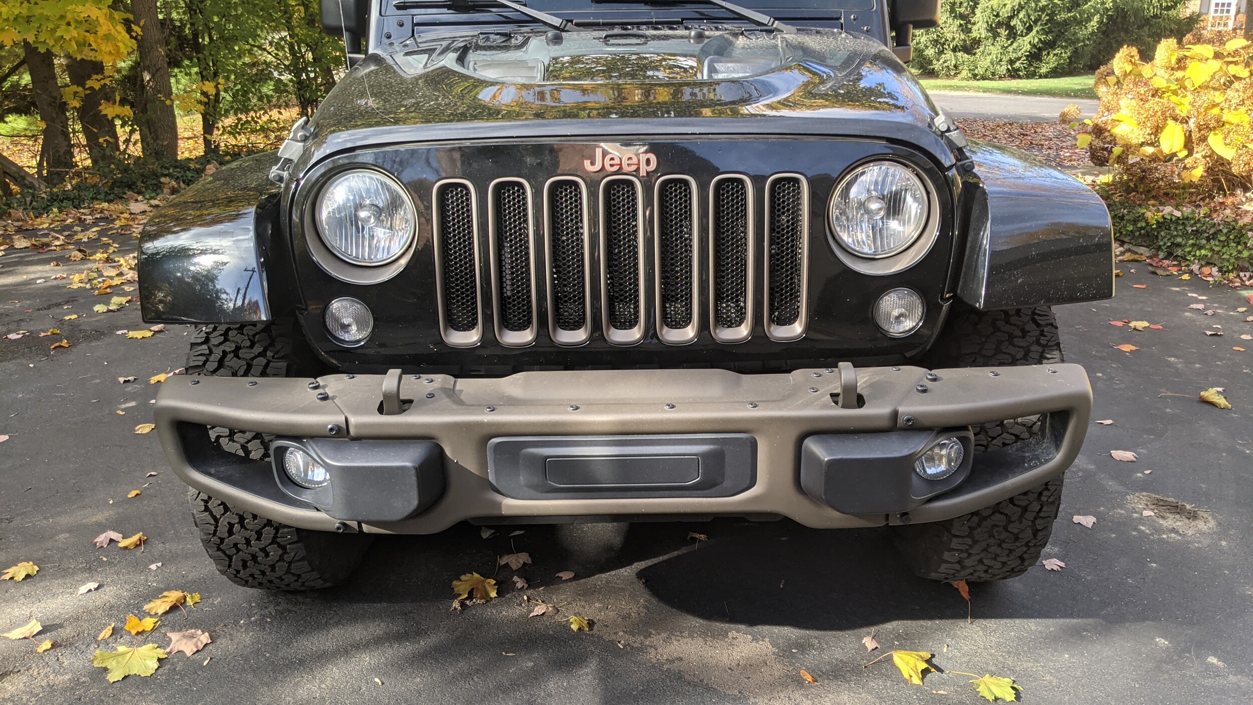

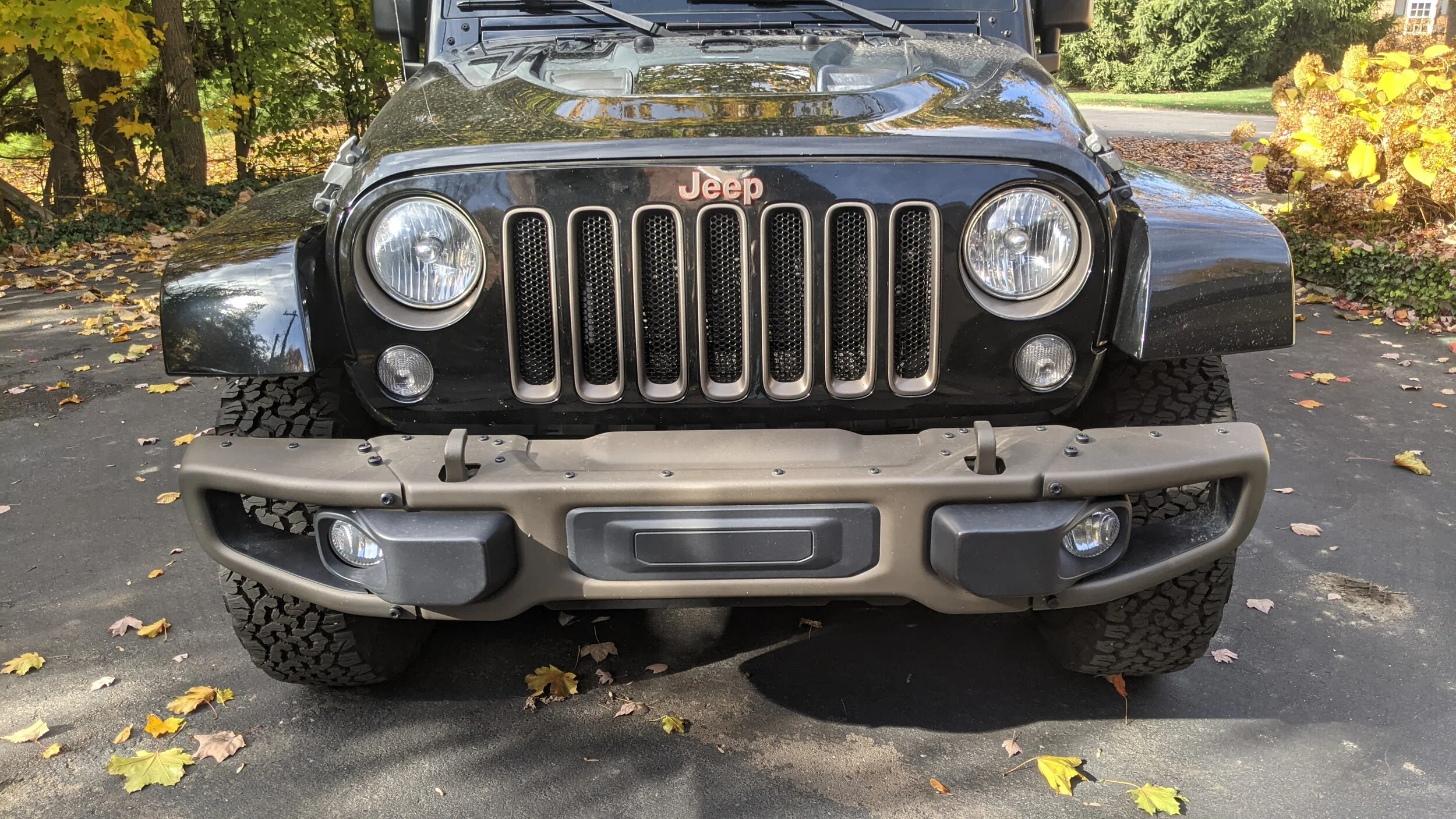

Looks great with that grille. I also didn't like the open aspect and installed a screen. Both for protection and I like the aesthetics better:
