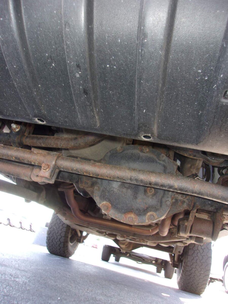

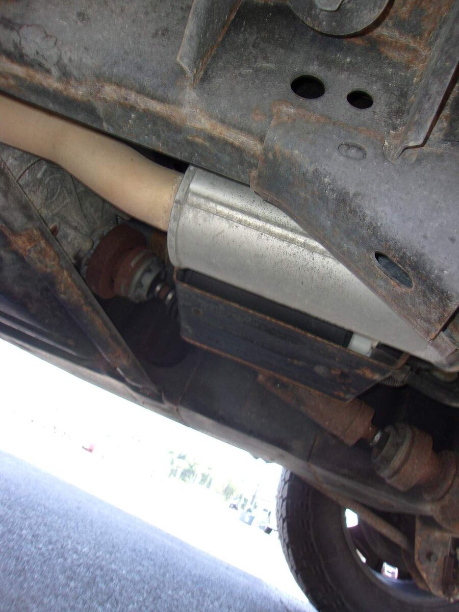

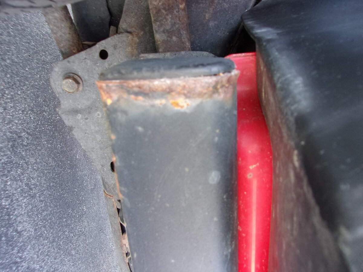

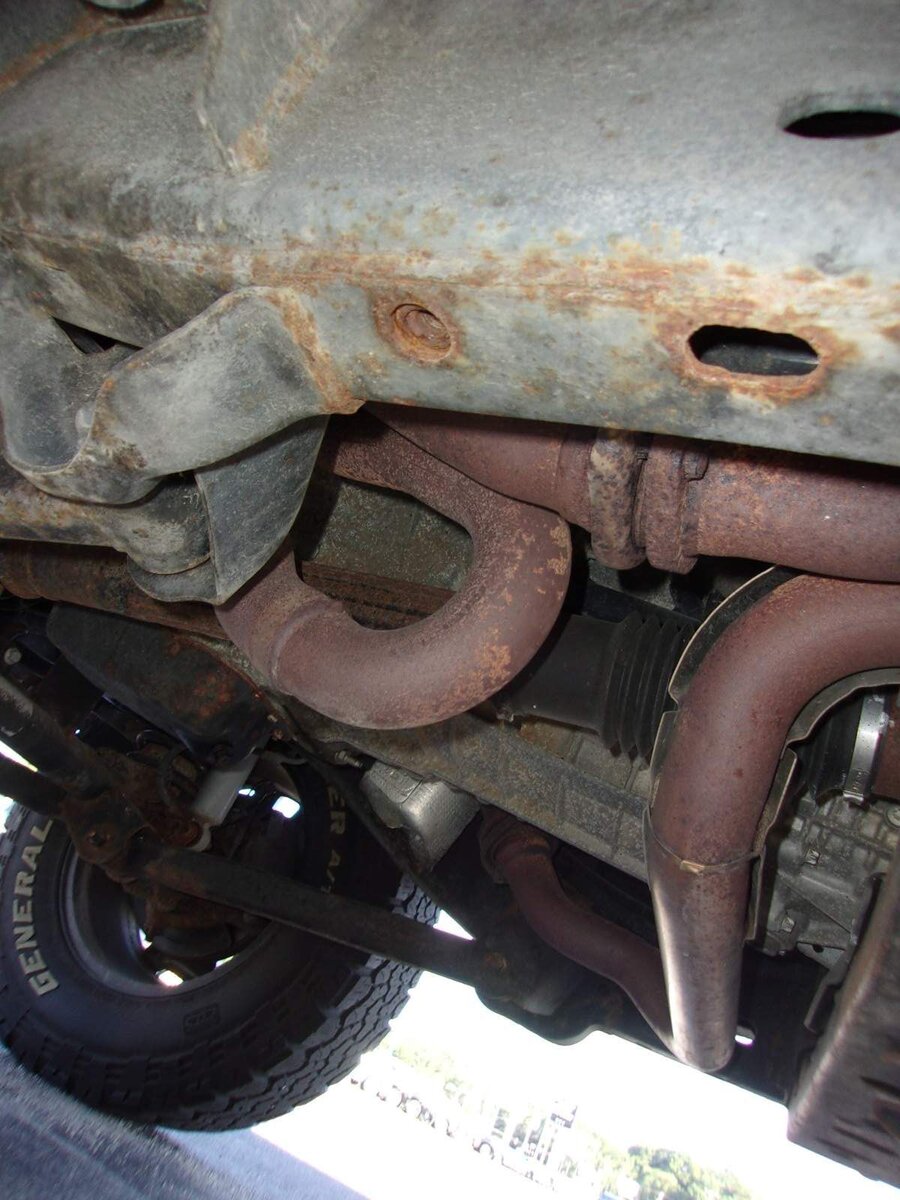

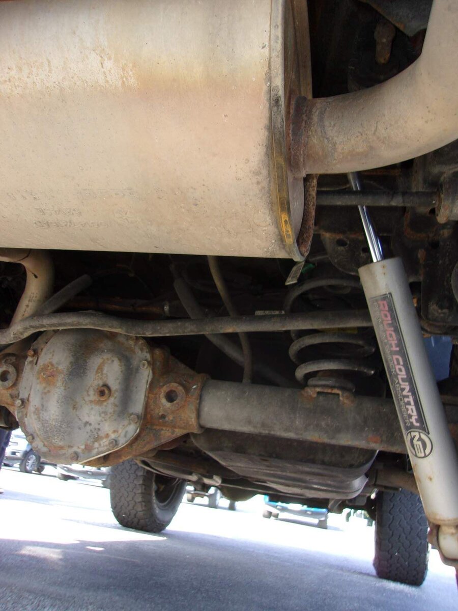

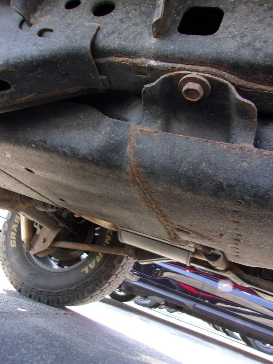

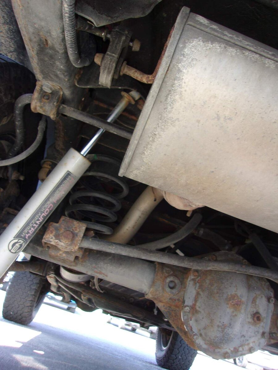

Anyone care to look at the pics of rust on the underbody of a 2015 JK? Had it inspected for a pre-purchase inspection this morning and would appreciate thoughts and opinions. Is this normal wear and tear or anything to be concerned about? It's been in Illinois its whole life. Thanks!
I just bought (July) a 2014 Rubicon from PA and it looked similar. I used POR15 and a product from Eastwood called Rust Encapsulator and it’s worked very well.
