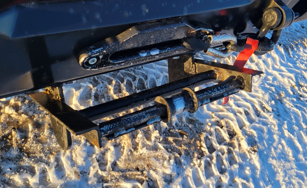

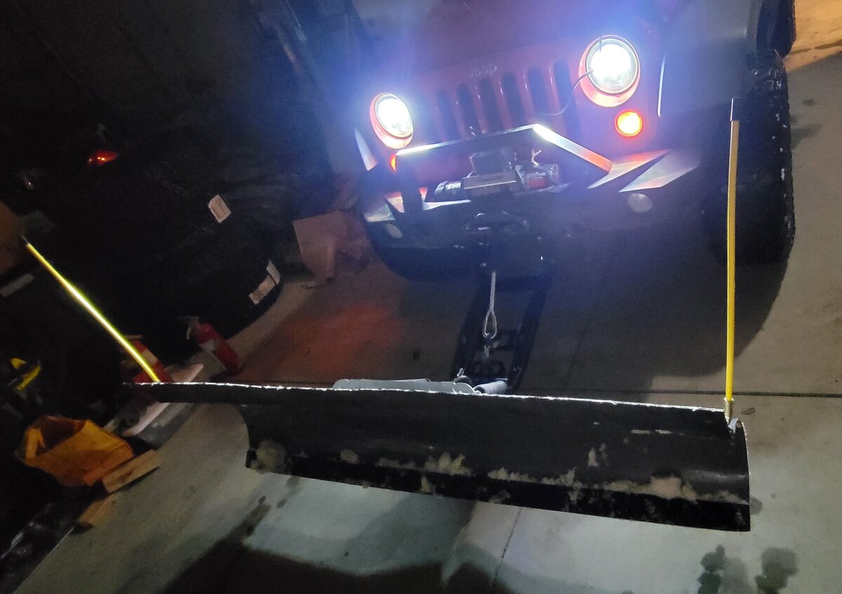

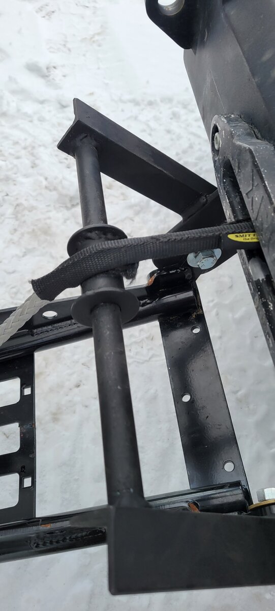

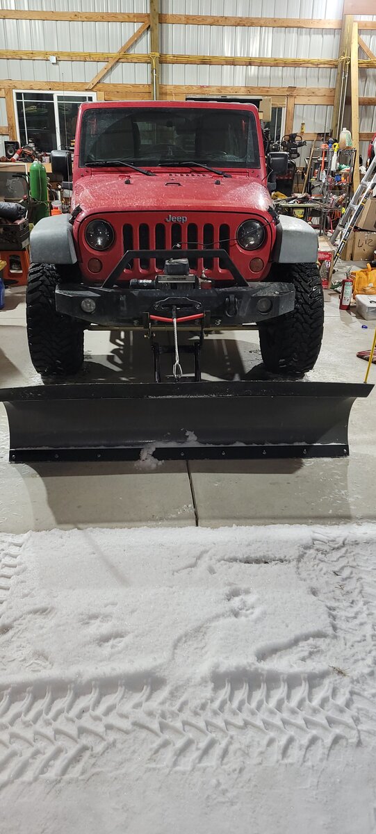

We found a clean JK, aftermarket bumper and a winch so I decided to mount the plow to it.
The bow shackle mounts were too wide for a direct mount, so I had my son grab some 3/8" x 4" flat bar from work and fabbed up a bumper mount.
