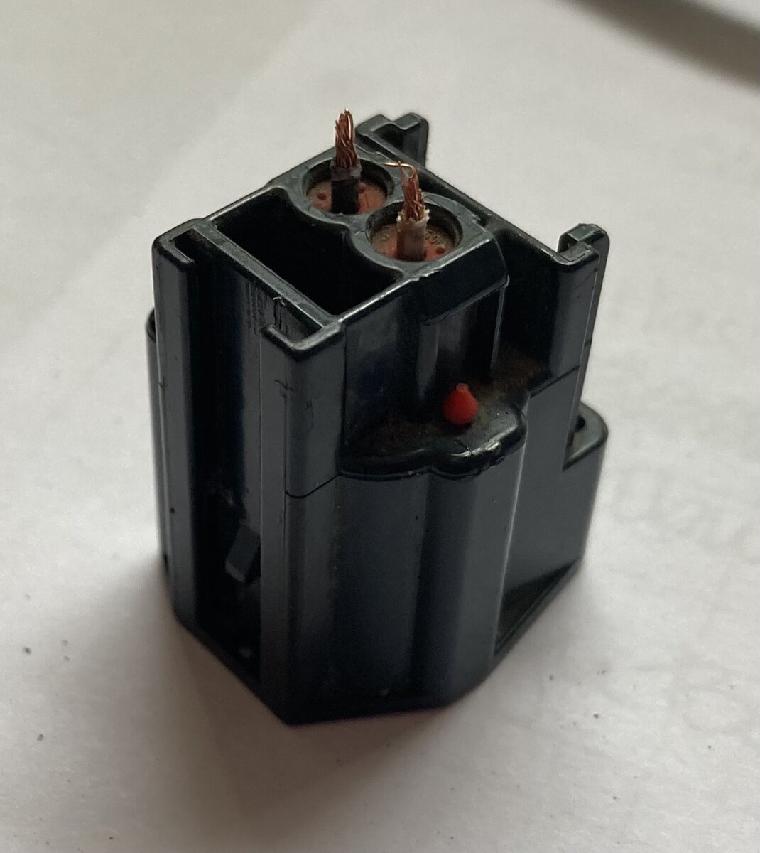

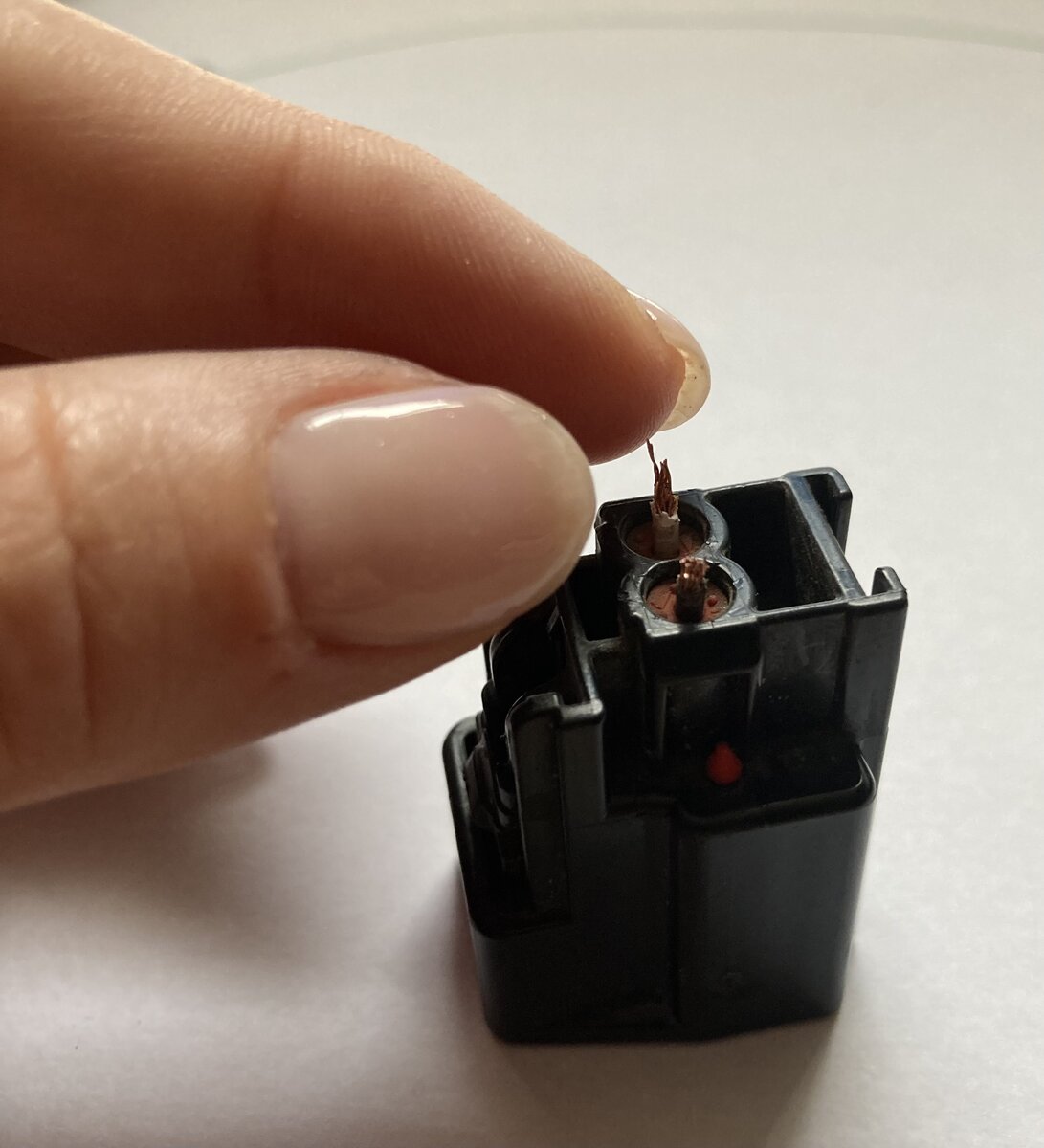

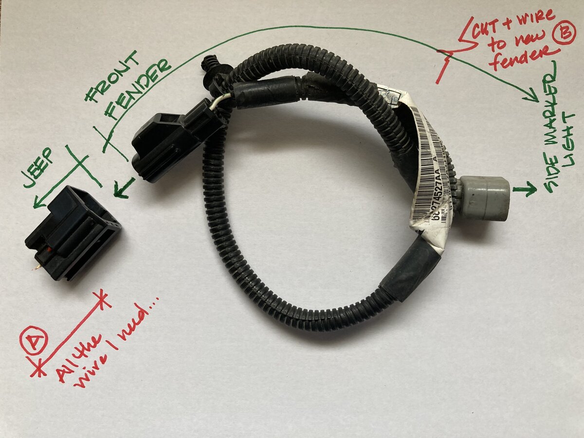

(A) I have the plug off the main wiring harness with about 1/8" of wire left that I'd considered soldering back on to the main harness (see photo with my fat fingers oh my god how am I going to hold all those bits and pieces in place?!). It would be SO MUCH BETTER if I had more wire. So I'm hunting someone's discarded harness piece to purchase, or a part number/name/keyword/identifier to purchase new (can I even do so without purchasing the whole giant harness mess?). Or advice about how else I can salvage this minor disaster.
(B) As far as wiring on the new fender light, I believe I'm supposed to cut off the side marker end plug from the old piece and connect (solder/heatshrink) those newly exposed wire ends directly to the wire ends poking out of the new fender...?

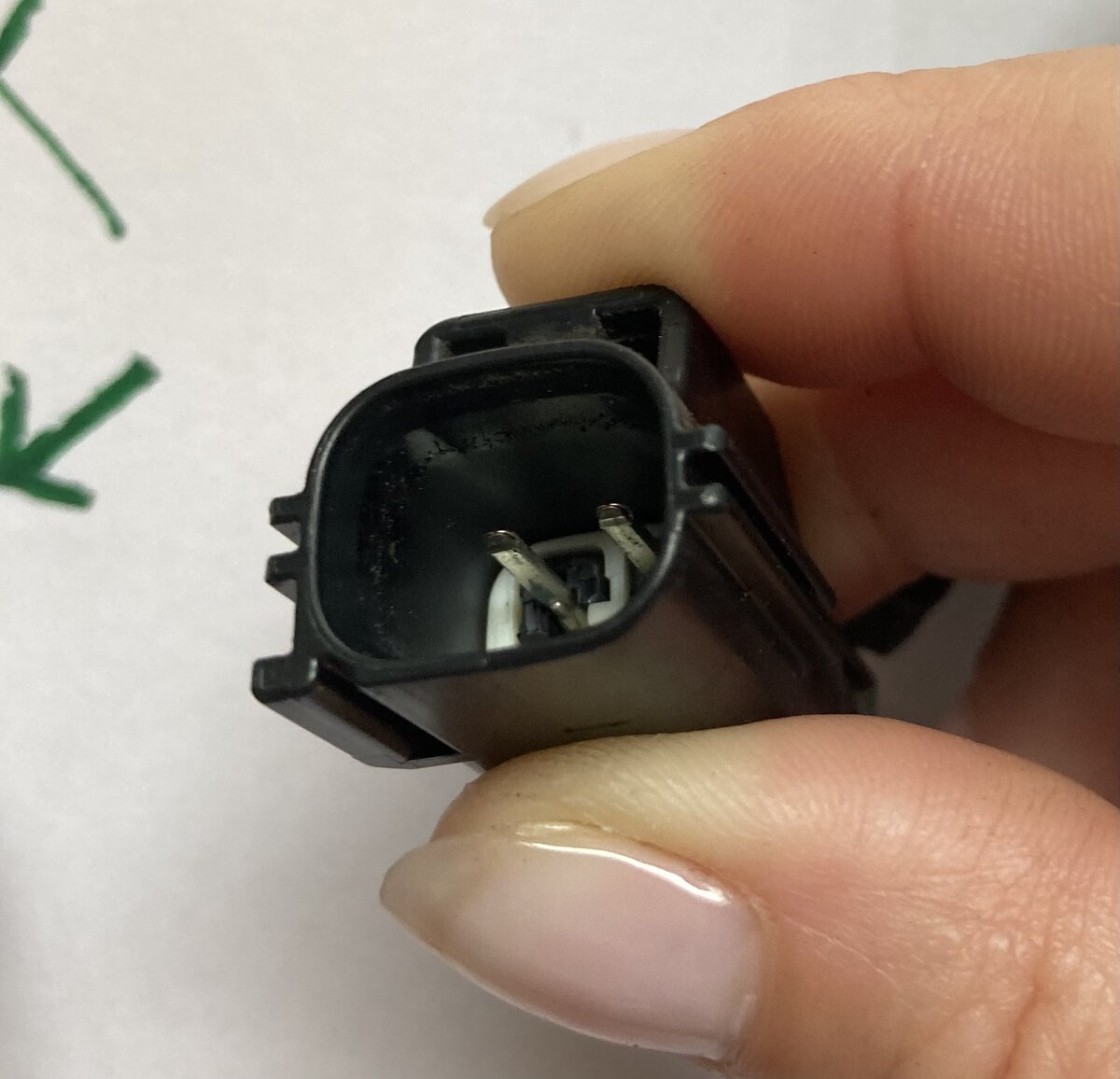

Can you help me remodel my 1802 house? Kidding. Can you post a picture of the Jeep plug and show the connecting pins inside? I want to see if they're removable.

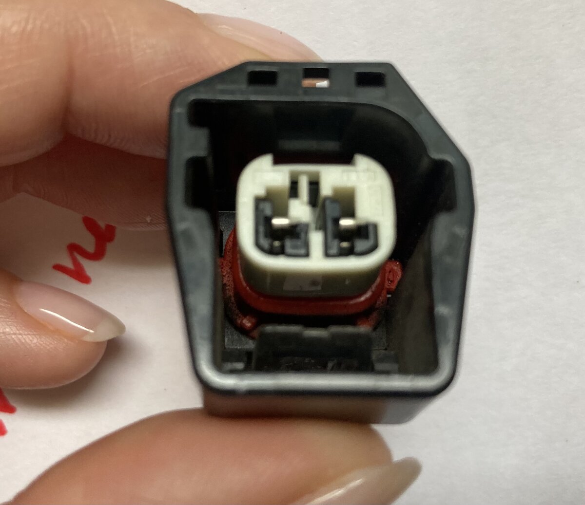

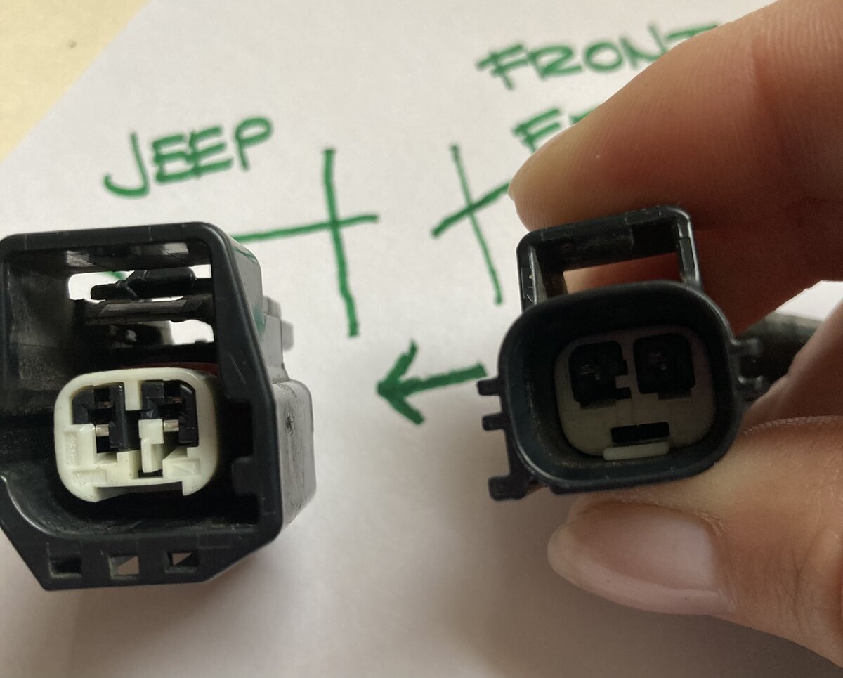

Apologies for the poor lighting conditions. Jeep female side receives pins from fender/marker light side male plug. The pins do not appear to be removable. Jeep side receiver MAY be removable... those teenytiny red cones appear to be attachments, tho the white receiver feels more firmly attached than the flexible red bits would provide. Edit: After more noodling on this, I think the red is a gasket and the white receiver is firmly attached to the black plastic housing. Neither the pins nor the receiver seem to be removable from their housings.
The white cover inside the plug should have clips farther down inside. Get a flashlight and see. You'll need a small flat head screwdriver or something similar to unclip them. Be gentle, they will break. If you can unclip them, that white cover will come off. Once it's off, find a paperclip and you should be able to unclip the female connections and push them through. I'm not 100% sure if they come out the back or the front though.
