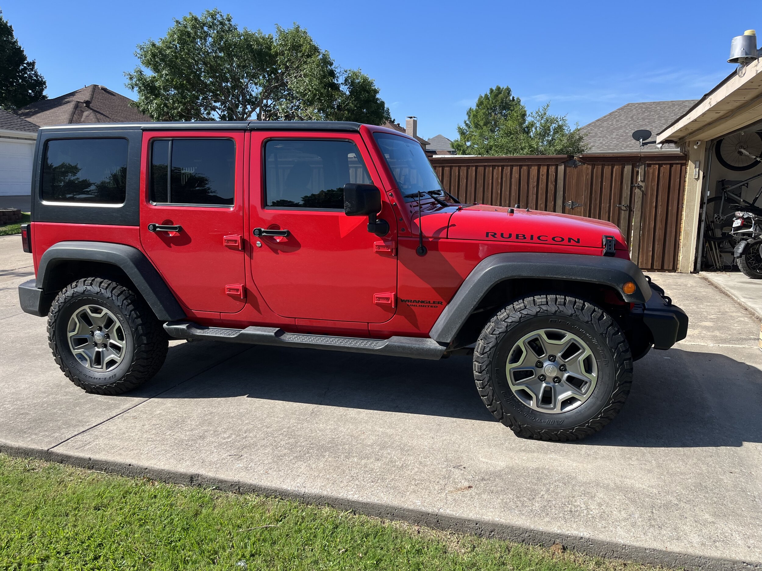

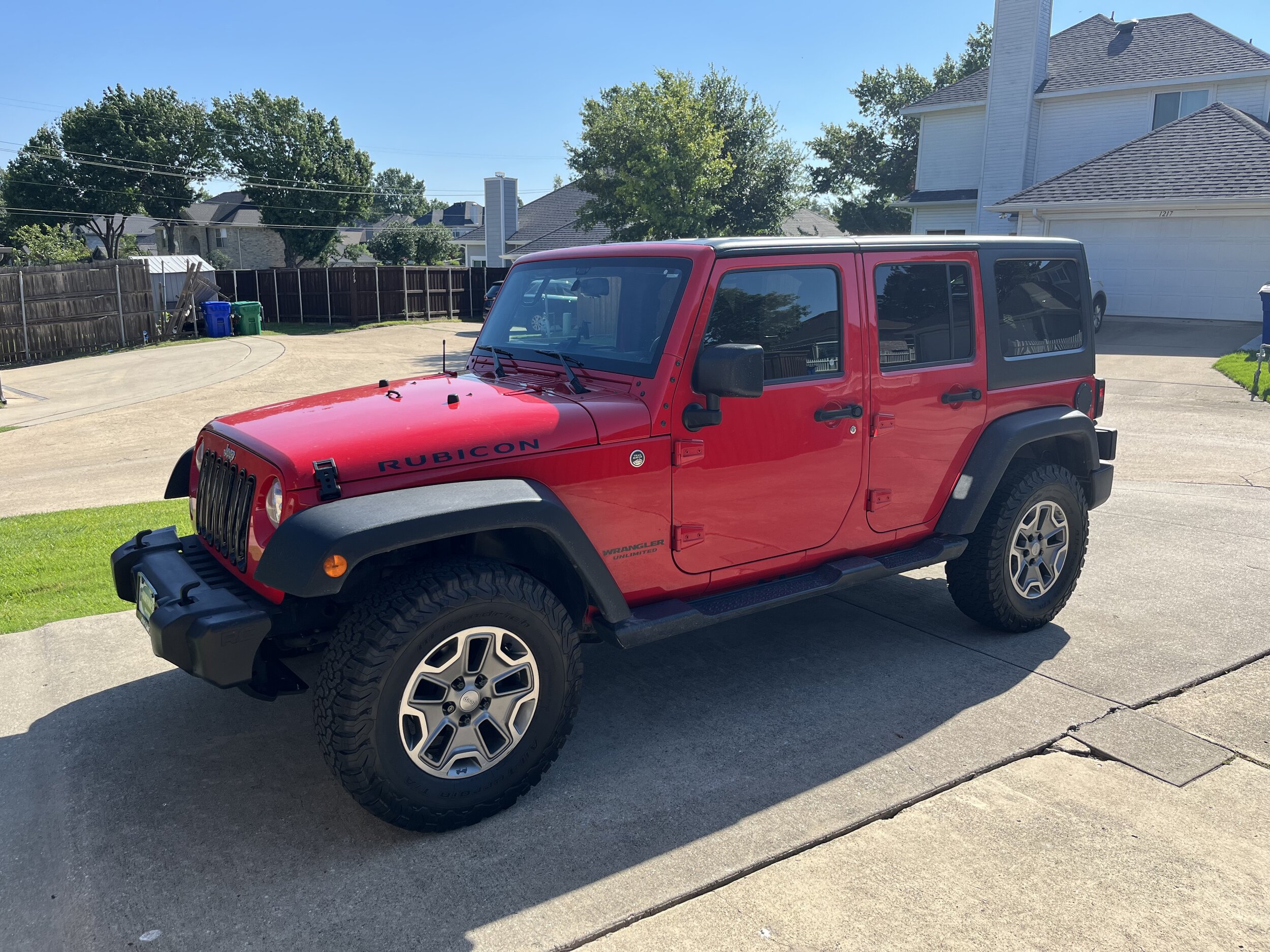

The interesting thing about the front sag is that it is also (I am noticing) really based (visually) on where I park it. If I back it in my drive the front looks a lot lower. If I pull in forward it is almost level. Optics are a funny things.
On this point "your JKU looks like the stance has a rake back to front", I do feel like mine has more than I notice in others. Not sure if this is just a byproduct of spring sag at 75,000 miles or something that was initially inherent.
The shocks are really rusted and pitted and in bad need of replacement. If I do a 2.5 leveling lift, should I opt for one with new springs? I would assume yes, but I do not want to create a really harsh ride. It would be fine for me, but the wife will complain. I was thinking of a 1.5-2" with Fox Pro 2.0 shocks. But maybe something else is in order.

Can you post a pic of your Rubi on somewhat level ground?
