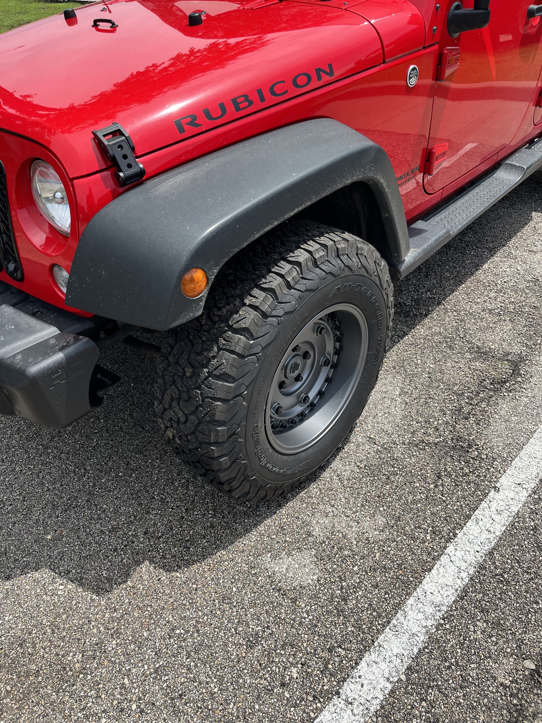

Now, all that said, I am going to be doing light offroading mostly for camping and mountain biking. So I doubt that I will come close to ever stressing spacers or anything else on my Rubie. Does not mean I won't, I have been caught with my pants down before, and even in my more advanced maturity and age, I suspect it will happen again. I may not be as good as I once was, but I am good once as I ever was....
I swapped back to the stock Rubie wheels yesterday and spacers are at the house to be put on today after work. I can say right off the bat that I much prefer the look of the stock setup. Those wheels I got are just too darn wide and made the tire bow out too much. I should have checked that more. They might have worked better on a 35 or 37, but I have no plans to go that big....at this point....
I will post pics when I get it all sorted.

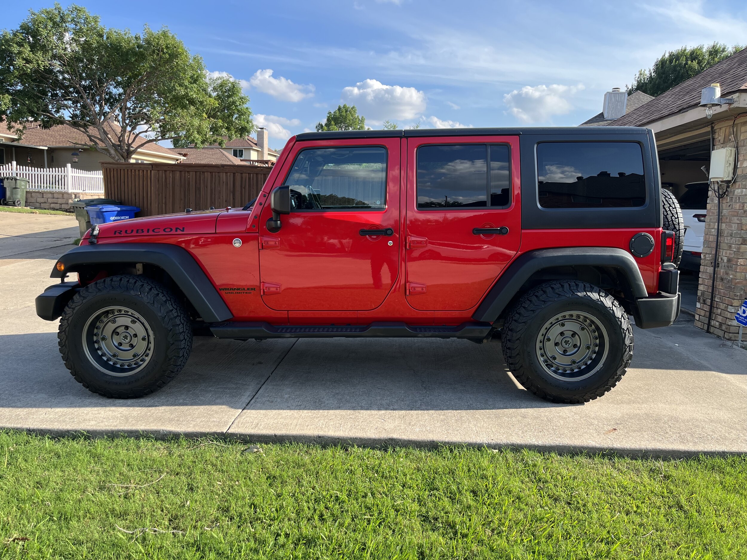

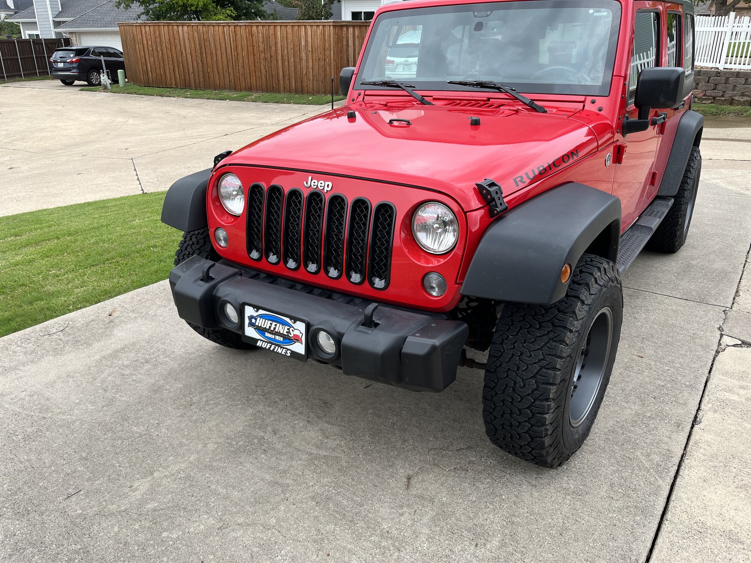

The interesting thing about the front sag is that it is also (I am noticing) really based (visually) on where I park it. If I back it in my drive the front looks a lot lower. If I pull in forward it is almost level. Optics are a funny things.
On this point "your JKU looks like the stance has a rake back to front", I do feel like mine has more than I notice in others. Not sure if this is just a byproduct of spring sag at 75,000 miles or something that was initially inherent.

Can you post a pic of your Rubi on somewhat level ground?
