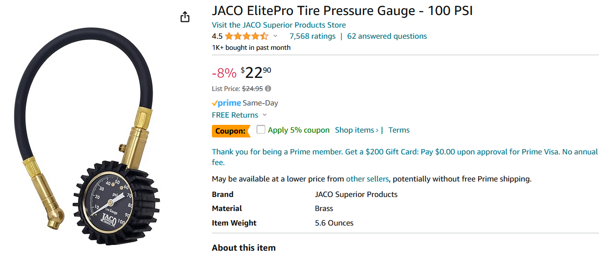

I have a HD pressure gauge from my bike wrenching days that’s within a pound of the TPMS readings on the dash.

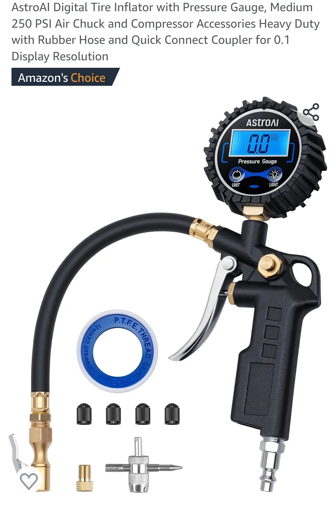

Mine:
Doesn't actually matter. Do the chalk test. That gets you to the right pressure. Measure the pressure and LEAVE THAT GAUGE IN THE JEEP. As long as you're at that pressure on that gauge, you should be fine.
