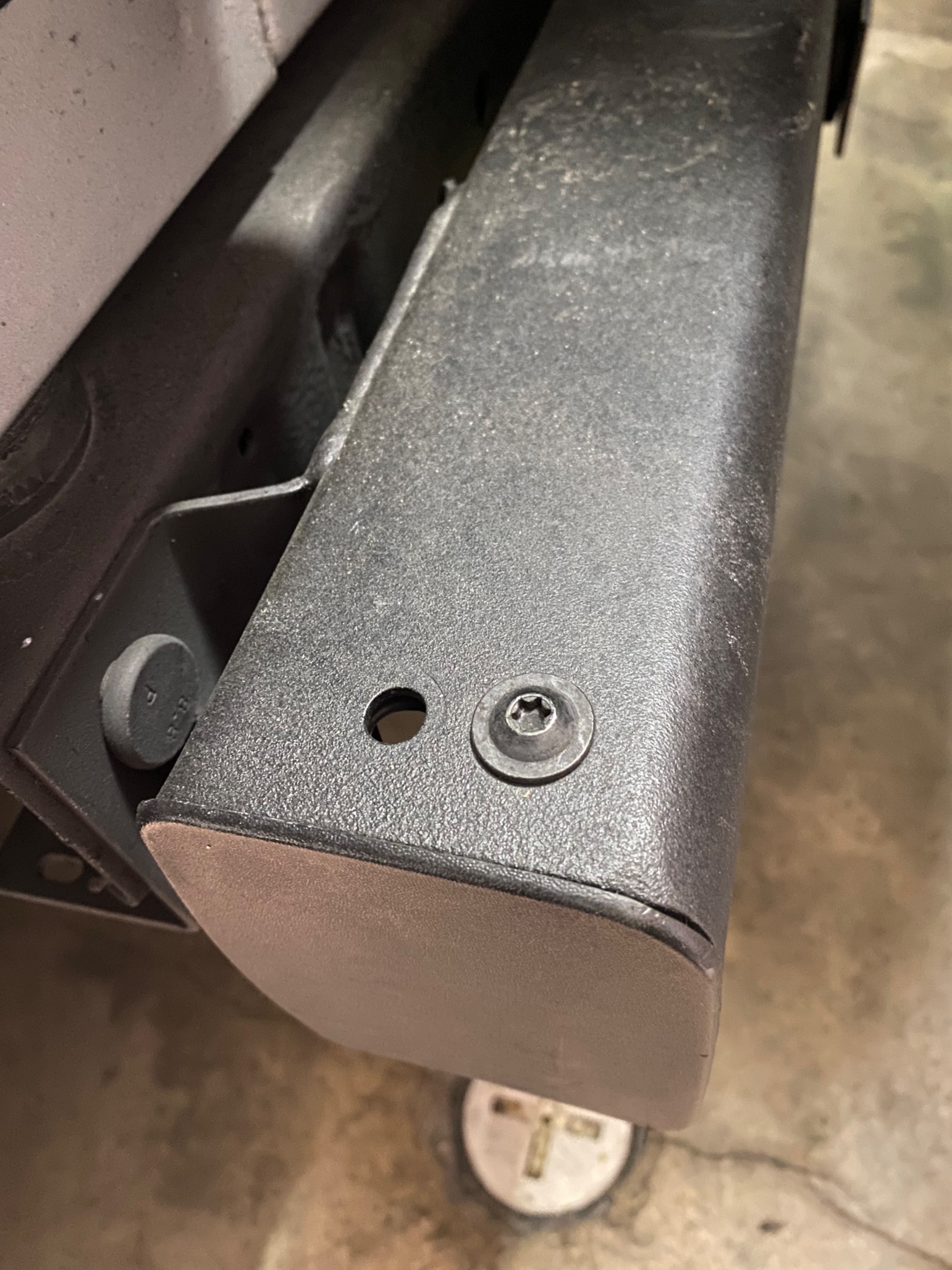

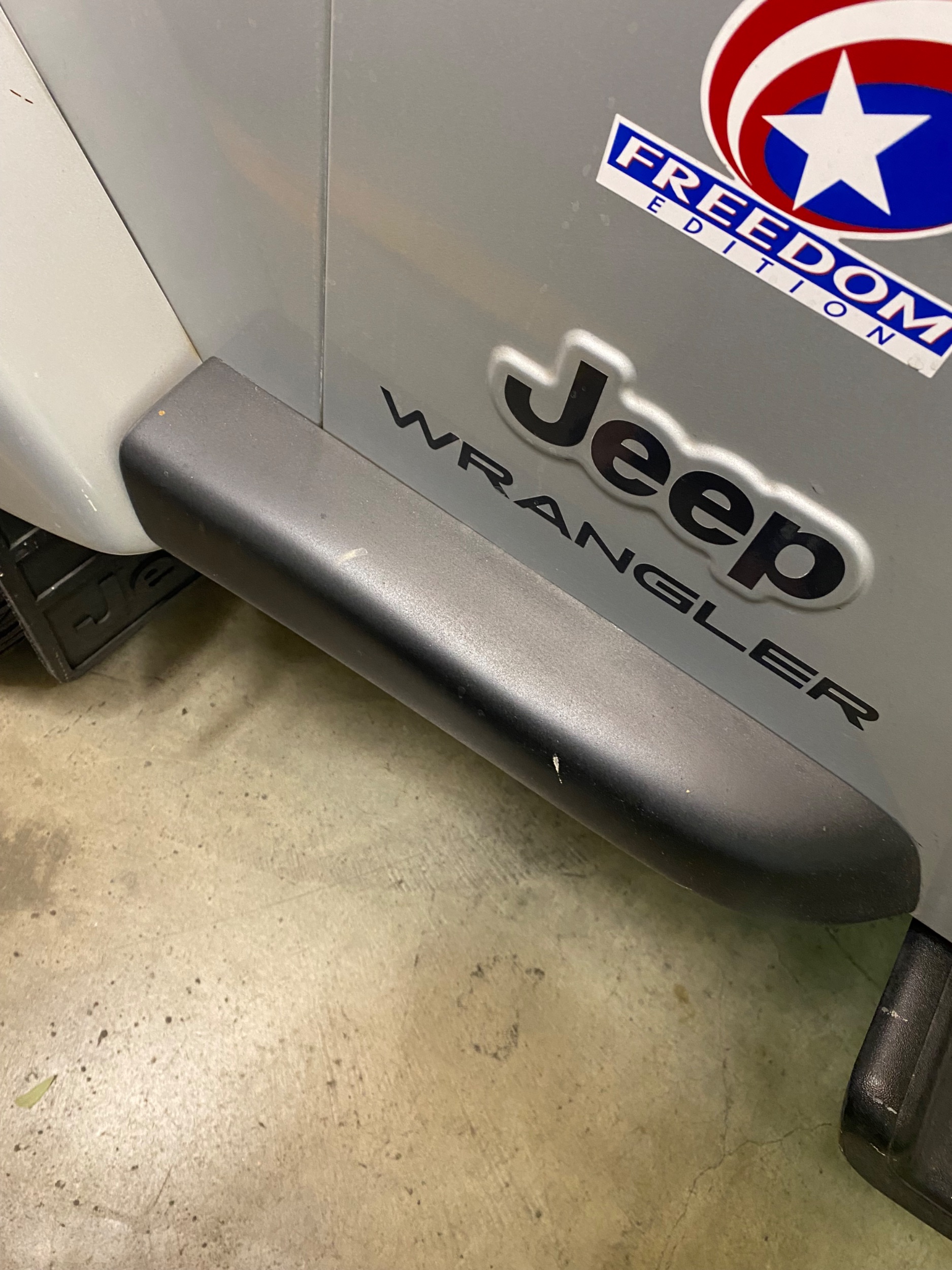

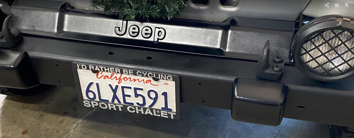

I just did a facelift on our '03 TJ. I had done this to the speaker pods last year and had debated using it on the 'exterior' plastic. I was concerned that it would peel, flake, fade, and generally look worse than before I did anything & that was holding me back.
But a year + into the rework on the usually exposed speaker pods convinced me to give it a try...
Believe it or not, Dupli-Color Vinyl & Fabric paint.
Spray can that you can get at your local auto parts shop.
Be sure to clean and possibly even sand and/or prime the fenders first, but a few good coats of this paint and the side steps, lower fender trim, front bumper filler, & front bumperettes all look NEW.
I'm even thinking about a coat or two on the mirrors now.

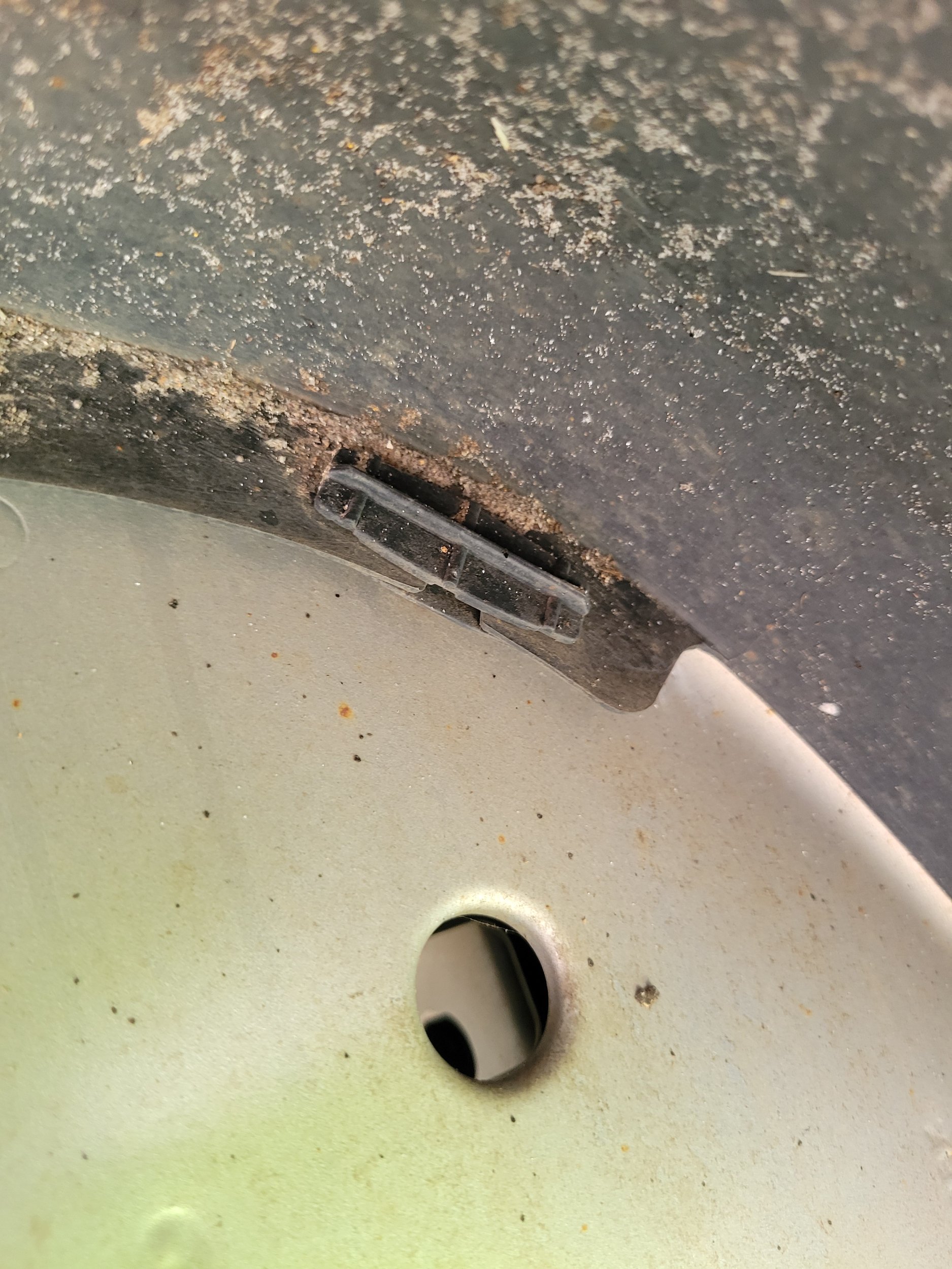

I've tried most of the products mentioned in this thread and still not happy with the results 🙃 I want to remove and paint, but am afraid of breaking off the clips holding the fender (rear) on. Is there a safe way off removing them or will I have to buy new? I've got a clip remover. The plastic clips appear to be brittle

Yes, it's our '03.
I found the end caps (front & rear) on ebay about 8-9 years ago.
Thanks, I like those. I removed the OEM ends, but didn’t like the look so put them back on. Now they both are bent, dented etc. from rocks. Looking for a way to close off the ends.
