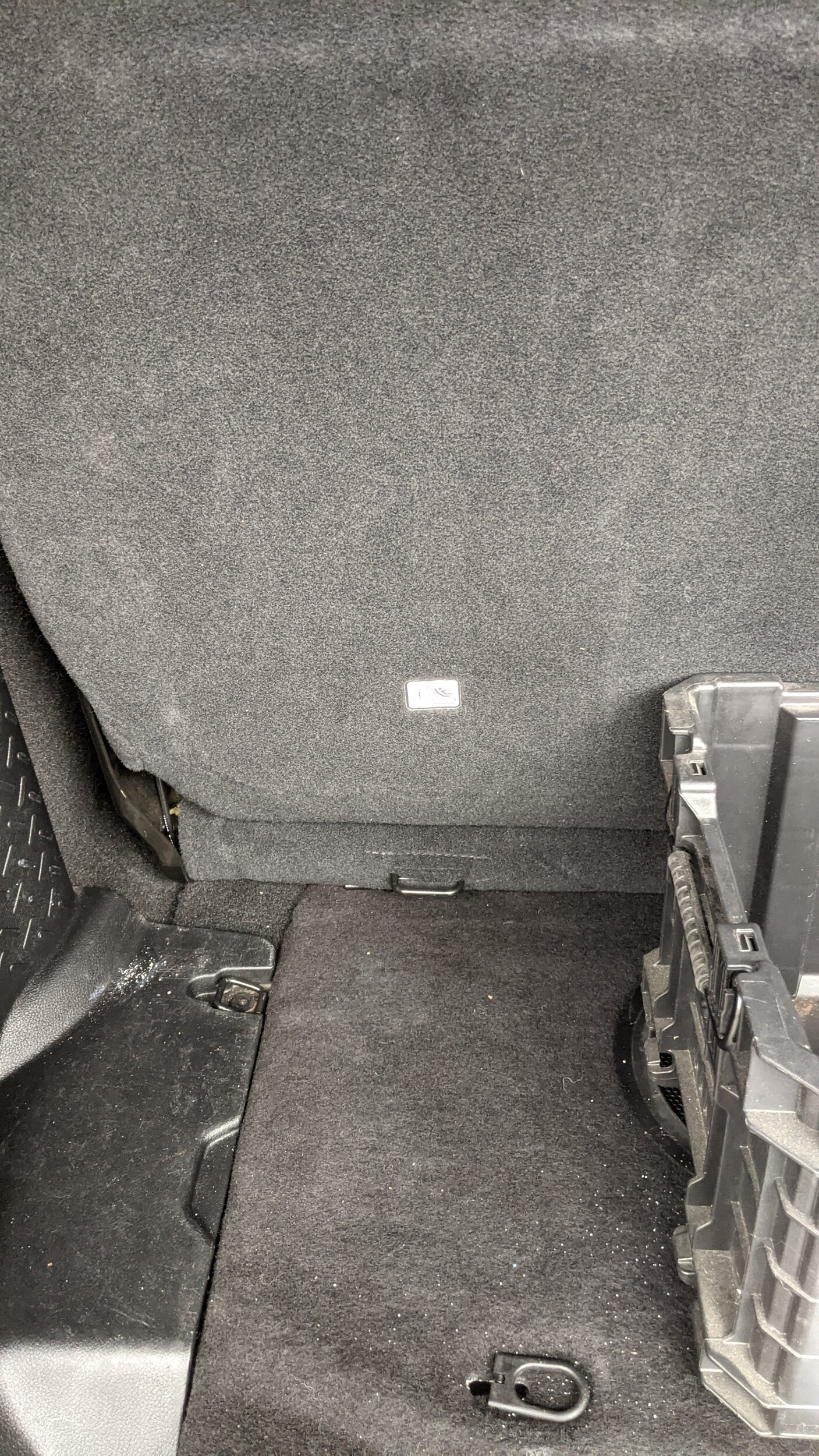

First thanks for the Ad. Wife & I are 1st time jeep owners, 2015 2 door Willys pkg. Our question is how do you keep the rear seat to stay in the folded position up against the front seats without slamming back down when you drive, or accelerate. It does not stay locked against the front seats if im explaining right. Not sure if its broke or I am missing something. Thanks
I found the same thing. Nothing is broke or missing. I am also a 1st time Jeep owner with the same pkg as yours. I stretched a bungee cord across behind the folded seat and hooked it under the rail below the windows. It works.

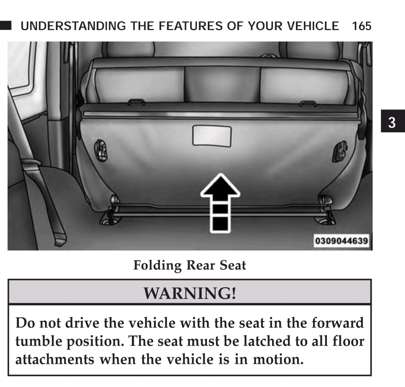

I realize this is an older thread, but as a new JK 2 door owner I was surprised to find no retention for the seat in the tumbled forward position. As a last resort I referred to the manual and thought "you've got to be kidding me." I've never owned any other 2 door hatch style vehicle that specifically states not to allow the folded rear seats while driving... crazy

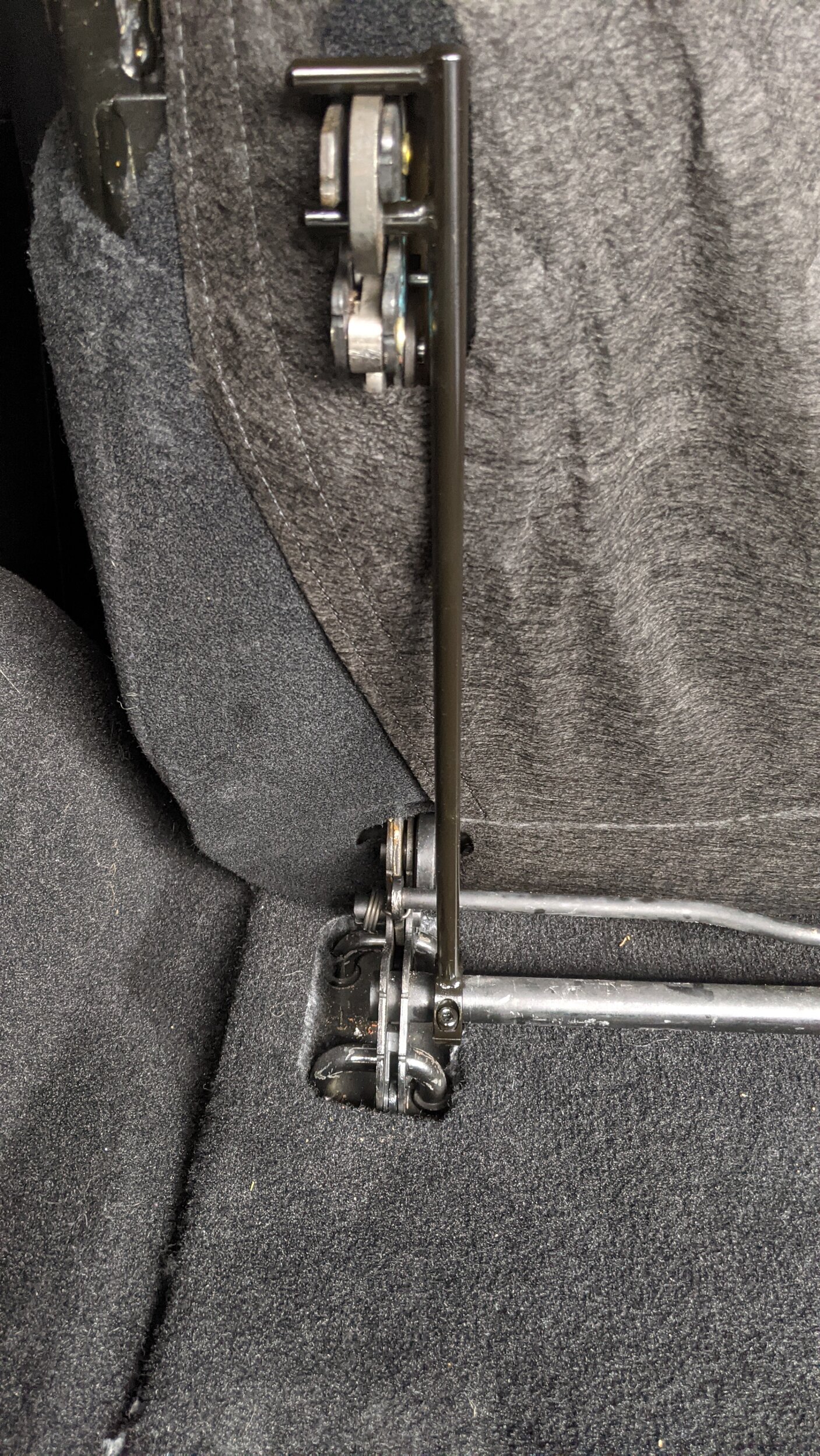

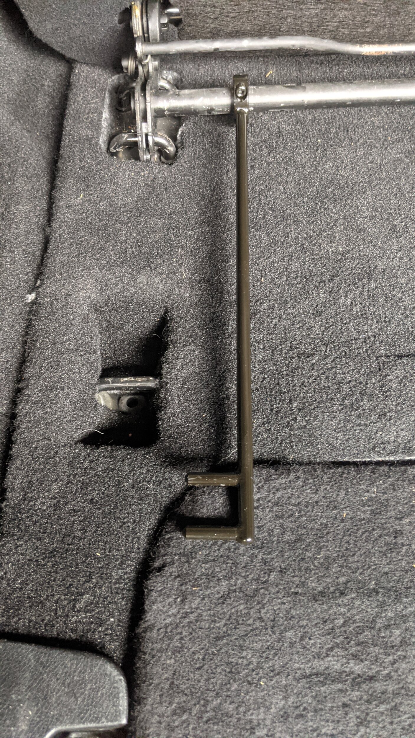

I pulled the trigger for ~$40... Yeah there are other cheaper solutions but it didn't break the bank and I was curious. Simple, but quality made piece. Fits nicely around the crossbar. Just enough clearance so it will slide but doesn't wobble. It can be left attached, but not engaged, at all times and doesn't interfere with folding the seat back up:
