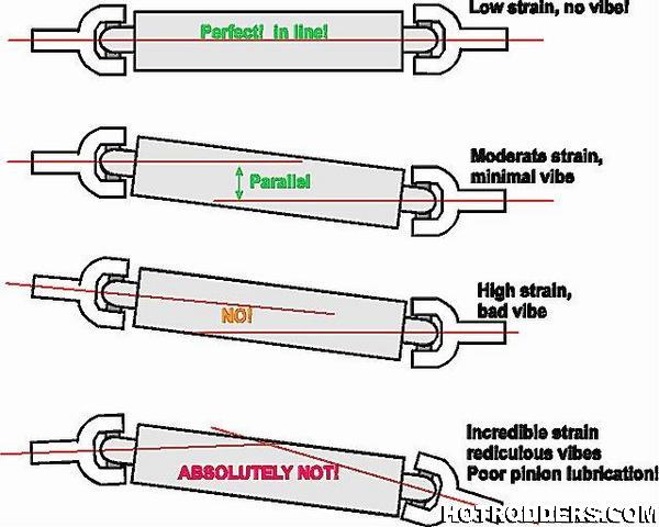

The bigger concern, to me, is that the increased pinion angle may be causing your pinion gear to be oil starved. The pinion angle should have been corrected when the lift was installed. Since you're under there anyway, I'd get it corrected before I did anything else. You should be able to get sims easily enough, and YouTube will have a bazillion videos to show you how to determine the correct angle.

This might help. Which of these best matches your pinion angle?
