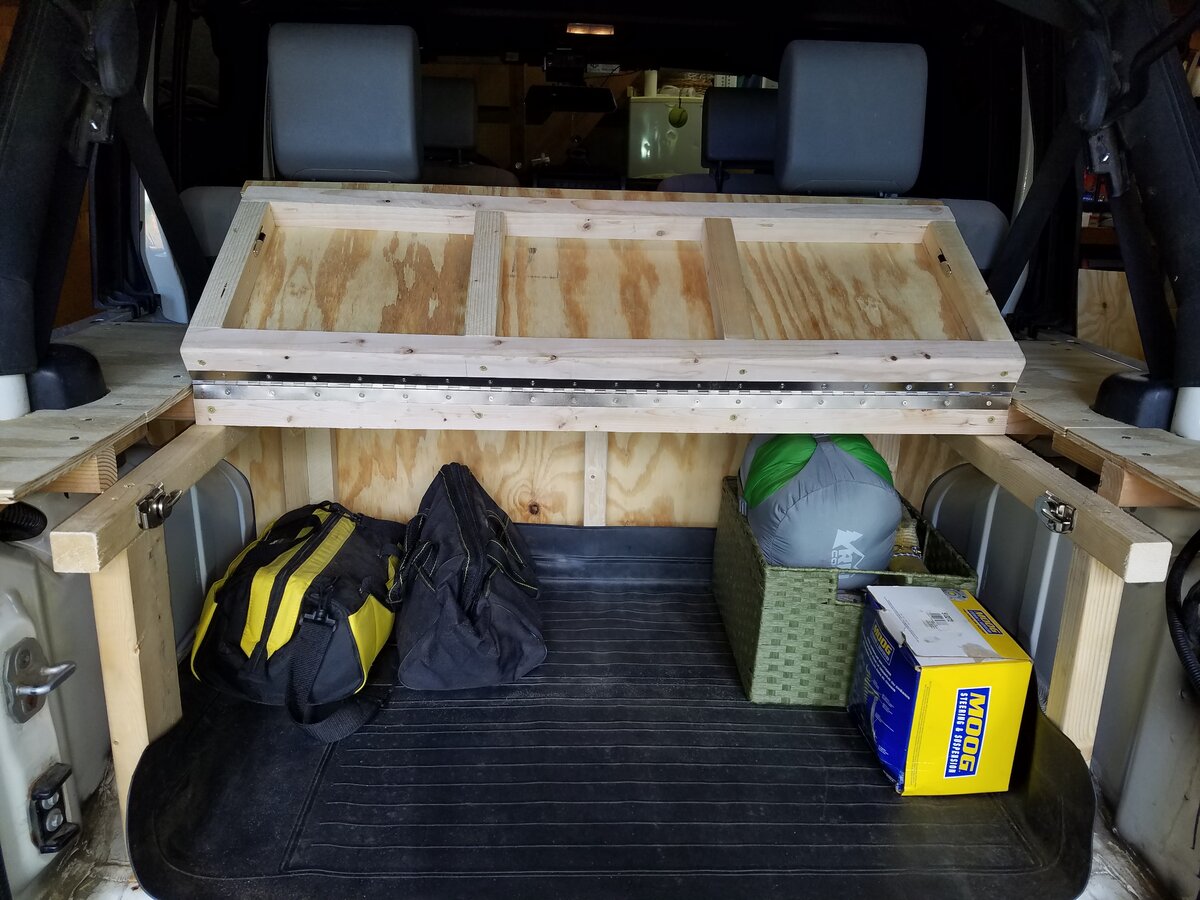

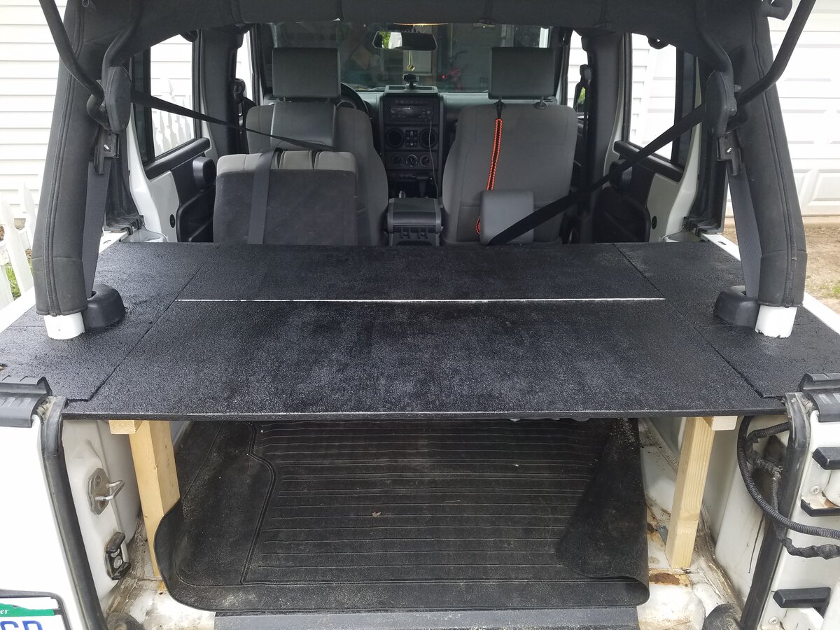

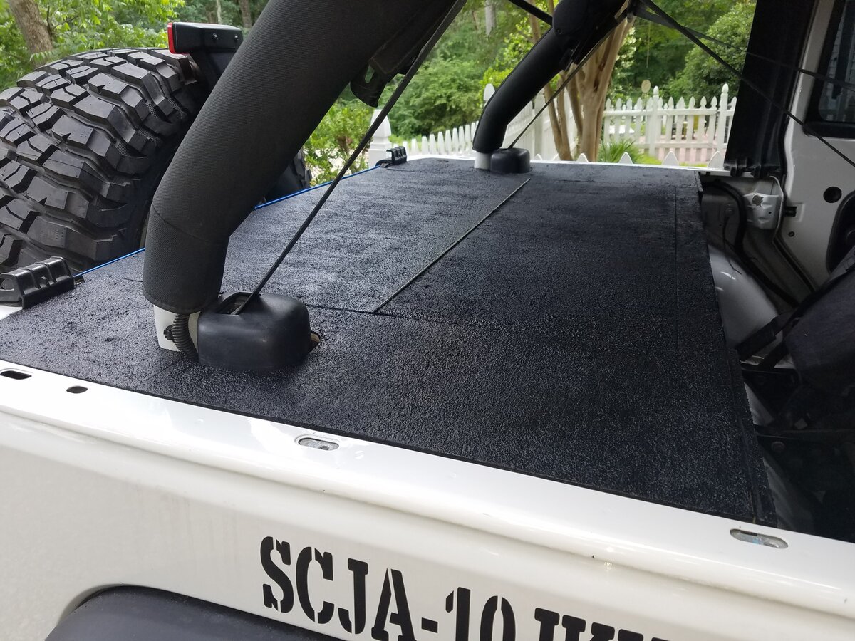

So I'm almost finished with a rear cargo storage system. I wanted a way to keep valuables locked with the top down. I could have bought one but they are a little pricey. I based mine off of one I found online but modified it a little. It turned out pretty good.
The center folds in half and can be completely removed. The center piece behind the rear seats can also be removed.

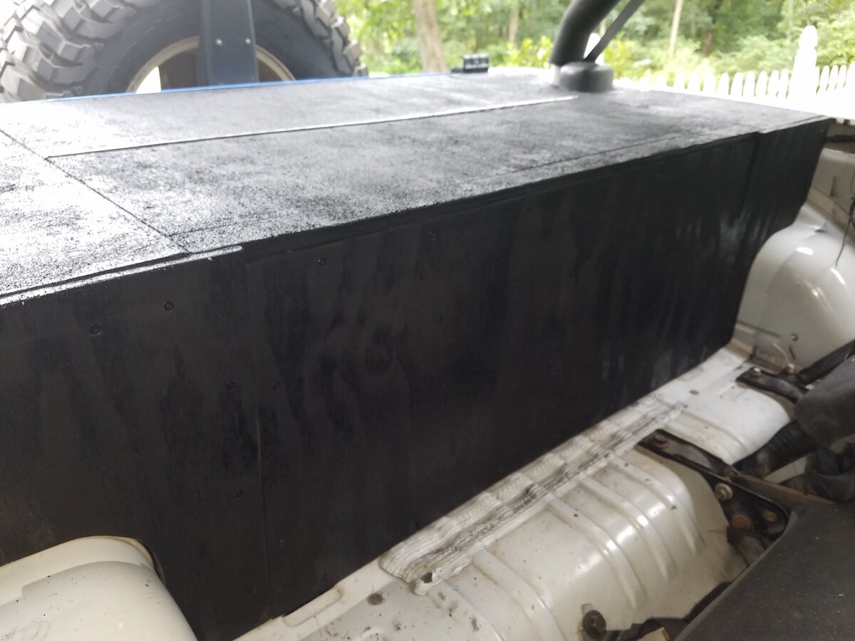

I covered it with leftover Herculiner from our TJ, except behind the seat.
I just spray painted that part.

Here's a pic with the first section folded. The panel behind the seat is currently just screwed in one each side but I plan to put knobs on so no special tools required if it needs removed. This will allow the seats to fold and still have the full space if needed.
