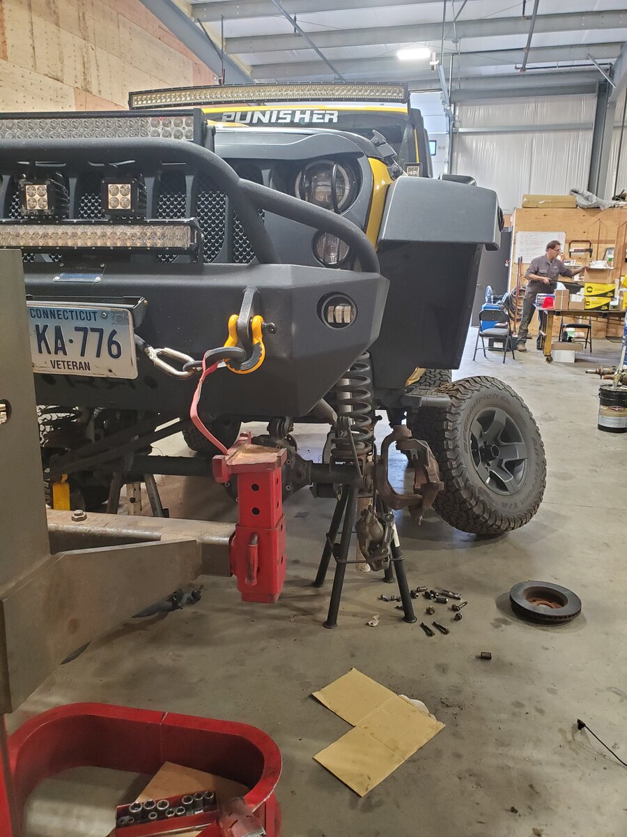

The time has come! The jeep goes in the shop tomorrow to remove the 3.21's and get her new 4.56's. Also going from open differentials to limited slip differentials.

The shop I took it to is Connecticut Axle & Spindle. They do more of commercial vehicles. They do jeeps but it's not their main business. He was well aware of the need for the jscan.

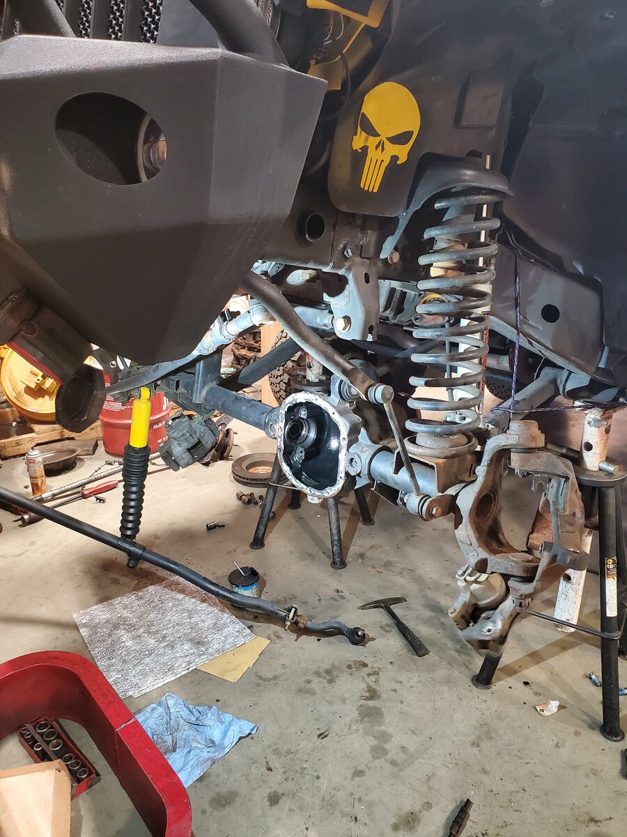

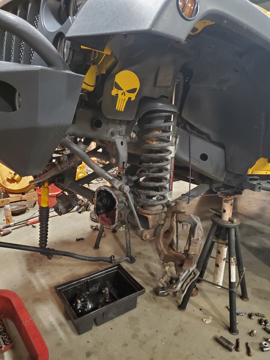

Axle update. Everything went perfectly with the gear replacement. I got rid of the 3.21 gears with an open differential and installed 4.56 gears with limited slip differentials. The jscan worked awesome. Three simple steps and I was off to the races. Now I just have to do the break-in for 100 miles the change the gear oil in 500 miles. I was very impressed with the shop that did it. He started on it this morning and by 2:30 it was done. It's pulling the hills better and it not down shifting less on the hills. Very pleased with the outcome.
