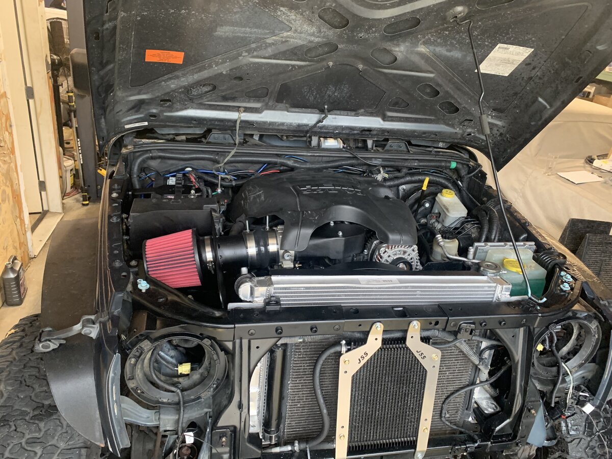

Pics for attention. Also I never drove the Jeep before the swap it was blown motor.
