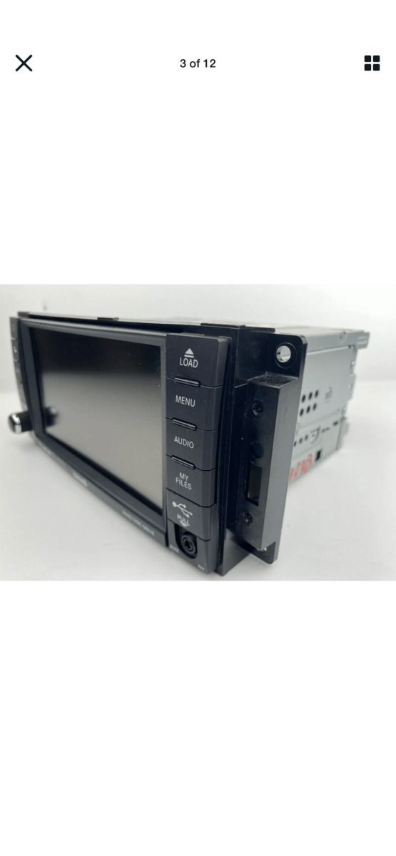

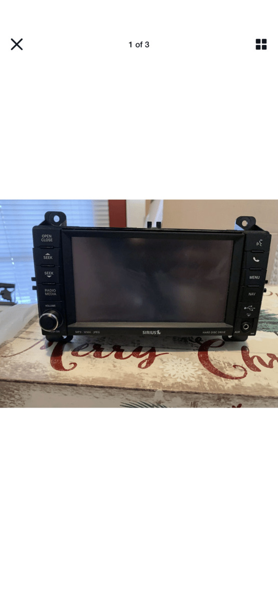

When I look at stock radio on eBay like 430n or 130 some have side mounts and some (seems like fewer choices) have top mounts like mine. Assuming if I bough a stock radio with side mounts it wouldn’t work unless I fabricated something. Some radio’s for sale don’t show the location on mounts in the picture.
Different types of mounts

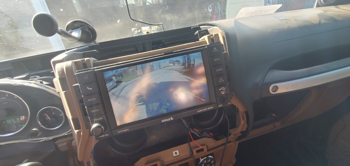

i have a 2012, but from what i recall when i wired my backup camera was that it was side mounted.
edit: found a photo of my install.
430N are used in a lot of different cars though (chrysler dodge and jeep) so the one you found might not be for the jeep.

I used the same mounts for my 2009 as I had for my 2014. I literally pulled the stereo out of my wrecked 14 and put it into my 09. All side mounts. Though I've only had 4 doors in my JKs. There have been some strange things that are different between the 09 and the 14, so I can only guess that there is a similar thing between 2 and 4 door.
