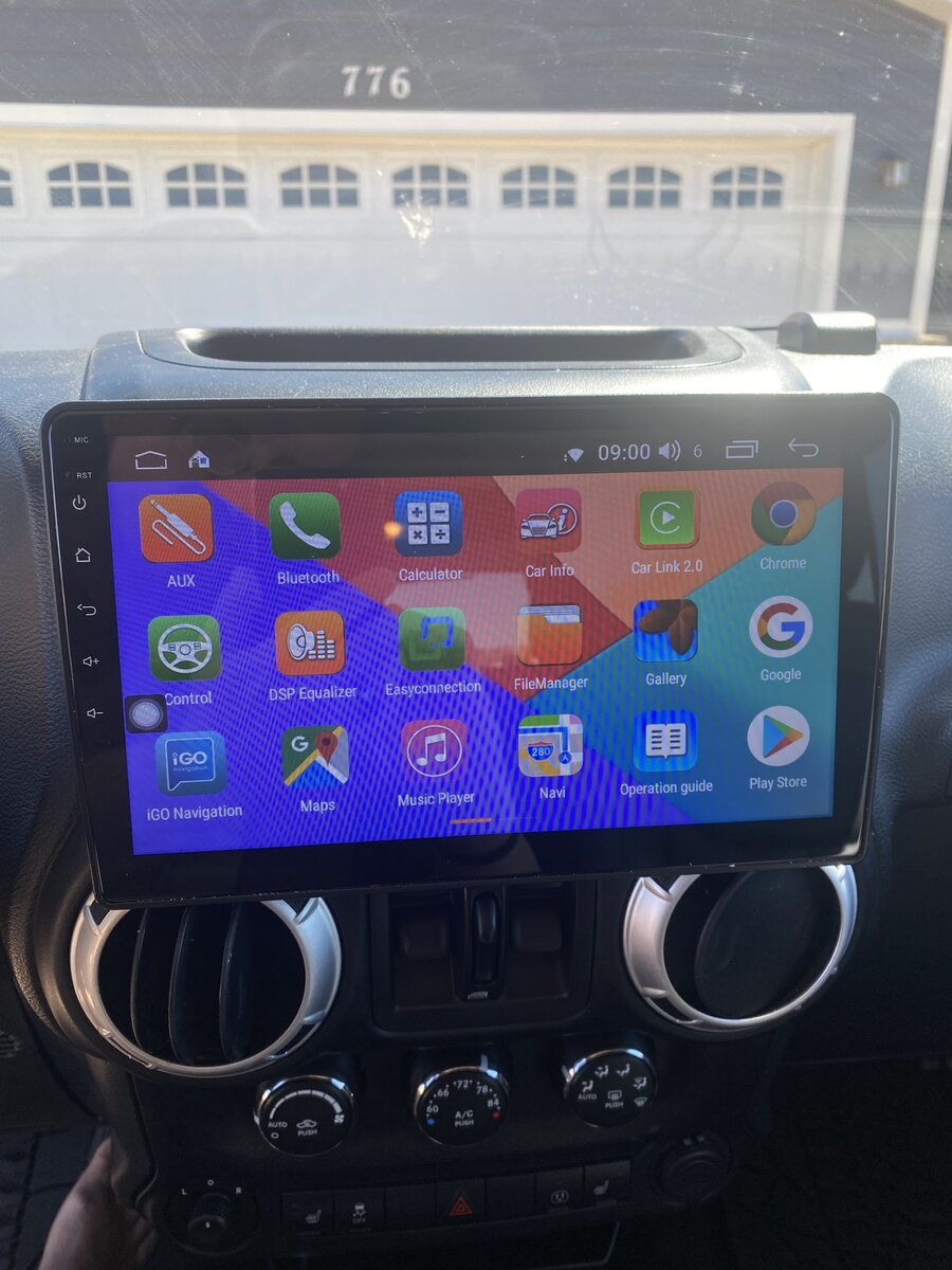

I replaced both of ours with THESE units from Amazon. Added THIS backup camera. Less than $300 for the whole shebang. Works with the factory steering wheel controls. Took a couple hours to install each one, most of which was deciding where to mount the camera, and running wiring.

I should mention that it's not exactly as the photos on Amazon show. The dash on the JK is one piece, from drivers side to the passenger side of the radio/HVAC. The version pictured requires replacement of that panel with 3 pieces. Which adds to the price, of course. The version I have does not change the dash panel. You remove the dash and OEM radio. There is a bracket included in the kit that bolts into the OEM radio mount. The head unit just snaps into place after the dash is back together. Which means if you want to do other things in that space (like add a backup cam) you can just pop it back out. The larger screen (10" is really pretty big...) does overlap the power window controls a bit. Not enough to make using them at all difficult, though, it's strictly visual. And that's a height thing. I'm 6'1", and it blocks me seeing the top of the power window switch panel. I can see the buttons just fine. My wife, who is 5'7", can see the entire panel.
I posted this picture in another thread.
