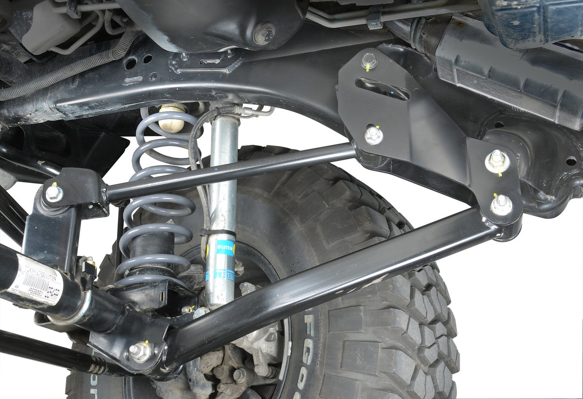

My concern Is the non adjustable arms with the AEV lift, nor does it come with control arm brackets - its basically just coils, steering, track bar/sway bar brackets and shocks????

I have it. It doesn't have adjustable control arm brackets. It's coils and control arm relocation brackets. There's no need for adjustable control arms, as it sets the control arms exactly where the need to be via the relocation brackets.
After a quick call to AEV the kit does come with geometry brackets, however they are not mentioned in the instructions lol.
There are separate instructions for those on a different part of the website.
Yes, the do indeed come with the geometry brackets. They look like this:
