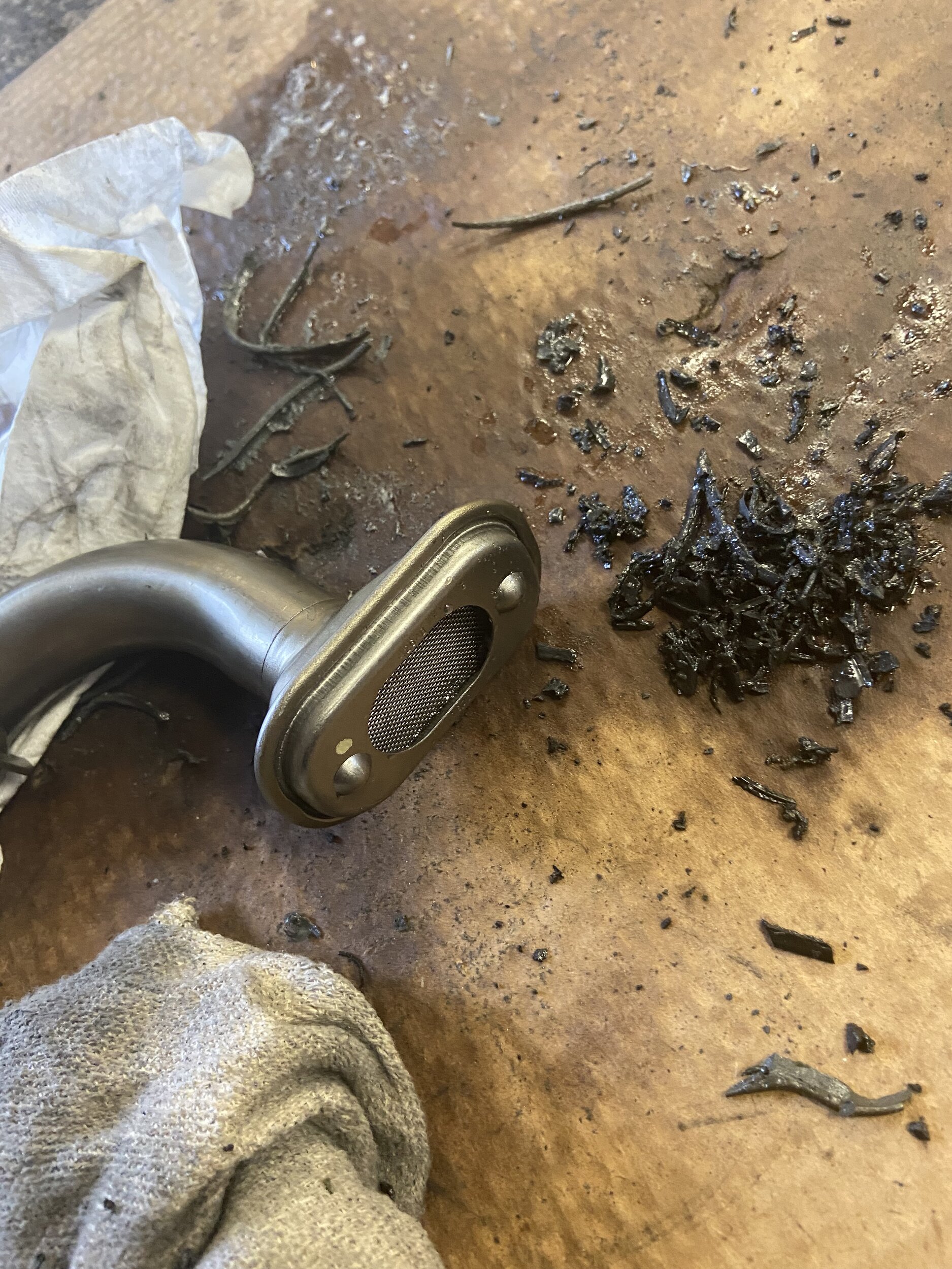

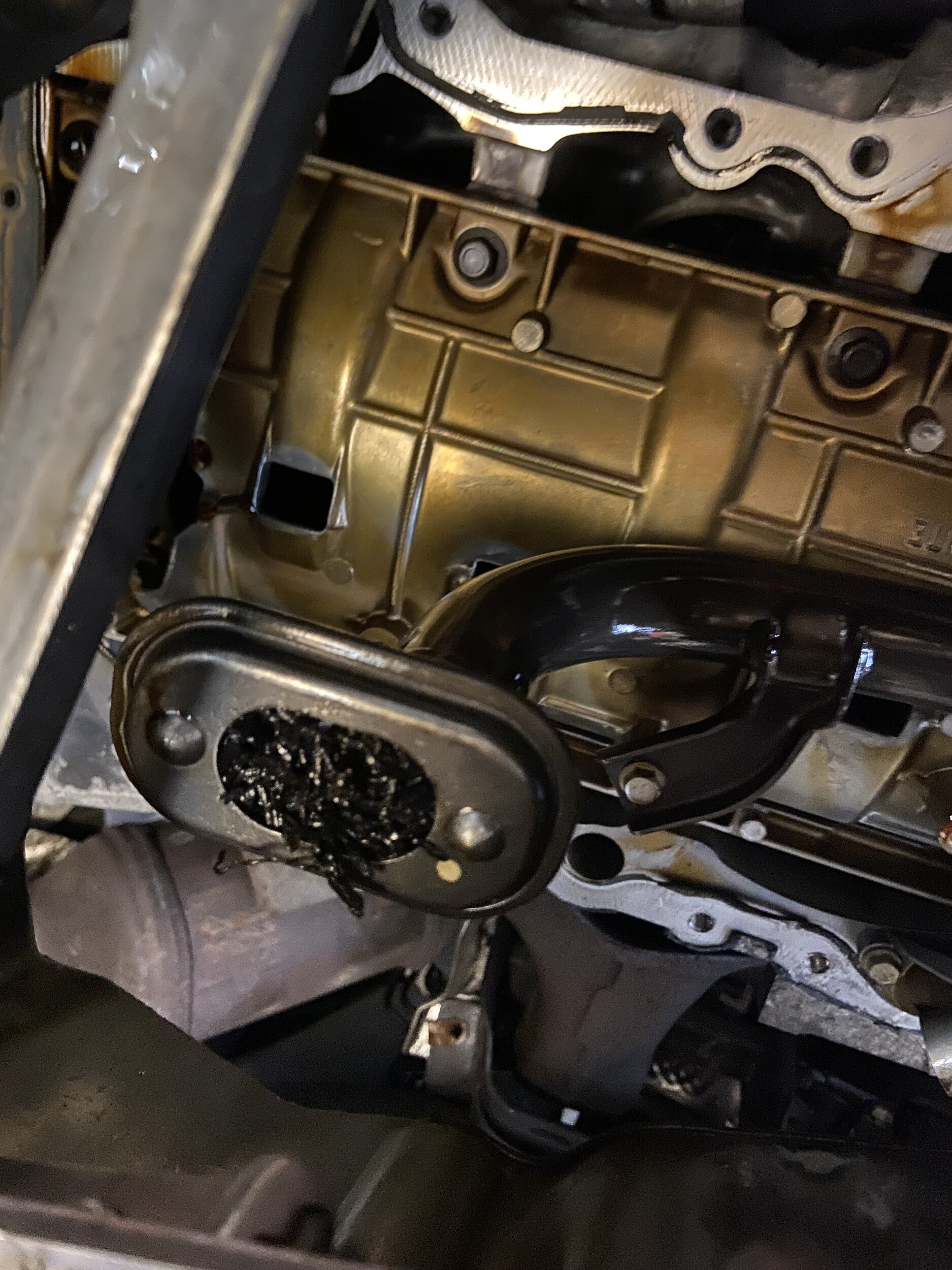

My sons 2012 Jk started showing code
PO60DD which relates to oil pressure not going high on two speed pump or sensor issue Knowing the 2012 had some sensor issues and faulty oil coolers I replace the oil cooler assembly with sensor, still had the same issues
Next checked was getting signal to solonoid so I ordered a new oil pump
When I opened the oil pan I was shocked the silicon gasket maker had broken down inside pan and clogged oil screen on pump
This Jeep has been in our family since new so this is the original gasket materials from factory , while in there went ahead and changed pump and now all is well
I am still in shock that this product would break down to such a level

Yes exactly it’s stuck like hell that’s why was surprised how the glue that was exposed to oil broke down
