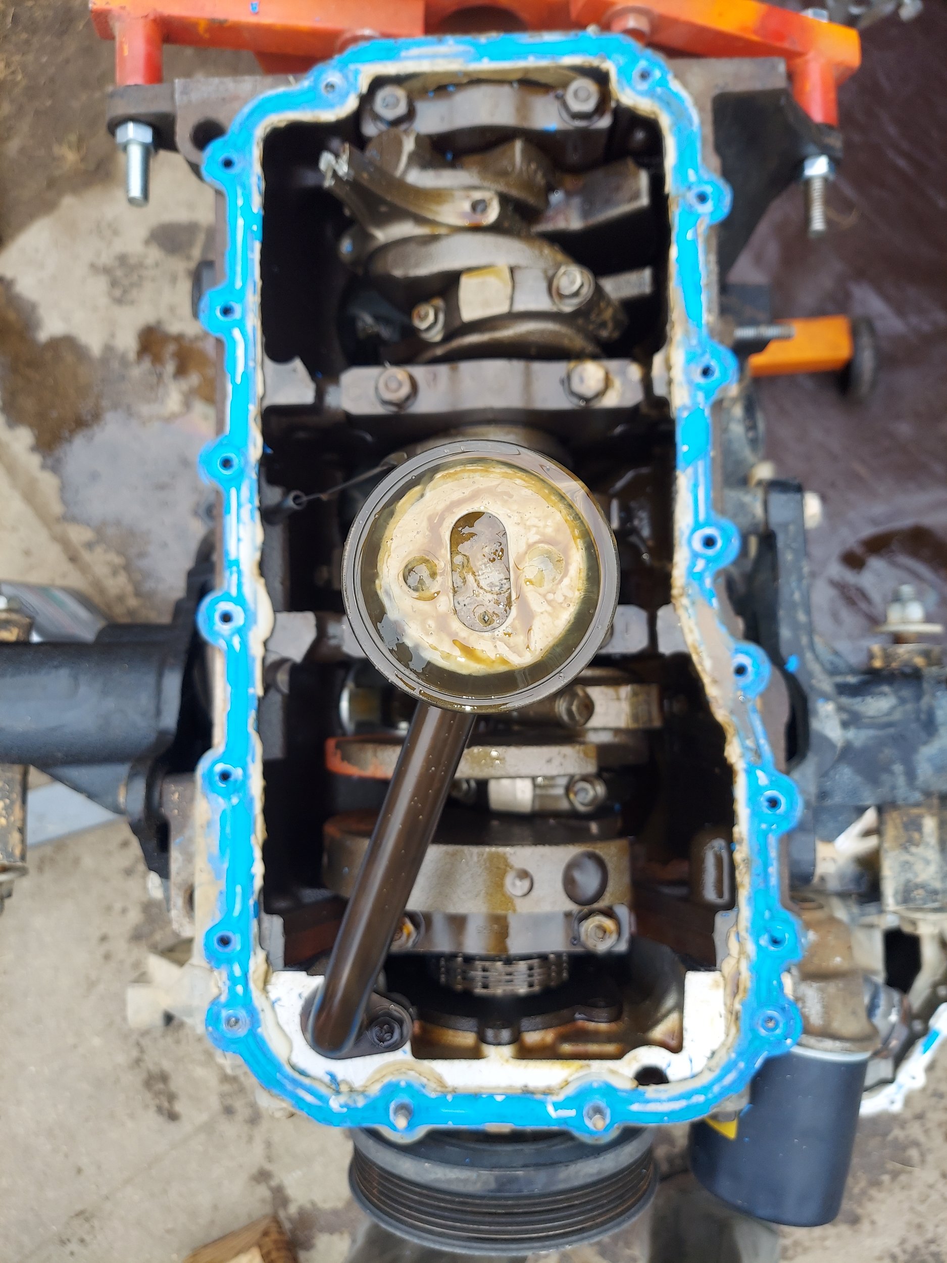

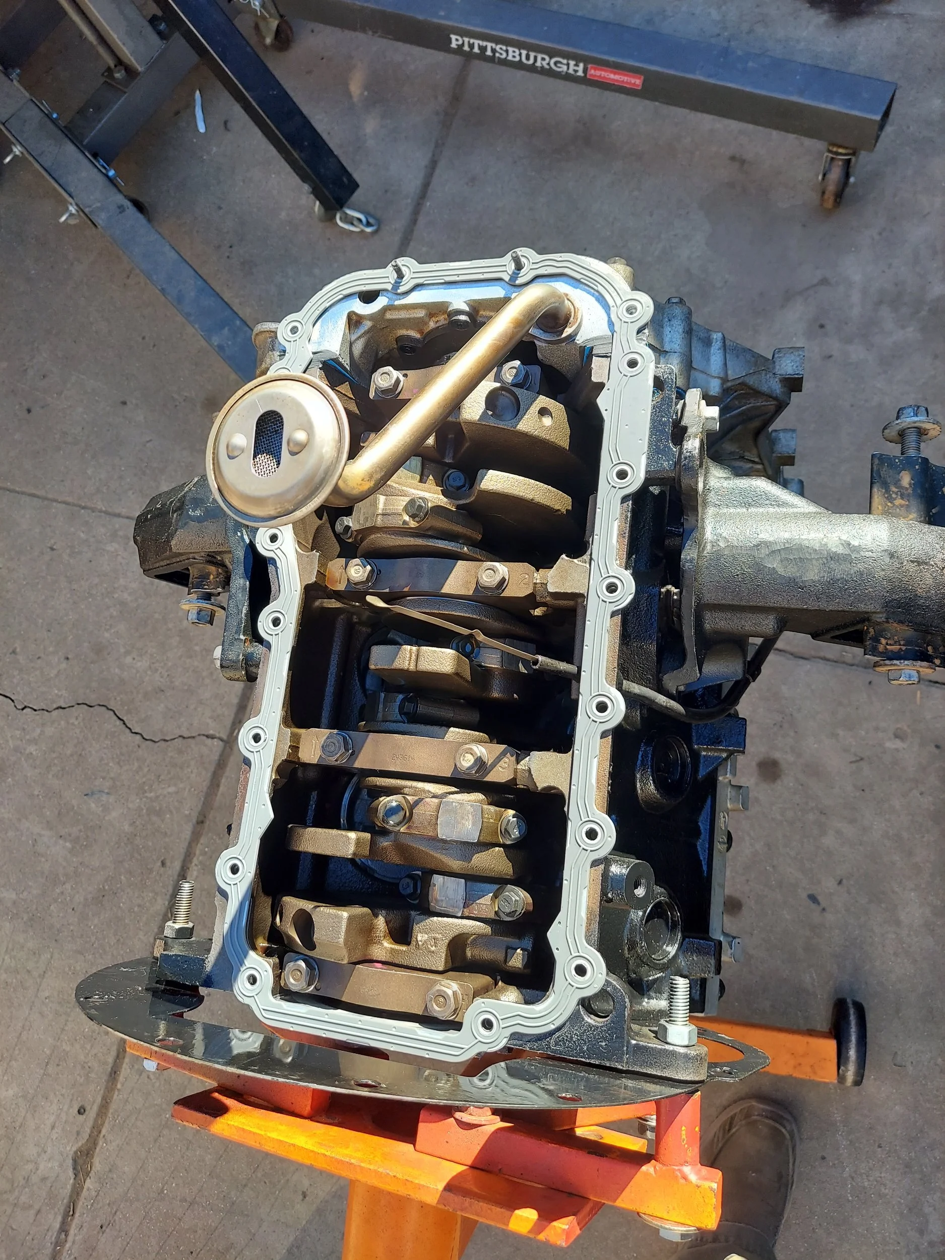

See the attached.
The good news is there is no cross member in your way.
The bad news. It sounds like you pulled off the oil PU tube when you were messing around with the timing cover.
I don't know how u could do that, There is a bolt holding it in place.
Could you have damaged the gasket when u were installing cover?
The oil pump is in the cover,
