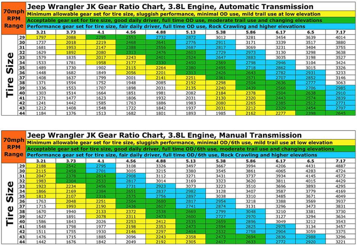

Take a look at this chart. Go out and drive your Jeep at each of the projected RPM levels. Decide what's ok, and use that gear ratio. You may well find that even a 4.56 gear doesn't make you happy.

What do you have in yours? Do you happen to have the 3.8? According to the chart, I would be running about 2400 RPM at 70mph. I don't think that would be widing it out all that much, do you?

Thanks for reply. I know that there is 40-50 HP less w/the 3.8, but I am also only running 33 vs 37. I bet the 4.56 would work fine. Thanks for the reply. However, there is not much difference in the 4.88 if I were to go that direction, I just don't want the engine to be wound that tight going down the highway either.

Looking at the rpm charts for my setup, I’ll take a slightly higher cruising rate for the torque offroad. I tend to avoid freeways because I’m retired and the slight time difference is more than made up for by seeing our country.
ETA: a couple hundred rpm is negligible in the grand scheme also.

You need it to be. If your engine is lugging because the RPM is too low, it'll just downshift. You need it wound up high enough to keep it in OD. Which, for the 3.8L, auto and 33's, means 4.88-5.13 gears.
