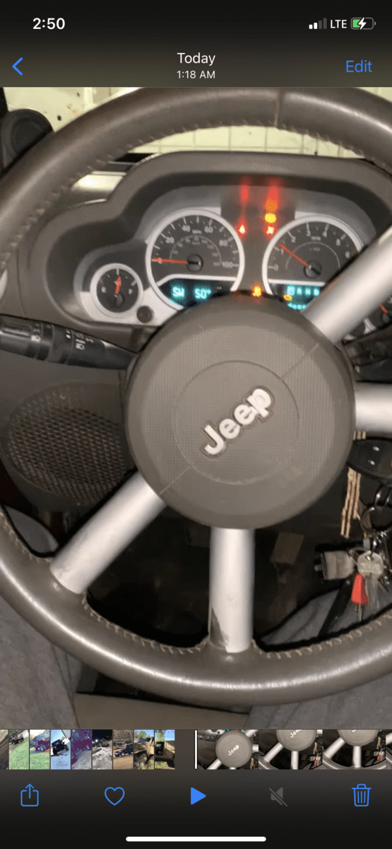

What Master Chief said, hoorah!! This happened to me, I took my 3.5" lift with 35s to a shop that was supposed to know what was up. Well when I got my Jeep back, the steering wheel was like the OPs in the pic and I was pissed at the dude. I yelled at him telling him I expected him to do everything that was needed to be done, not for me to take it somewhere else to fix his screwed up shoddy work.
