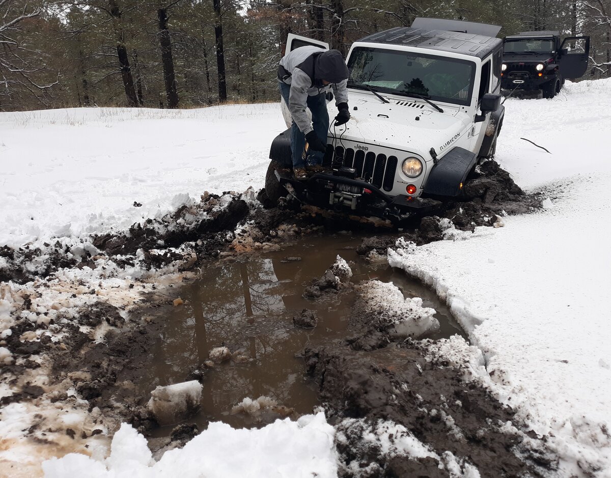

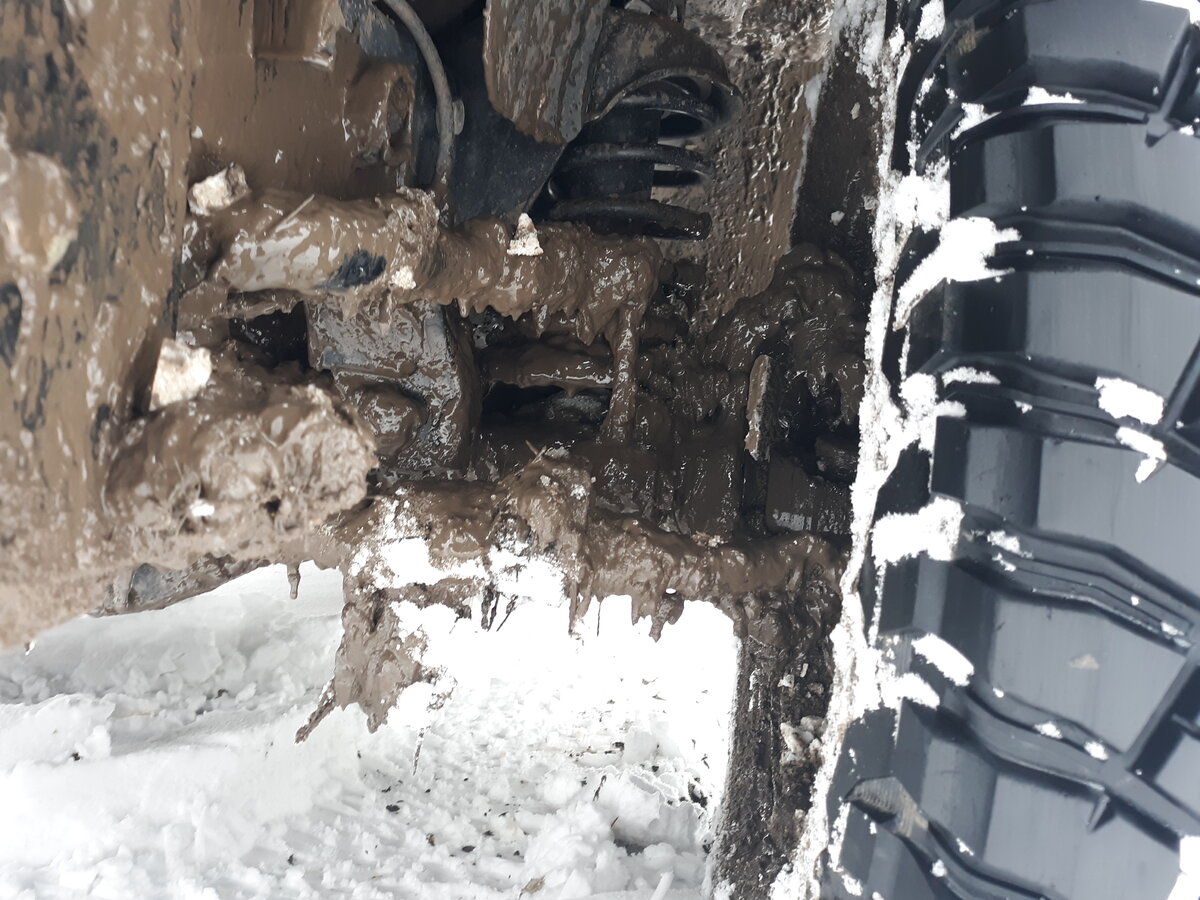

Something else to think about:
I slipped into a snow covered pond. The ABS, Anti-Skid and Cruise Control stopped working along with the appropriate dash light show.
Being lazy I ignored cleaning anything which was good as the wheel sensor is enclosed anyway. Now, a couple weeks later everything is dry and everything works.

Yea, after yesterdays initial light show it hasn't came back yet. Your pics are awesome by the way. In the one with you on the hood, the tension is tight on the winch and it looks as if you're about to take a dive lol
