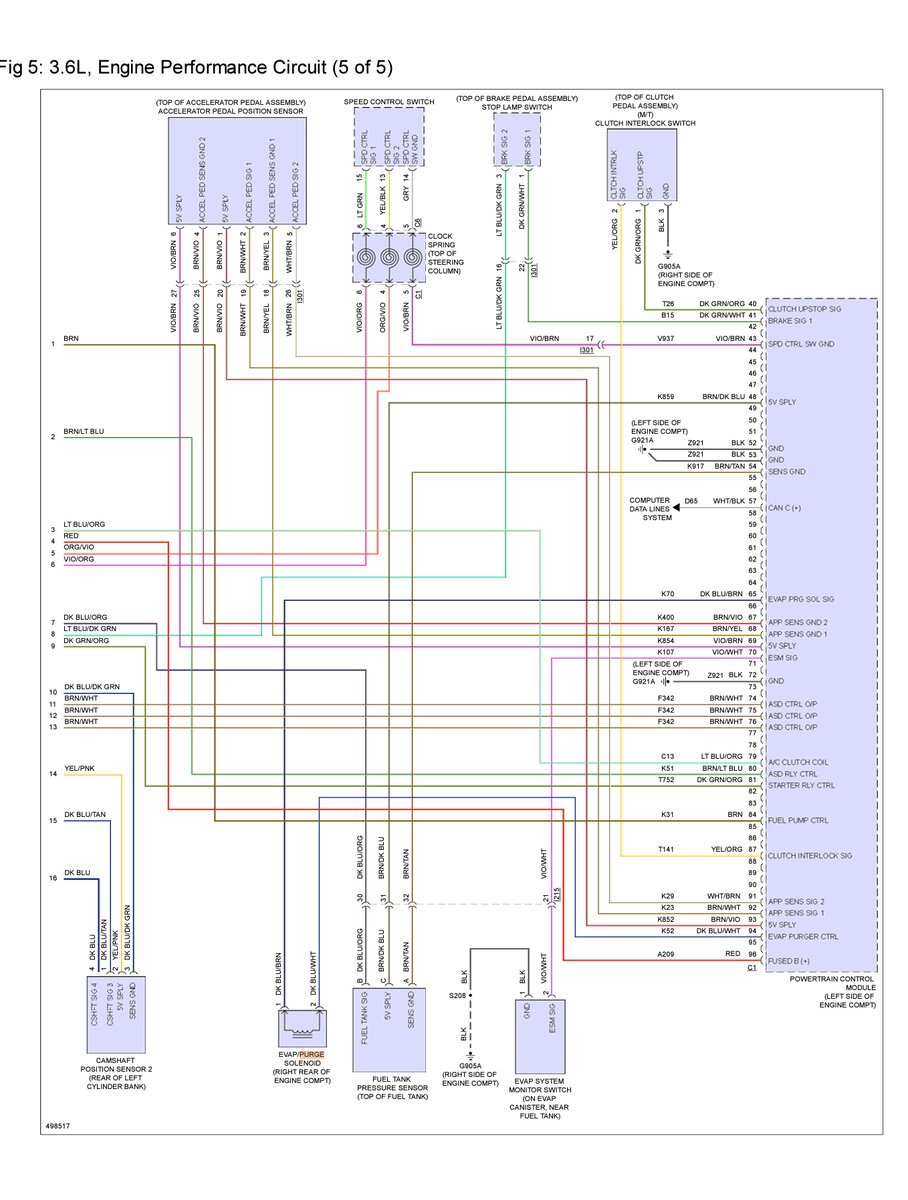

B2120 Run Only Input Circuit low
Came up while I was trying and failing to get to the bottom of a
Po443 purge circuit issue
Anyone have success with these I’d like my remote start to work again
Thanks
