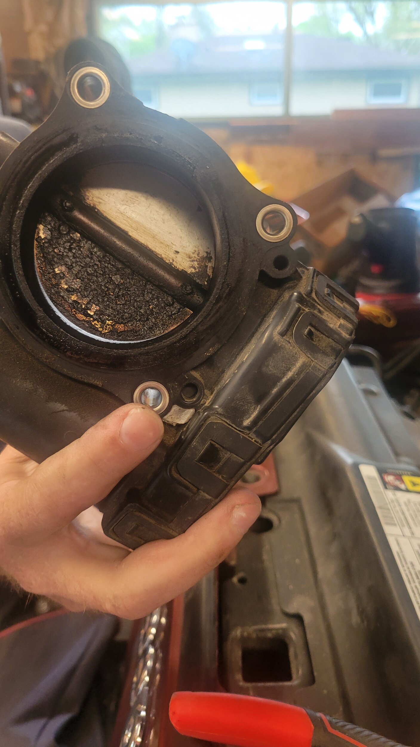

From what I have read, chrysler does not have a MAF, but they do have a MAP, but it is not necessary to clean them. We noticed the throttle body is pretty dirty. We are going to clean it. While I am sure it will make the engine happy, probably not the solution.

There are videos using Sea Foam to clean the TB's intake manifold, I know mine at 76,000 miles it had like tar stuff all over the inside of the intake manifold. I deleted my EGR valve i'm sure that's where it was coming from.
We still have my EGR valve. But we do have that tar like substance in there.
