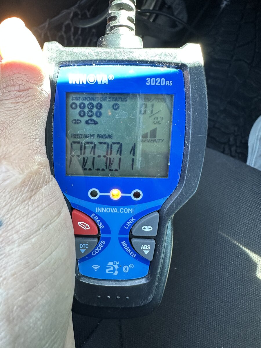

P0301 cylinder one misfire
selenarainie
Member
Aug 22, 2022
27
Sarasota, Fl
so guys, I threw a check engine light ran home put my code reader on it and now I’m pulling a P0301 code I swapped coil from cylinder one to cylinder to to see if it would follow and it didn’t so I then replace spark plugs, just to see if that was the problem it seems to be that none of those work, and I’m still throwing the code next option would be to look into injectors was wondering if anybody had this problem and found any solution without having to pull the injectors .
Reactions: Artisanau
I'm assuming you cleared the code and got it again, right? I got a P0300 “Random or Multiple Cylinder Misfire Detected” the other day. Never felt or heard anything wrong. I cleared the code and haven't seen it again.
