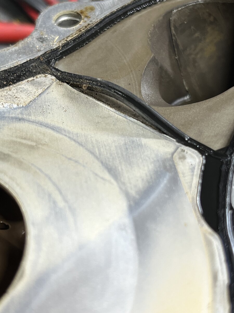

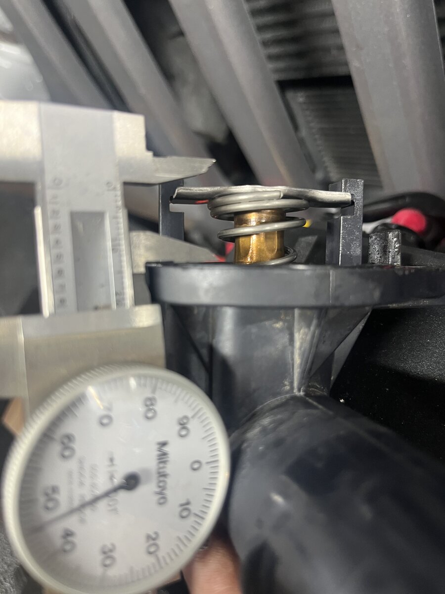

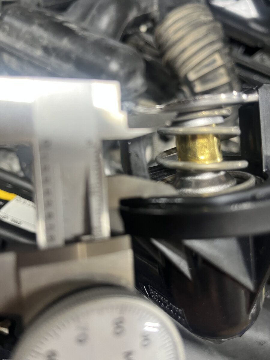

Update: Over heating solved, found water pump gasket seal torn and also discovered Napa brand thermostat which I installed had .285” less throw and .110” smaller diameter than the OEM thermostat. So aftermarket part was choking off a lot of flow. I have since learned there are 2 aftermarket thermostats that the socal dealers are using when they can’t get the oem one from their suppliers which is the Gates and Doreman products.

Sorry should have been more clear, I tracked down an OEM Mopar version at a dealership in Ontario CA. It was $100 but once I put it next to the Napa one it was shocking how much different it was in terms of throw and ID measurement. Once I replaced the water pump with the new gasket it still over heated at high speeds but seemed to be better than it was. But last night I took it on the freeway after installing the OEM T-stat and burping most of the air out and drove 85mph at over 4000rpm and never got past 231 degrees which would have been impossible before. I was getting easily to 260 at 3000rpm at 75mph now even runs at 205 around town.
