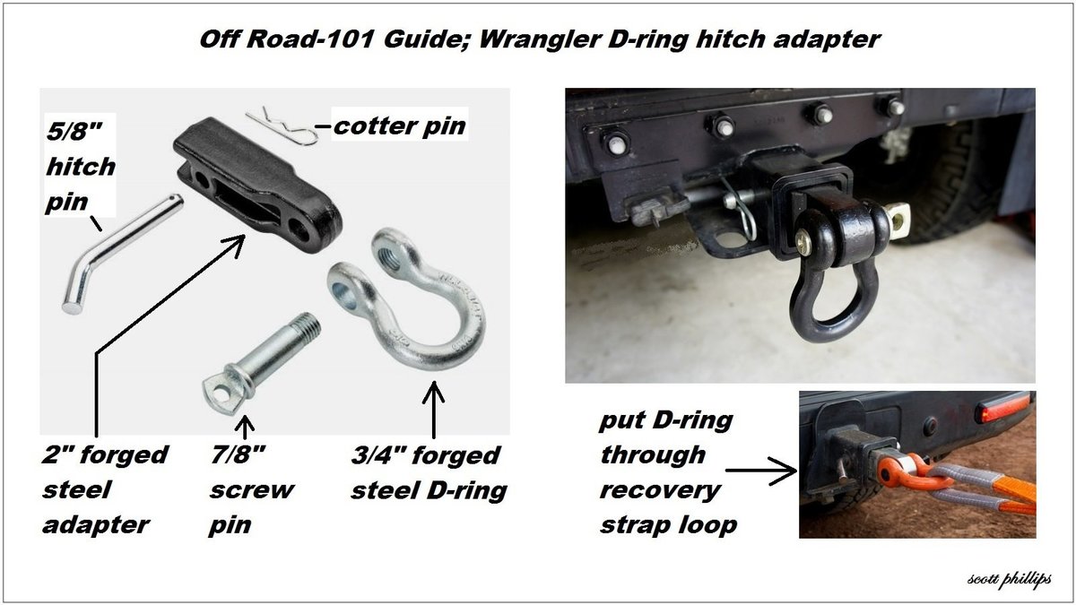

The only safe, heavy-duty pulling fixture on your Wrangler is the frame-mounted hitch receiver, equipped with a D-ring adapter.
Figure 2. Off Road-101 Guide; Wrangler D-ring hitch adapter.
Put the D-ring through the recovery strap loop and assemble the adapter as shown.
  • Only pull with a D-ring hitch adapter.
  • Only pull in forward gears. Pulling in reverse can damage the differential gear teeth.
When recovering a stuck Wrangler, keep in mind that the front "bulldog teeth" tow hooks are only meant for light pulling and tie-down, as they are bolted to the front bumper horns rather than the main frame. Additionally, Jeep does not recommend attaching D-ring tow hooks to the stock front bumper, as it is not sturdy enough to endure the stress of pulling the 4000+ lb. Wrangler. For the serious work of towing and recovery, the Wrangler needs towing base plates securely bolted to the front frame. These have 2" Class 3 hitch receivers that will accept D-ring adapters for recovery straps.
Pro Tip
Never attach any pull strap to a hitch ball. The ball can break off and become a high-speed missile.

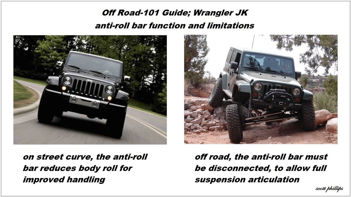

Anti-roll Bar Quick Disconnect
The anti-roll bar is commonly called a sway bar, although its purpose is to minimize sway or body roll.
Figure 3. Off Road-101 Guide; Wrangler JK body roll and suspension articulation.
The Wrangler JK has front and rear anti-roll bars. The bars connect the left and right wheels together through the frame in an effort to force each side to remain level with the other side. On pavement, this minimizes body roll in curves and provides more handling stability. However, the anti-roll bars prevent the suspension articulation needed to keep all four wheels on the ground when off-roading.
Some off-roaders will remove the 12mm bolts in the front anti-roll end-links and replace them with smaller 7/16" clevis pins that can be quickly pulled to disconnect the front anti-roll bar on the trail. However, there are many great aftermarket end-links with quick-disconnects that are easy to install and use.

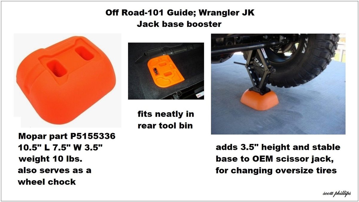

Jack Base Booster
This Mopar jack booster fits into the rear tool bin of the Wrangler and provides a sturdy platform for the OEM scissor jack.
Figure 5. Off Road-101 Guide; Wrangler JK, jack base booster.
Jacking a Wrangler in the dirt, rocks and mud is always a demanding operation. With its slow-acting screw mechanism, the OEM scissor jack is one of the safer options for basic tire changes, and the Mopar base booster provides it with a wide, stable platform. Adding 3.5" provides enough height to change 37" tires. A second base booster can also be used as a wheel chock.
Pro Tip
Although the high lifting, extreme recovery jacks look cool and purposeful mounted to your Wrangler, they are best used by highly experienced off-roaders. One misjudgement or slip with an extreme recovery jack can suddenly turn a temporarily immobilized Wrangler into a dire medical crisis while far from help.
