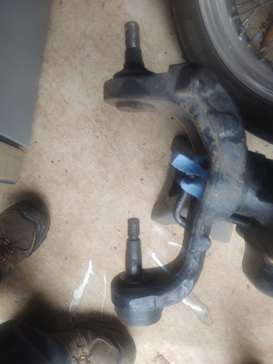

Ok...doing a Dana 30 to 44 swap...the 44 is off a Rubicon...2008 I believe...mine is a 2012...44 has factory e-locker and is geared 5.13...

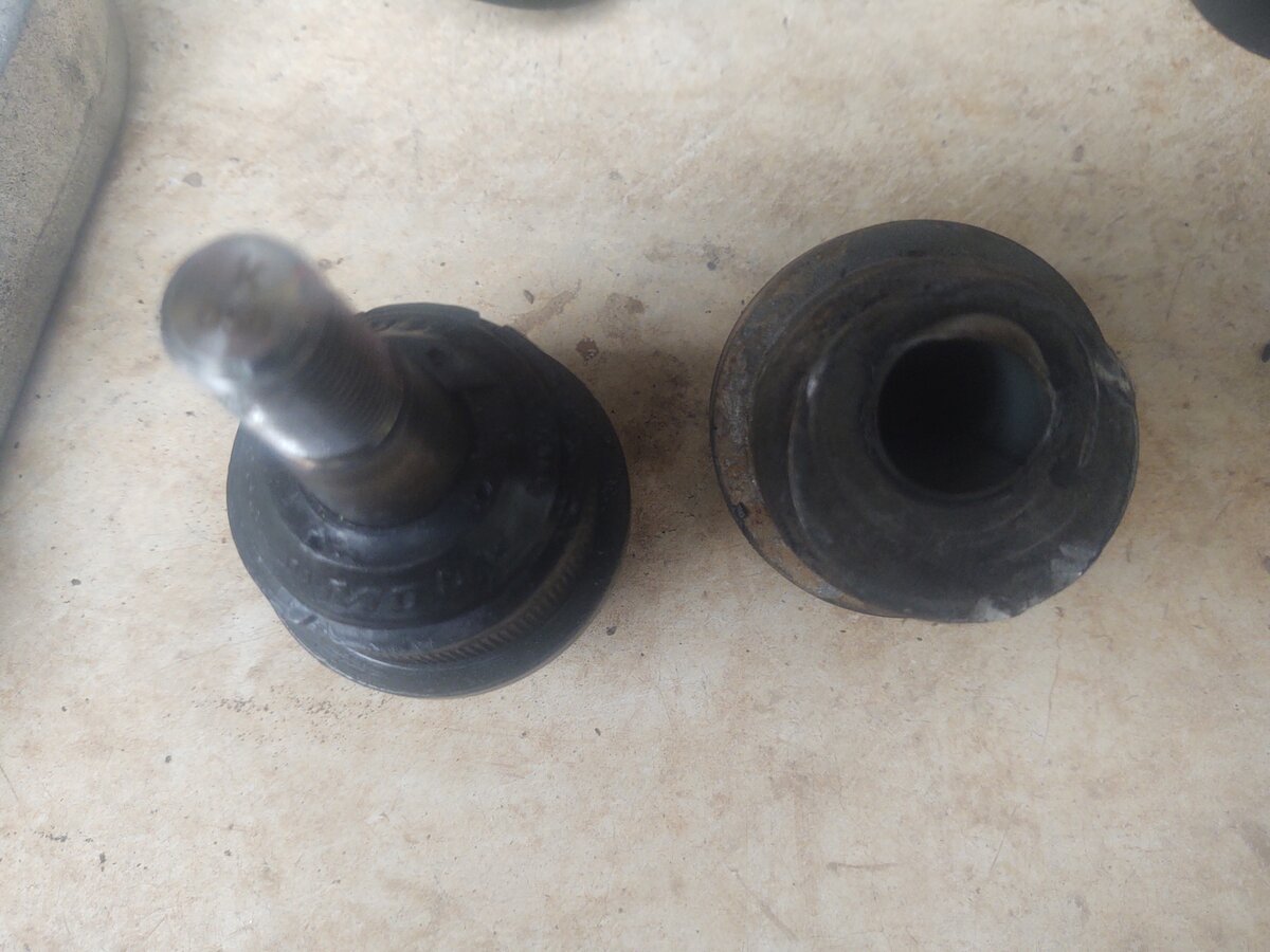

Here's the issue...my 30 has straight up centered ball joints.
The ones on the 44...top...are clearly in a couple of degrees.
Do I press ahead with the Moog centered ball joints or do I need to find like replacements... concerned the housing is bent (looks straight) and someone compensated with ball joints.

It's either tweaked, or they were correcting caster/camber by an unusually large amount. Did the JK have a circus wagon lift?

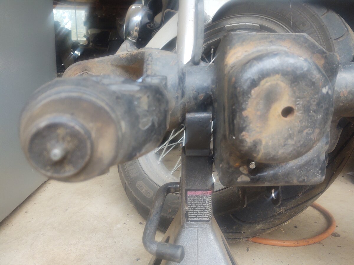

I ordered some C guessets from Barnes and I'm going to make a jig out of my Dana 30... guessing I will need to heat the top of the C and bend it in.
Also thinking about just replacing the inner C... getting a builder end for a 44...but I'm not sure if I could get it off the original tube.
Something tells me some heat, gussets and proper welding procedures will get me close enough.
-Mac

It looks like the C is bent . The 30 & 44 have the same C . My only concern
is the Jeep is sensitive to Castor. If out by 2-3 degrees can cause vibration
or worse , the wobble.
After welding on gussets and putting it all together .
Def suggest good alignment shop to see how things look.
You want 4.5 degrees of castor .
