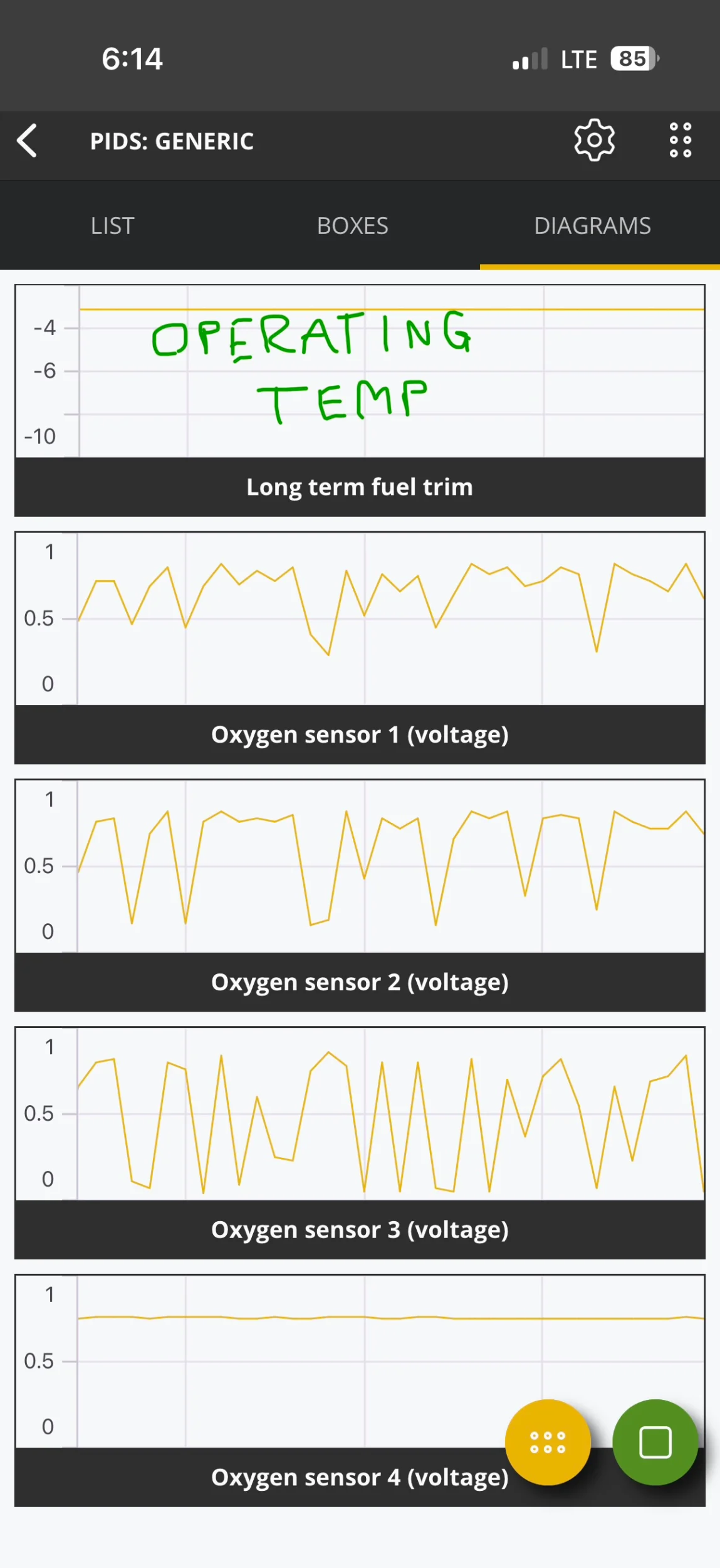

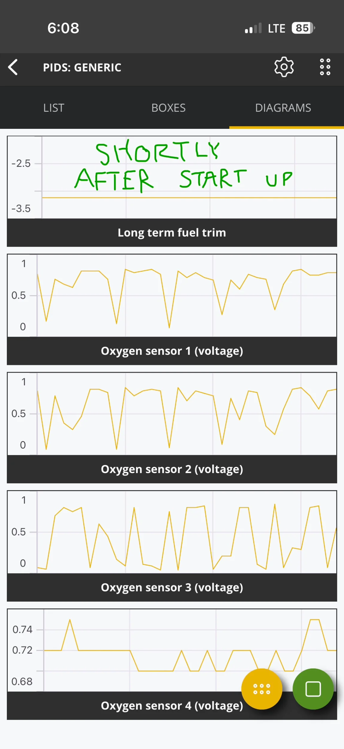

CEL P0420 code
100k miles
Replaced the downstream passenger side sensor, no change.
Looked at the live data and it makes me wonder if I replaced a bad sensor with another bad sensor?
I didn’t look at live data with the old sensor, so I don’t know for sure.
Oem cat on the way if it turns out to be that.
It's probably the cat, mine crapped out at 120k miles. Instead of replacing, I just put on two extenders and the codes went away. Jeep still drives perfect with no MPG loss.
