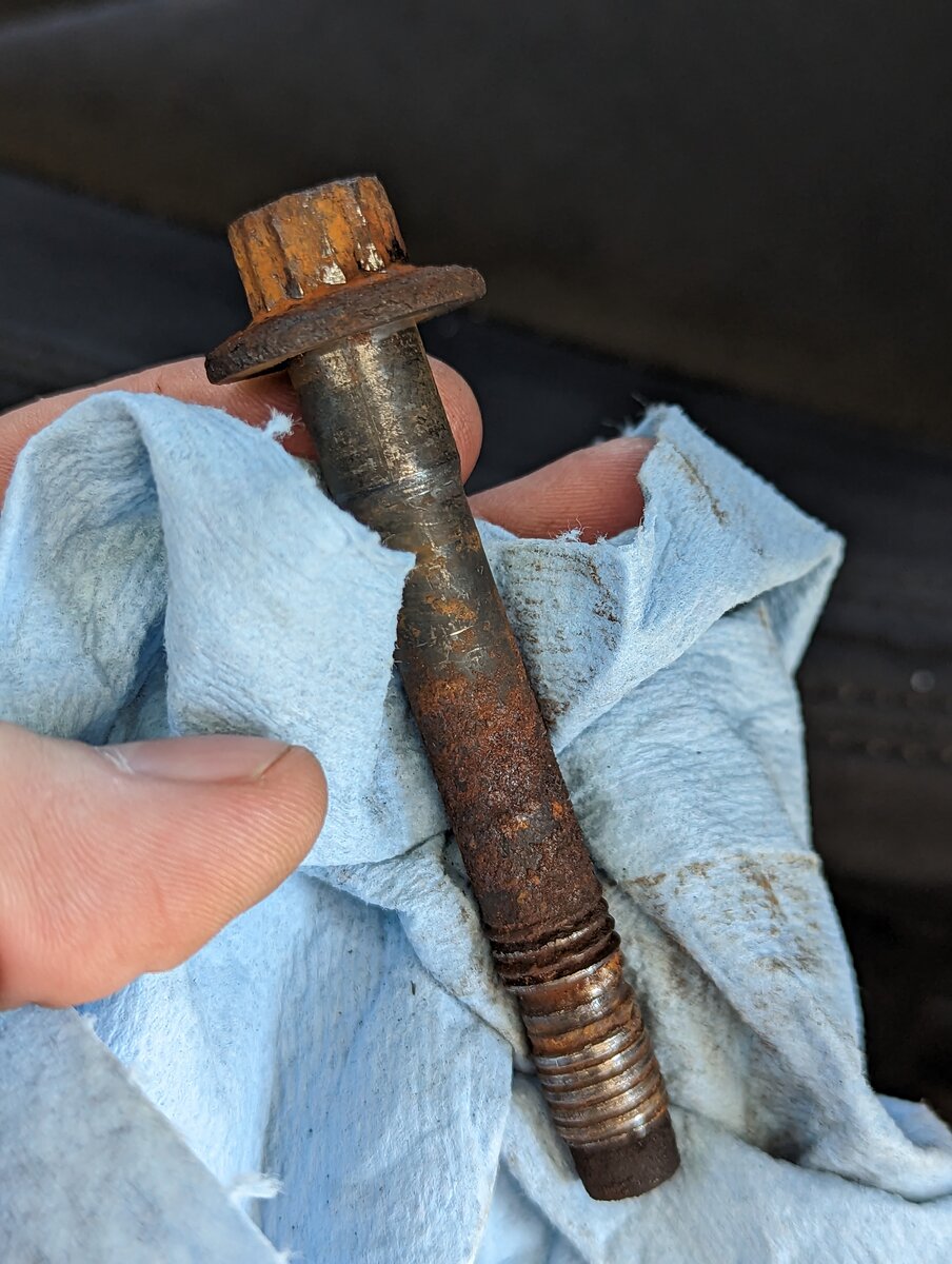

Oooh. Dodged a major headache. This is one of the unit bearing to knuckle bolts.
Stretched it a wee bit...
