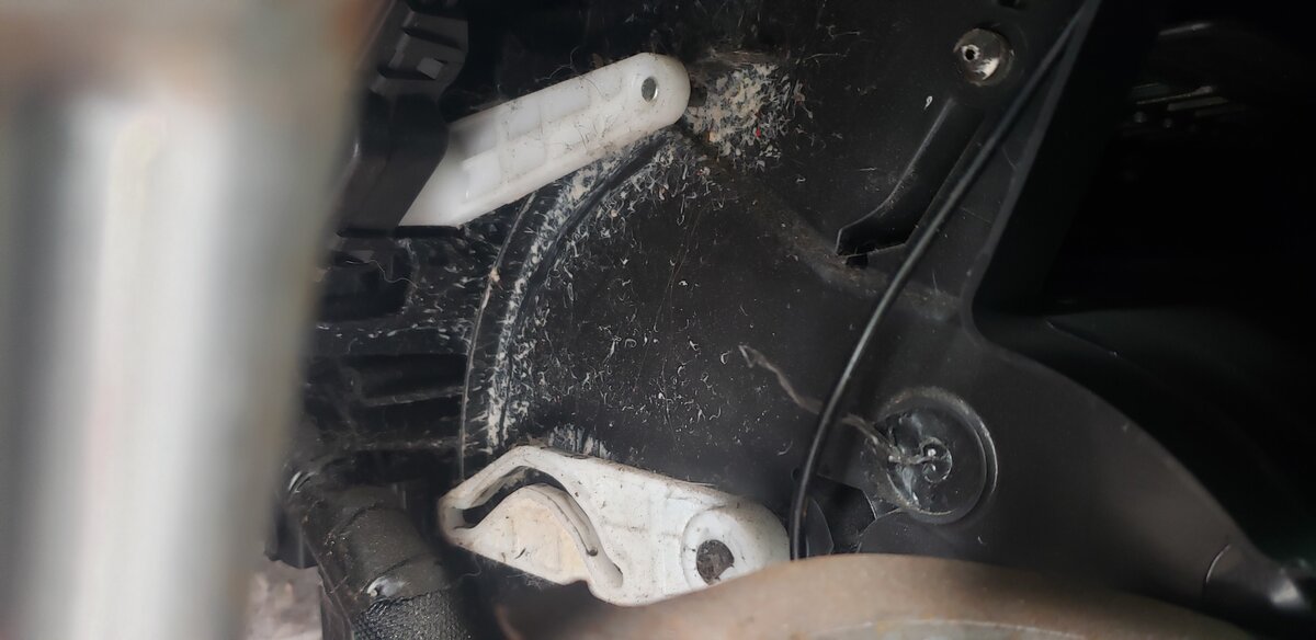

Last weekend(a week after surgery, still couldn't drive), I did a one-armed dash removal and radio change(JVC KW-M150BT, 7 in display...meh). Felt up to driving today, but on our way out, noticed that the heat was blowing ice cold. Got back home and checked all of the usual suspects: radiator was full, both heater hoses were hot to the touch, blend actuator opened and closed according to temp selection. Checked the pins and circuit board on the a/c control, all straight and no signs of arcing.
My only thought is to find a known-good a/c control panel and replace it
Although the weather is turning warmer and this won't matter for another 7-8 months, I'd like to get this fixed before putting the dash back together 100%. Chilton manual is 0 help. Anyone have any ideas?
