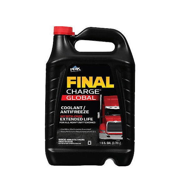

I saw this in another thread, is this coolant ok? Can't find the correct Mopar coolant in stock anywhere, and Service is all closed until Monday.
So to make things worse, it appears it has the wrong coolant in the radiator, it's bright red. This tells me it may have been filled at some point with the Mopar HOAT coolant, unless there's an aftermarket brand of OAT that's red. Either way I'm going to take it back and have them do a flush & fill with the correct coolant.
Mark
The important thing about the coolants is that you aren't mixing them. As long as you're using all of the same coolant, you'll be fine (y)
