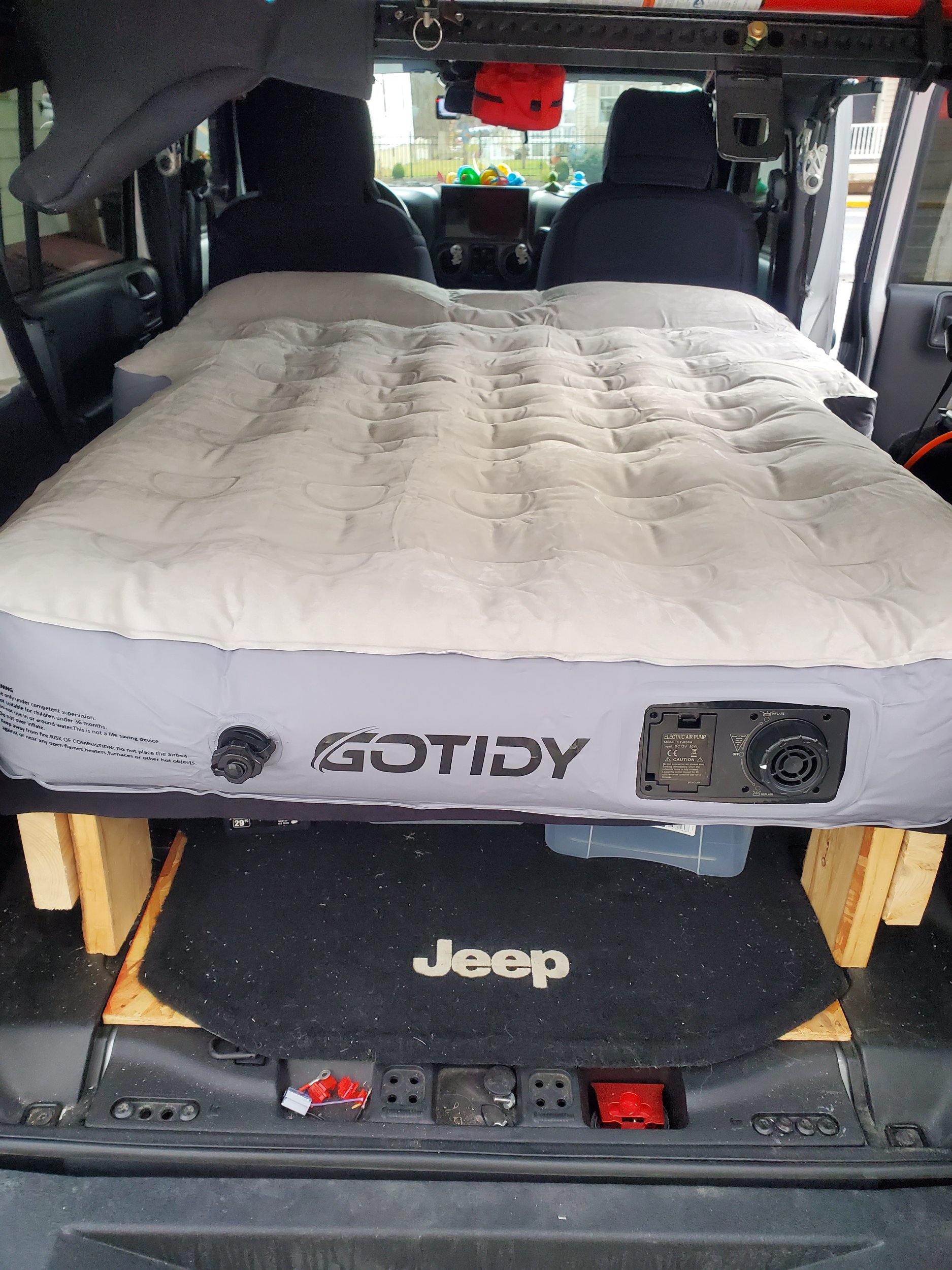

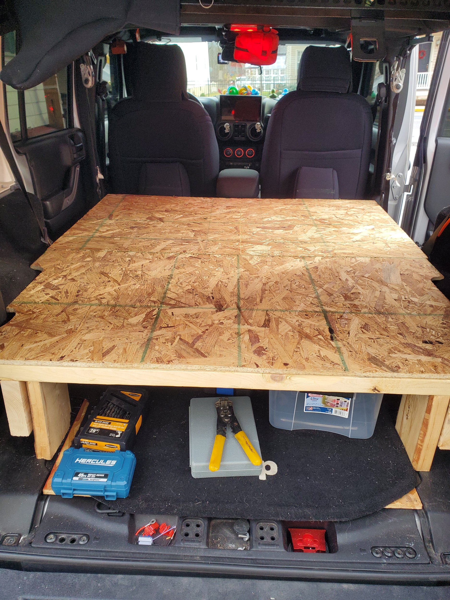

So far, I wouldn't change anything with my rig and setup. I built my sleeping platform so I can still keep the rear seats and be able to still setup in minutes. My platform is high enough to keep small totes of camping gear and food under it while still leaving enough room for my inflatable air mattress on top. My tailgate table is perfect for my 2 burner Colman stove when a fire is not allowed. I also have the AT Overland propane tank mount to feed the grill. Keeps the need for those 1lbs bottles at a very minimum if at all. I've slept in -2°F with snow and in 80°F at night. I have a little buddy heater I modified to keep me warm in cold nights. I also made a solar window fan to keep me cool at night too. Right now I'm saving up for a roof rack and a 270° awning. I'm really happy with my setup.

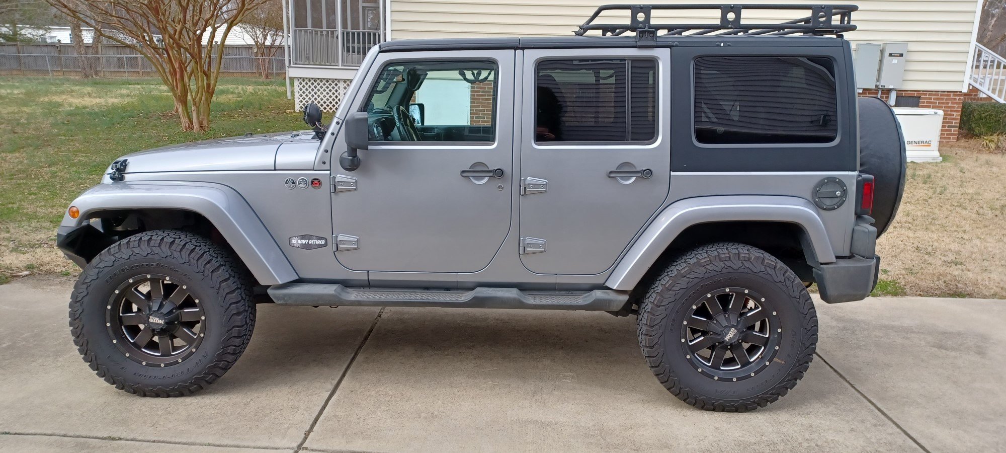

I failed to tell you guys I have a 4 door wrangler
6in lift
JKS quicker disconnects
37x12.50r17 tires
17" Bawarrion beadlocks
Smittybilt Stinger front bumper rear bumper
Smittybilt red D-rings front & rear
APEX winch
Auxbeam yellow pillar, bumper & knuckle lights
Auxbeam headlights
Gatekeeper knuckle light mounts
50" lightbar
Limb risers
Smittybilt magarmor
Deegan38 side step/sliders w/ KC puddle lights
Dana 30 truss kit
Dana 30 SOLID diff cover
Cobra CB but swapping to Midland 50 watt GMRS soon
I know im forgetting some other things but those are most of them.
Steel/Aluminum Flat fenders are on the list of next mods. I have popped the front and rears off at full flex.
Pictures of the platform / sleeping area? Been thinking about options for trips we might want to head up the night before hitting the trail.

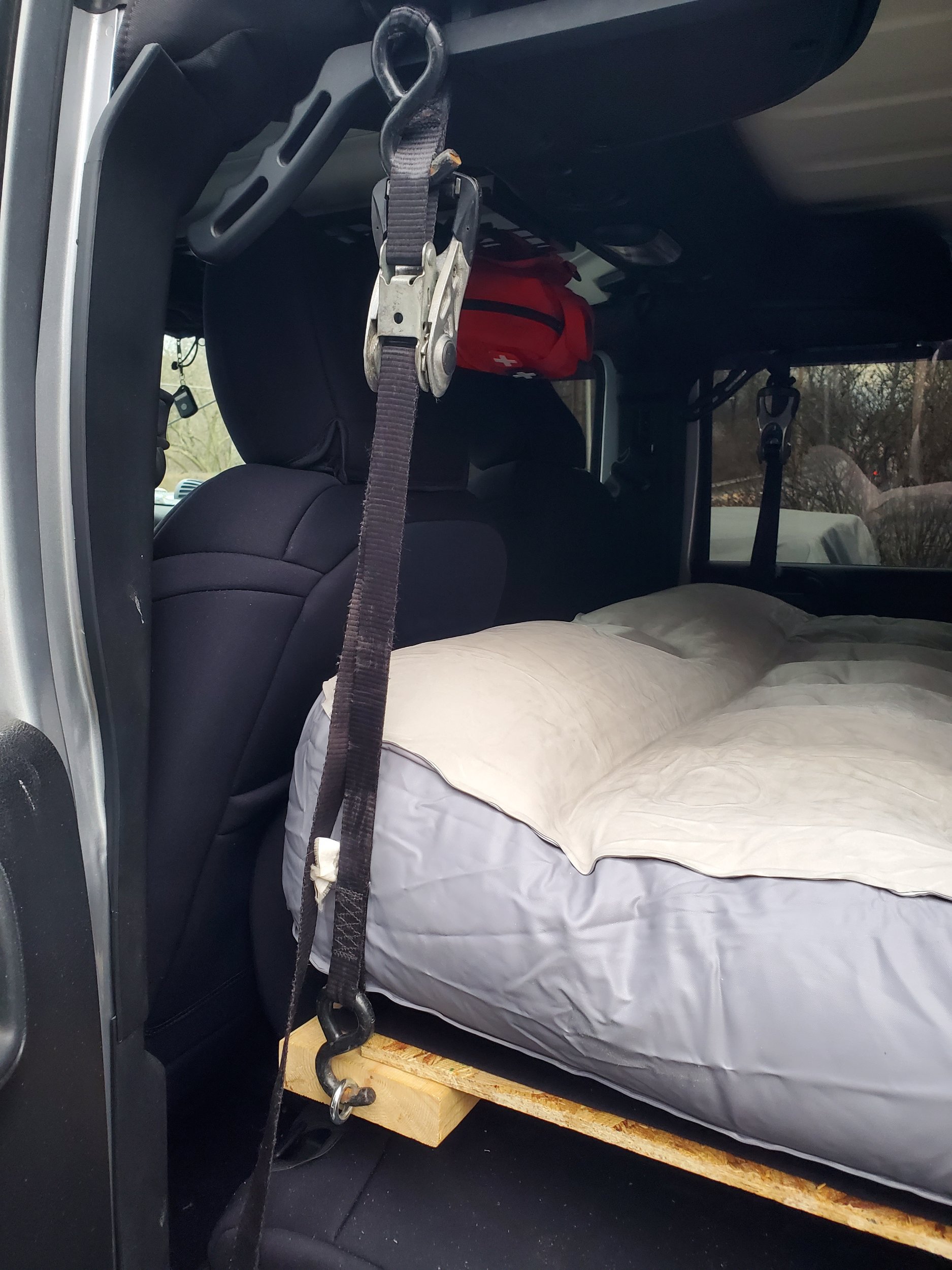

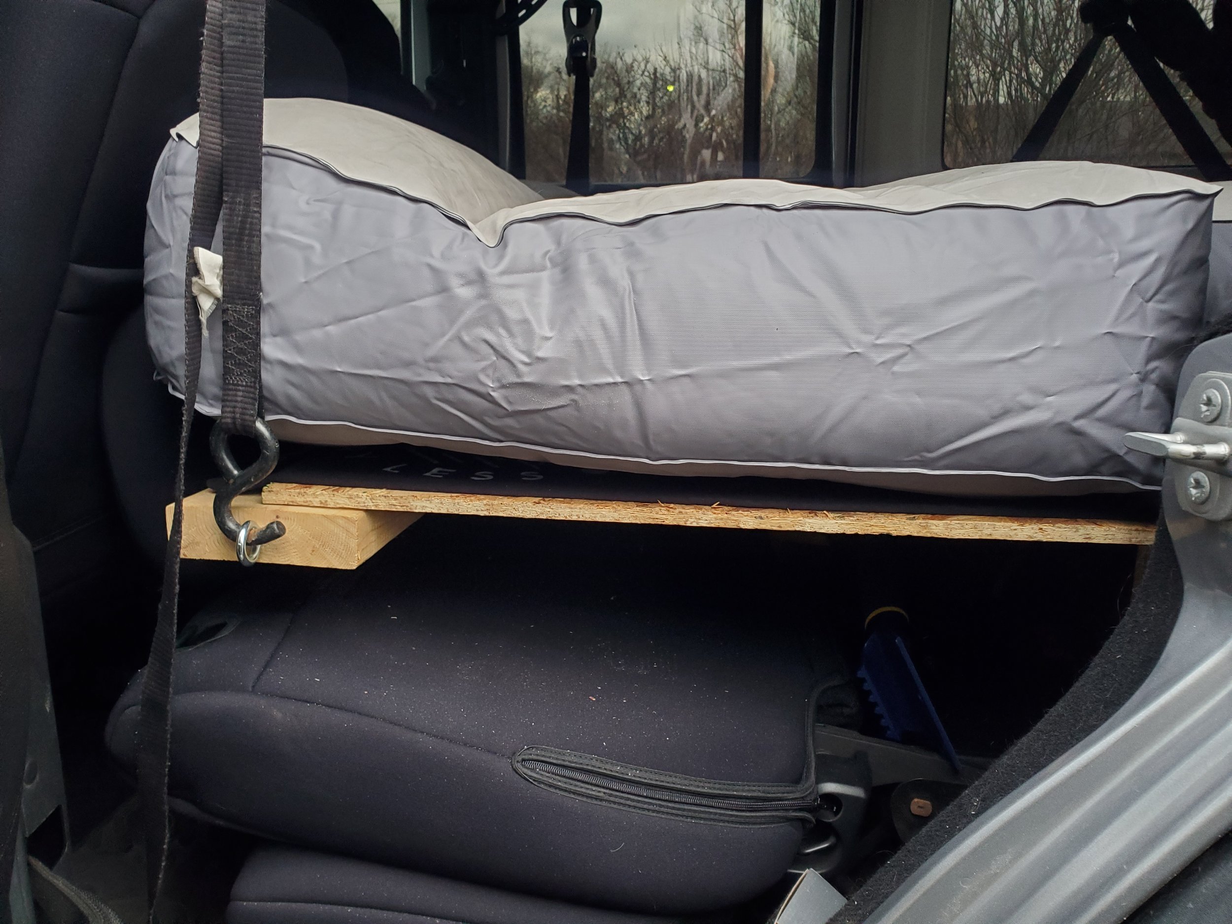

All the wood is covered in speaker box carpet. The rear platform is bolted to the floor. The height of the platform was based off of my totes so i was able to keep totes stores under it when overlanding. Everything is able to disassemble and stoe in the Jeep when not in use. Everything cost me like $28 and that was for the carpet. The wood, screws, and 3M spray glue was free from my work.

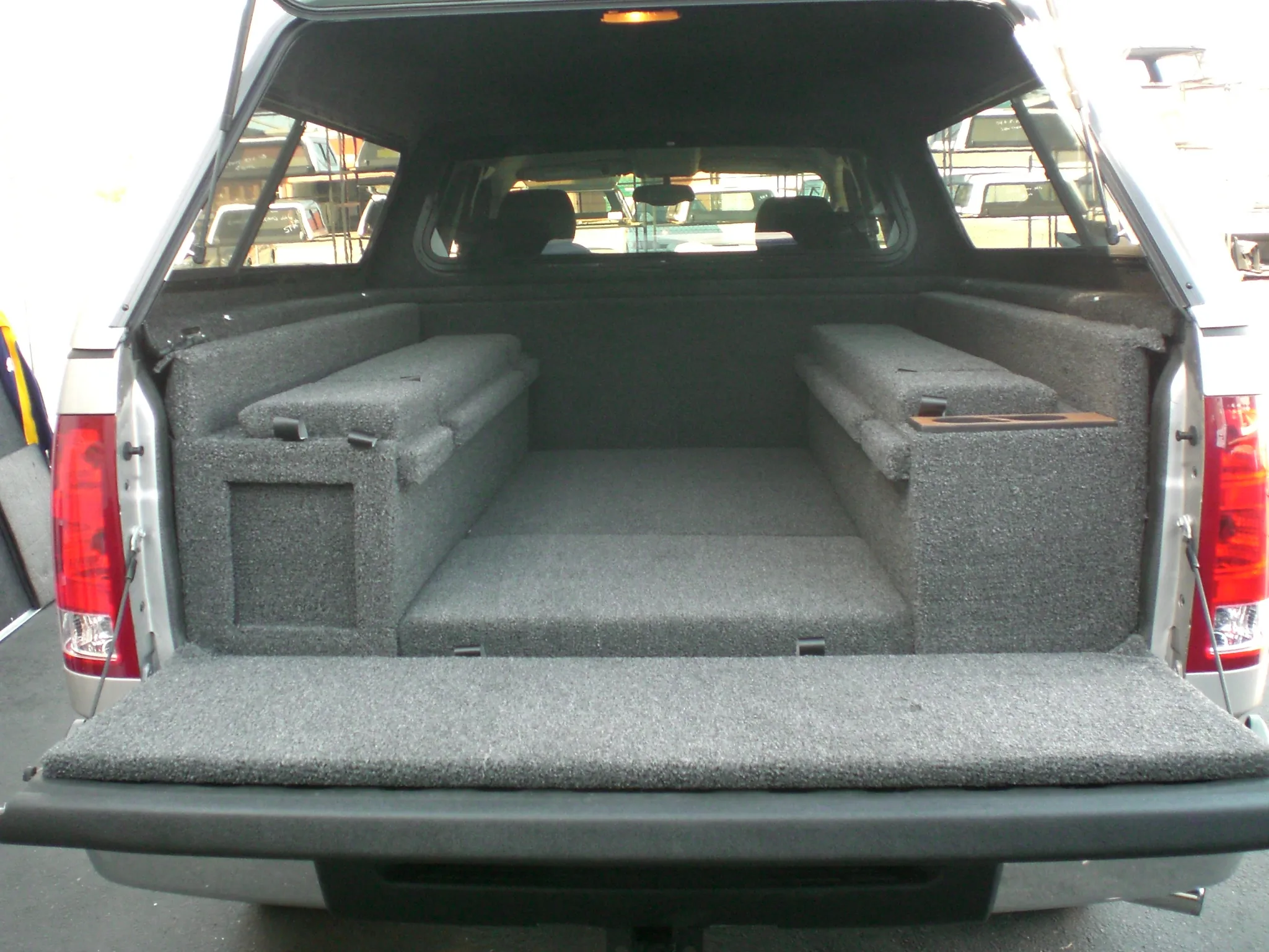

This is what I had back in the 80s. Owned a 1980 Toyota pickup longbed with an insulated camper shell. These carpet kits were all the rage back then. The seat cushions are hinged so you have storage inside, and when you set the floor boards up for the bed, storage underneath. Was a good night sleep, too on what is a little larger than a queen size bed. This is a current version offered by SoCal Trucks, but it's the same set up I had 40 years ago
I camped all over the California and Oregon coast with this and loved it. The camper cap was aluminum, insulated with smoked plexi windows, roof vents with a boot thru the sliding rear cab window, wood grain interior... I miss that truck!
Thank you. I like how you supported the portion over the rear seats. I assume that portion is completely removed when not in use? It doesn’t look like you have it folding over onto the rear cargo area.
Thanks. The boards on top of the rear seats are cut to mimic the seat split and just lay on top of the rear part that's bolted down and on top of the 2x6. When not in use, the 2x6 and straps are under the rear seat and the boards are layed across the rear and I use a cinch strap to keep them in place. Hope this makes sense. If not I can take some pictures to show what Tim talking about.
