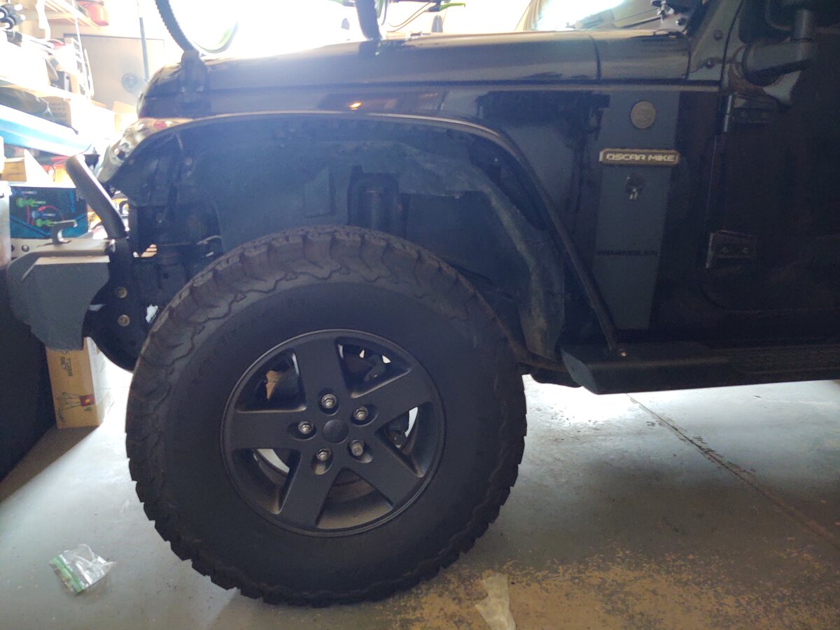

Interesting that your size tire is fitting on the vehicle with stock wheels. I will have to change the advice I've been giving. Can you post of pic of the exact stock wheels you have please? Stock image is fine.
I ask for the simple reason, that when I tried to put on the slightly smaller, but same width tire of 285 70 17 on my 2009 rubicon U, they couldn't be put on the vehicle at all. I don't remember exactly what they impacted but it was the rear tires. Stopped operation and went back to old tires for a week until I got new wheels.
These where the ones I had, and I'm fairly certain that all JK wheels (except for the 16" basic ones) have that 7.5" width, and all have something around 6.25 backspacing, all the same. To me this means that there was a change of some sort in the rear wheel hub area that allows for wider tires on stock wheels, possibly when they switched to the 3.6... Hmm.
Sorry it took so long to get back to you, been extremely busy at work. These are the stock rims on my 2016 Oscar Mike with 285/75/17 BFG KO2'S
We just picked up a 2015 Sahara yesterday. The tires are on the factory 18” rims. The tires are 275/70/18. They hit the sway bar on sharp left and right turns. My wife says she likes the tires and doesn’t want them changed out. We have the factory fender flares. I see yours are flat aftermarket flares bit do you know if the tires rubbed the fenders when off roading? Or did you swap the fender flares first?
I have a 2" Spacer lift right now so the tires never rubbed the stock fender flares. Also these are not aftermarket flares, I just cut and trimmed the stock flares.
You did a great job trimming them. How do you like the spacers? Did the change the ride much? Guess they are solid enough, stay in place and work when four wheeling? Never tried them before.
