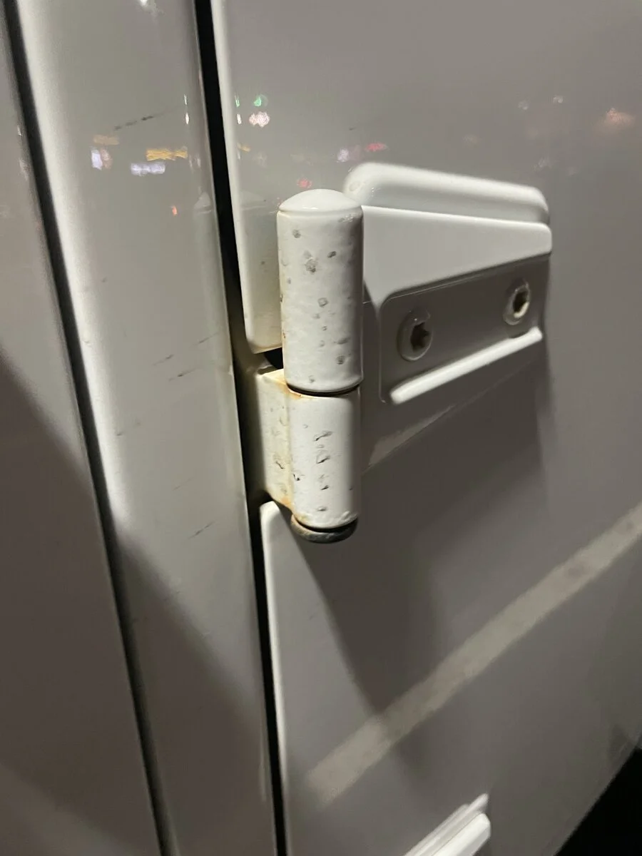

We just bought my 2018 JKU about 2 weeks ago. It was previously owned for about 15 months in Hawaii, then it spent the rest of its life in Cali, it has only been in NV for a couple months. Knowing it had been near the ocean we were aware that we needed to be cautious of rusting and corrosion. We see the start to some beginnings of rusting at the hinges on all the doors, but I already knew I wanted to replace those when I started modifying so I know we can remedy that pretty easily. I am wondering if anyone knows of some type of preventive wash/spray/etc that we can use on my JK to stop any issues that maybe we can’t see as easily or inhibit any rust from spreading. Just want to take preventive measures to keep her from having issues later.

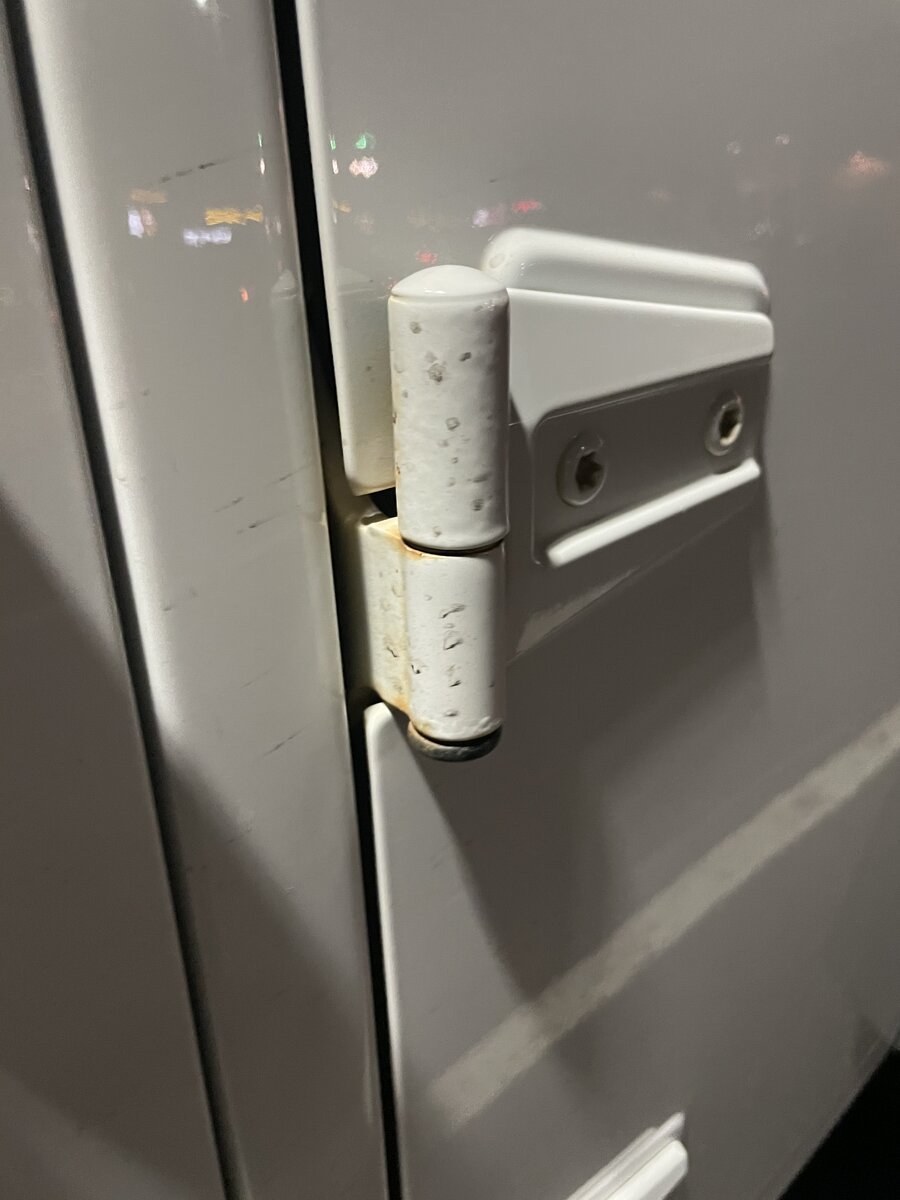

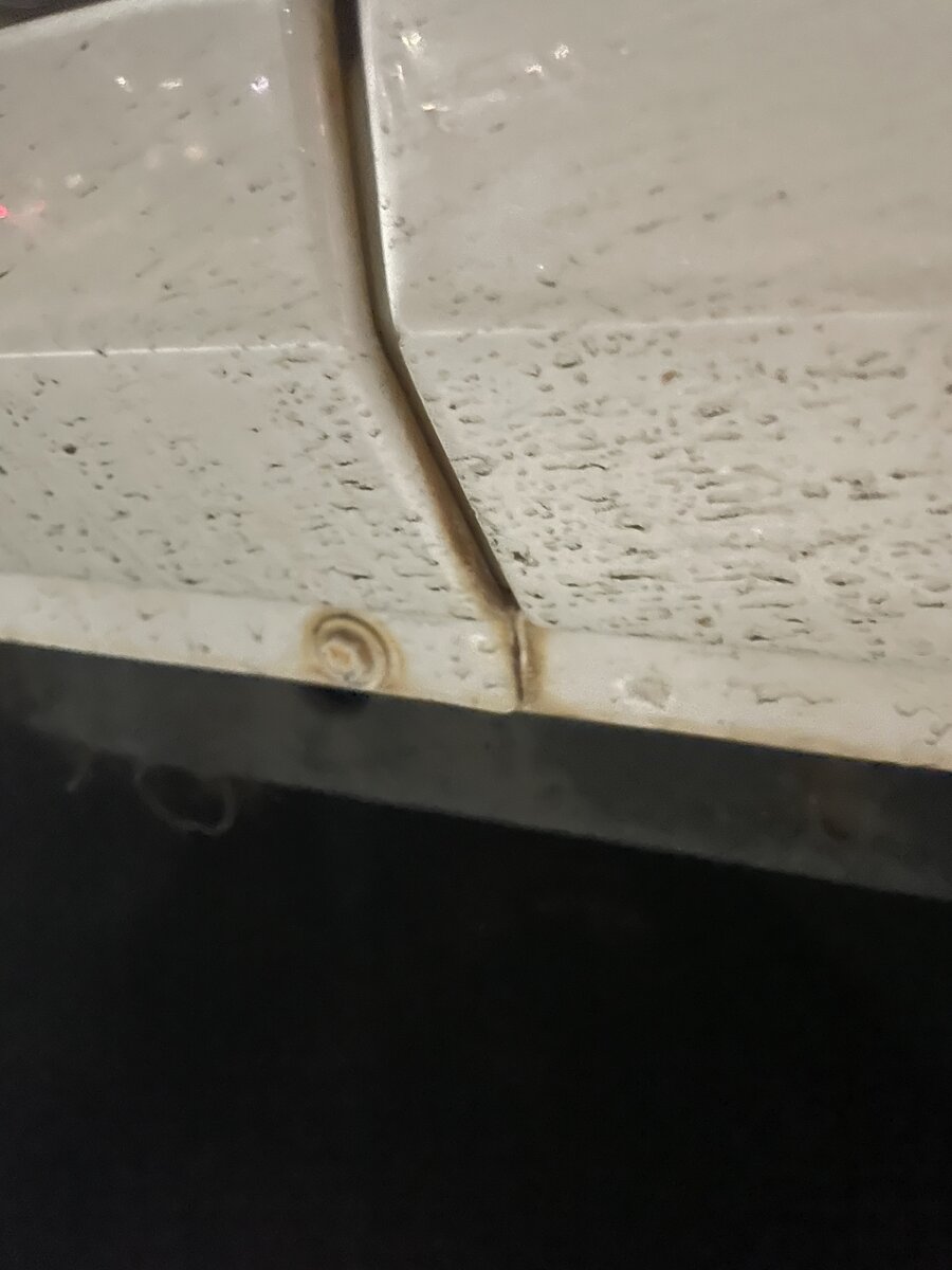

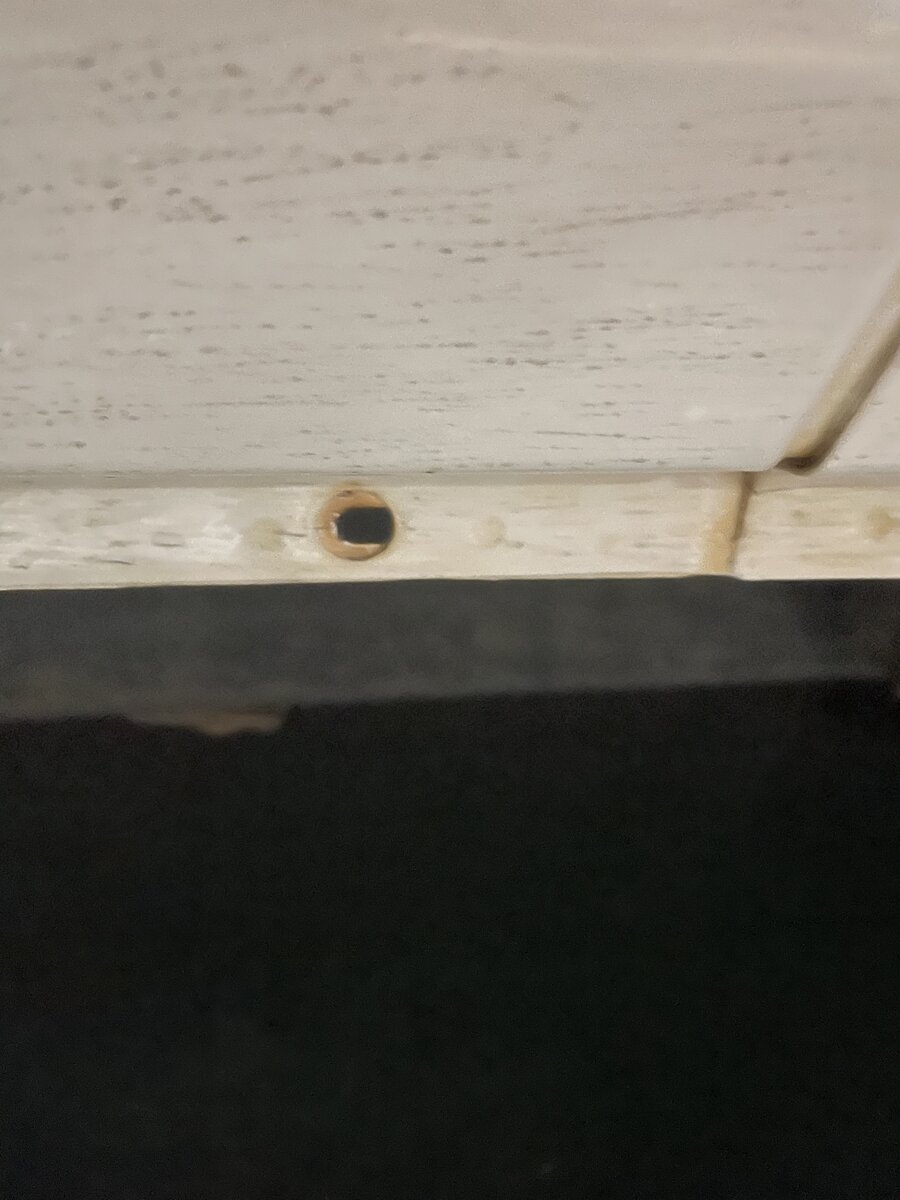

Here are a few pictures I was able to snap this evening in some commercial lights. Every hinges on my JK looks like the one I posted.
Fluid Film. I spray it on and in my frame rails. As well as apply it to surfaces, like rocker panels, using a rag. I’ve also applied WD40 on joints and inside crevasses all over my Jeeps. That rust in the hinges is due to lack of lubrication.
Another fantastic product (which is really an acid) is Rust-Oleum ‘rust dissolver’. I’ve applied that to frame areas, cleaned it, then preserved the area with primer and paint, and interior locations that I could not paint, with Fluid Film.
