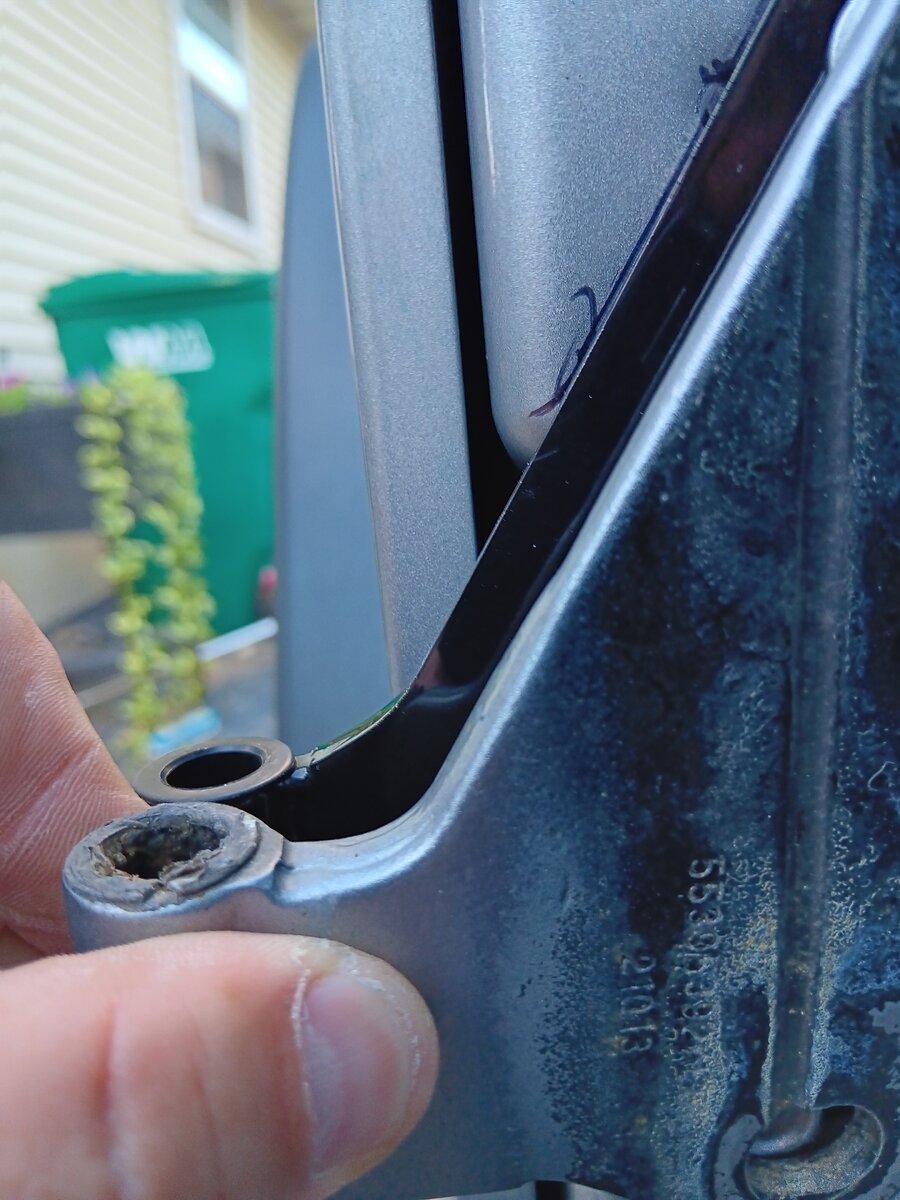

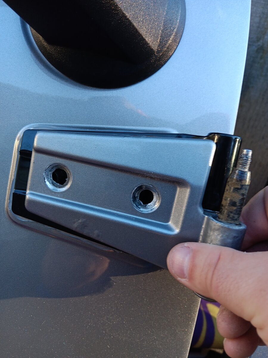

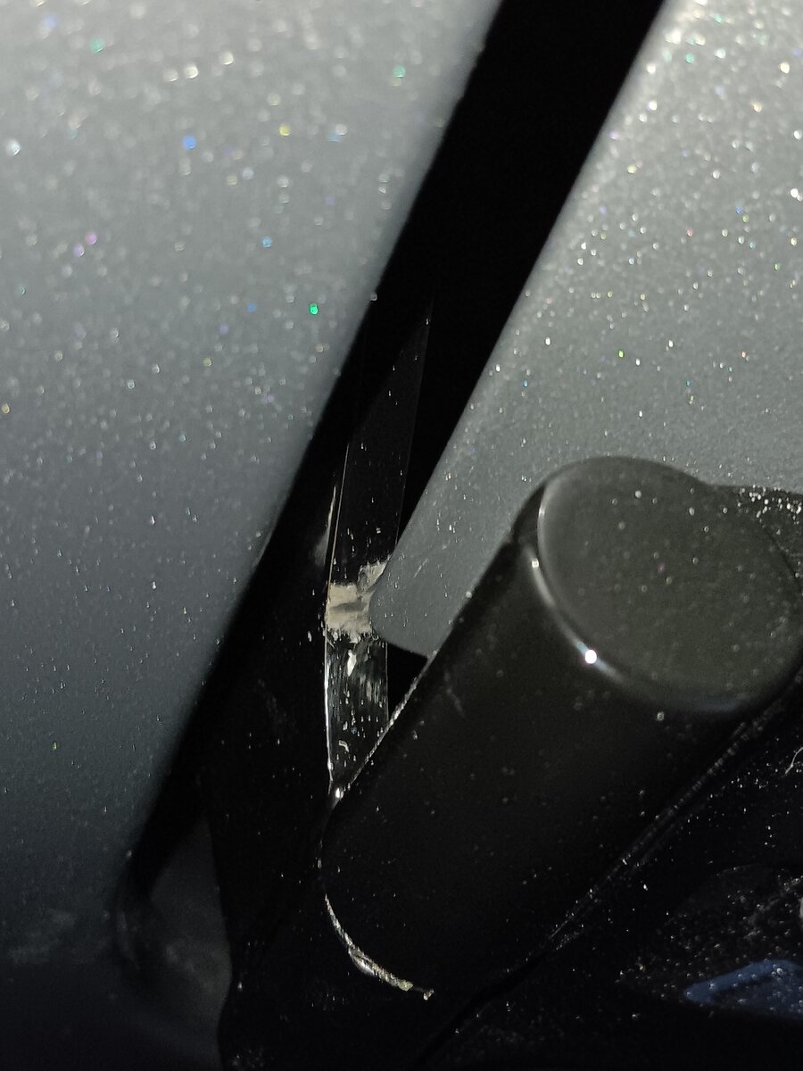

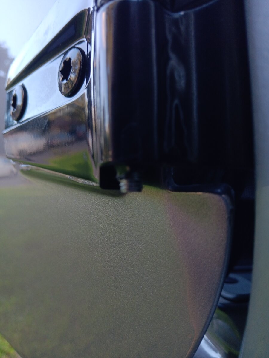

I bought the big kit off ebay....I don't suggest it they are and quater inch bigger everywhere....the inside hinges don't have the angle for the door clearance to open and close bent the rear corners and rubs on all the other....Idk what ima do try to return and refurbish my old ones or cut and make these work now.....buy beware of aftermarket....now I gotta go to a dent shop
Send them back and refurbish your old ones. My 2 cents.
