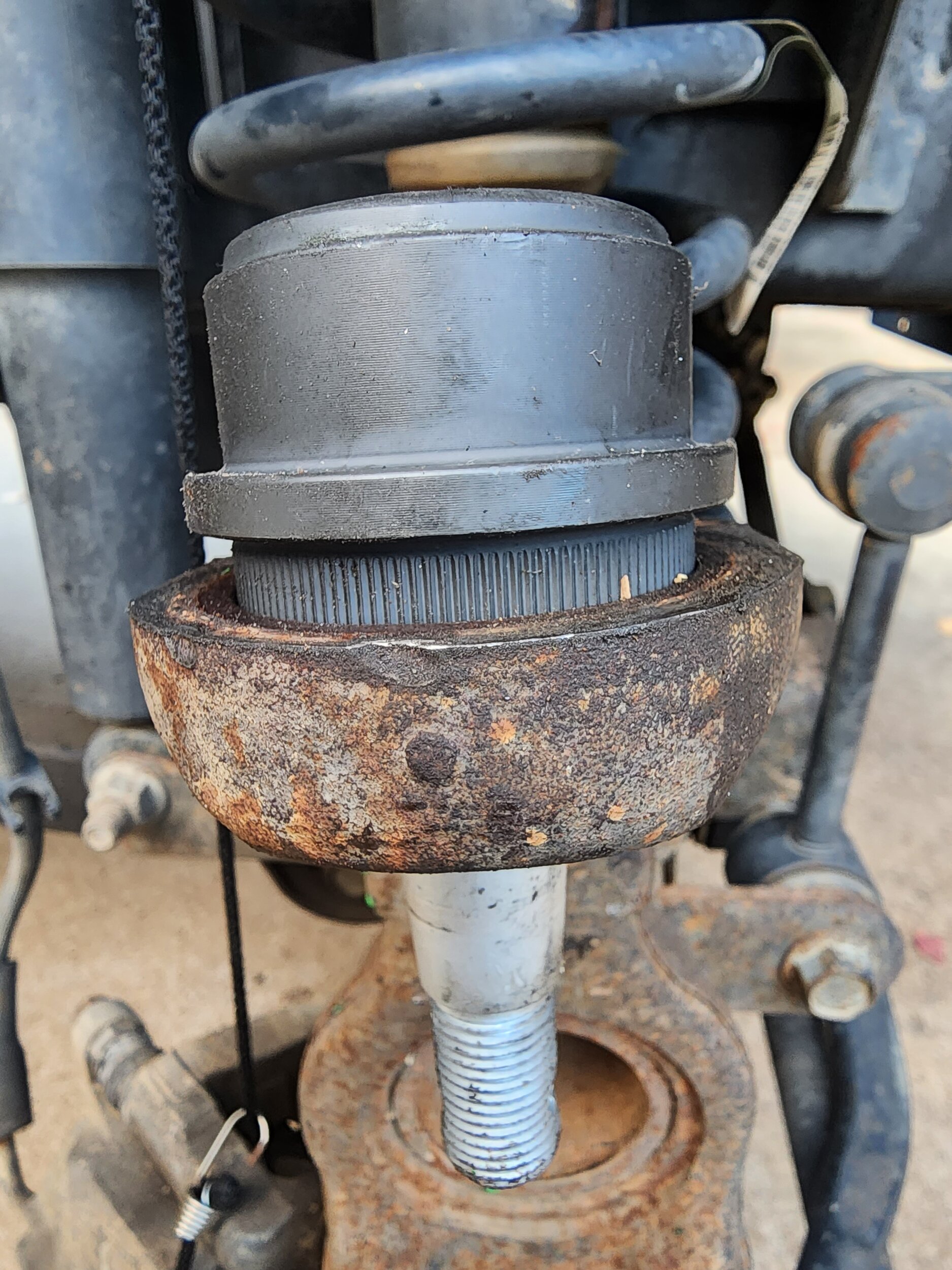

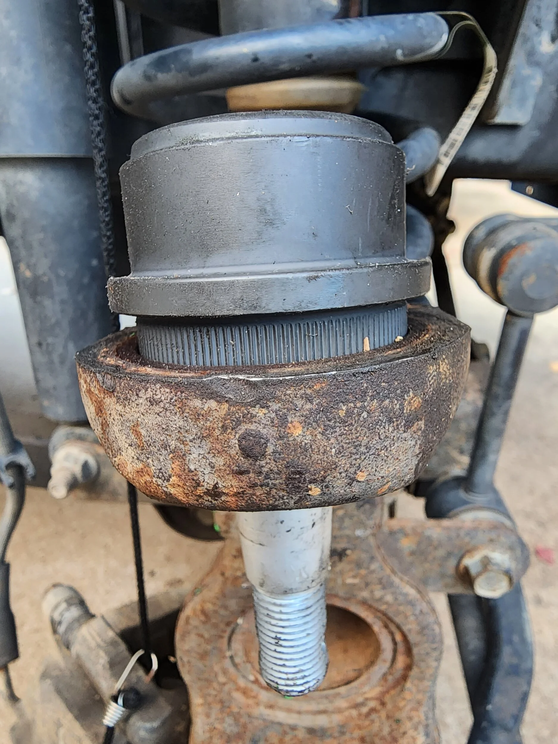

chrispeel2001 Member Joined Jan 14, 2023 Messages 26 Location Denton, TX Nov 25, 2023 #1 Replacing ball joints. I got the lower one in all the way but the upper one won't seat all the way. Not sure what to do. Any suggestions?
Dirty Dog JK Addict Supporting Member Lifetime Supporting Member Joined Sep 18, 2022 Messages 1,470 Location Pueblo West, CO Nov 26, 2023 #2 Odds are something is misaligned or damaged. Pull it apart and start over. Check for burrs.
OP chrispeel2001 Member Joined Jan 14, 2023 Messages 26 Location Denton, TX Nov 26, 2023 #3 Dirty Dog said: Odds are something is misaligned or damaged. Pull it apart and start over. Check for burrs. Click to expand... Got it seated finally. I was using the wrong collar for the bj press. Once I used the correct one it went in the rest of the way. Thank you for responding! Reactions: Dirty Dog, FishFam JKU, tJKrider and 1 other person
