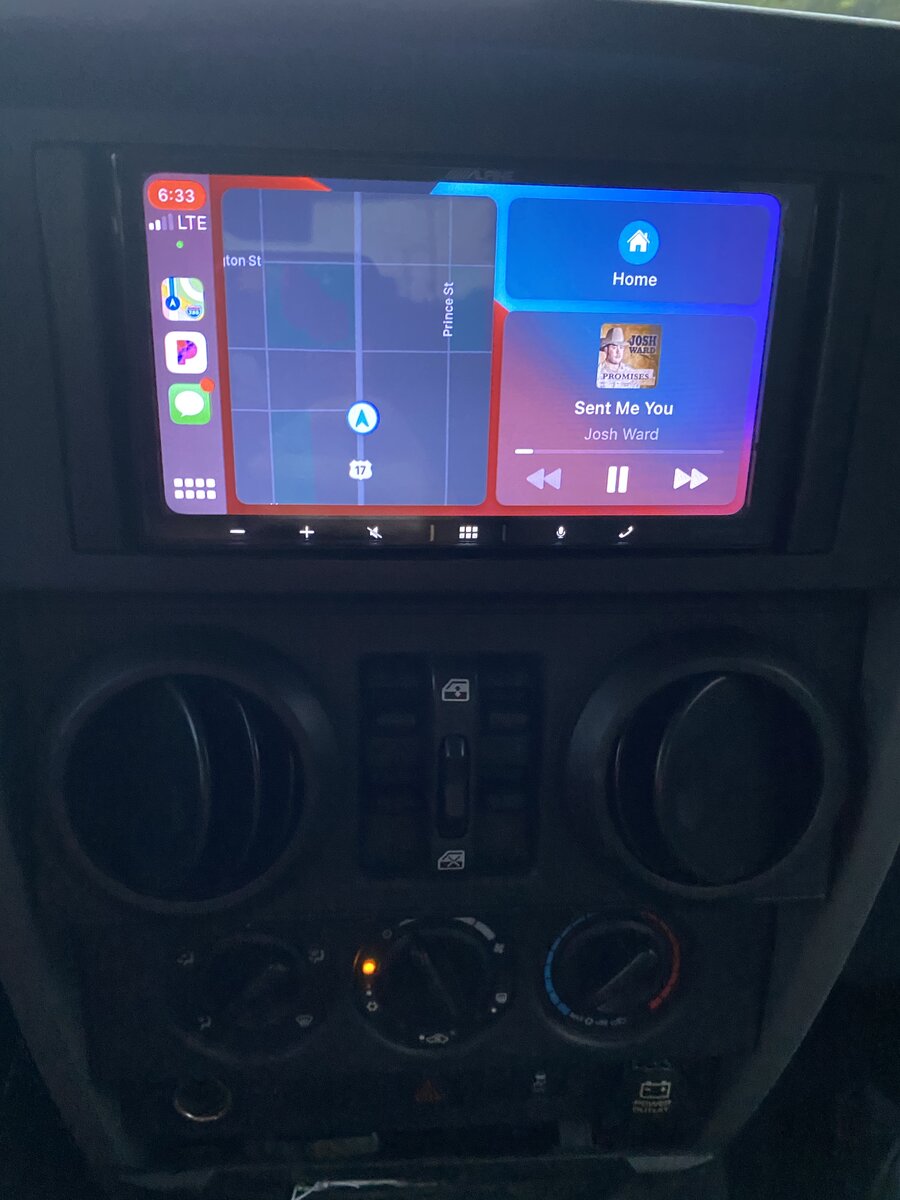

I just installed an Alpine ILX-W650 in mine yesterday. I got everything from crutchfield and it was a super simple install. I added a parking brake bypass and a cheap rear view camera to hook up also. All was less than $400.
