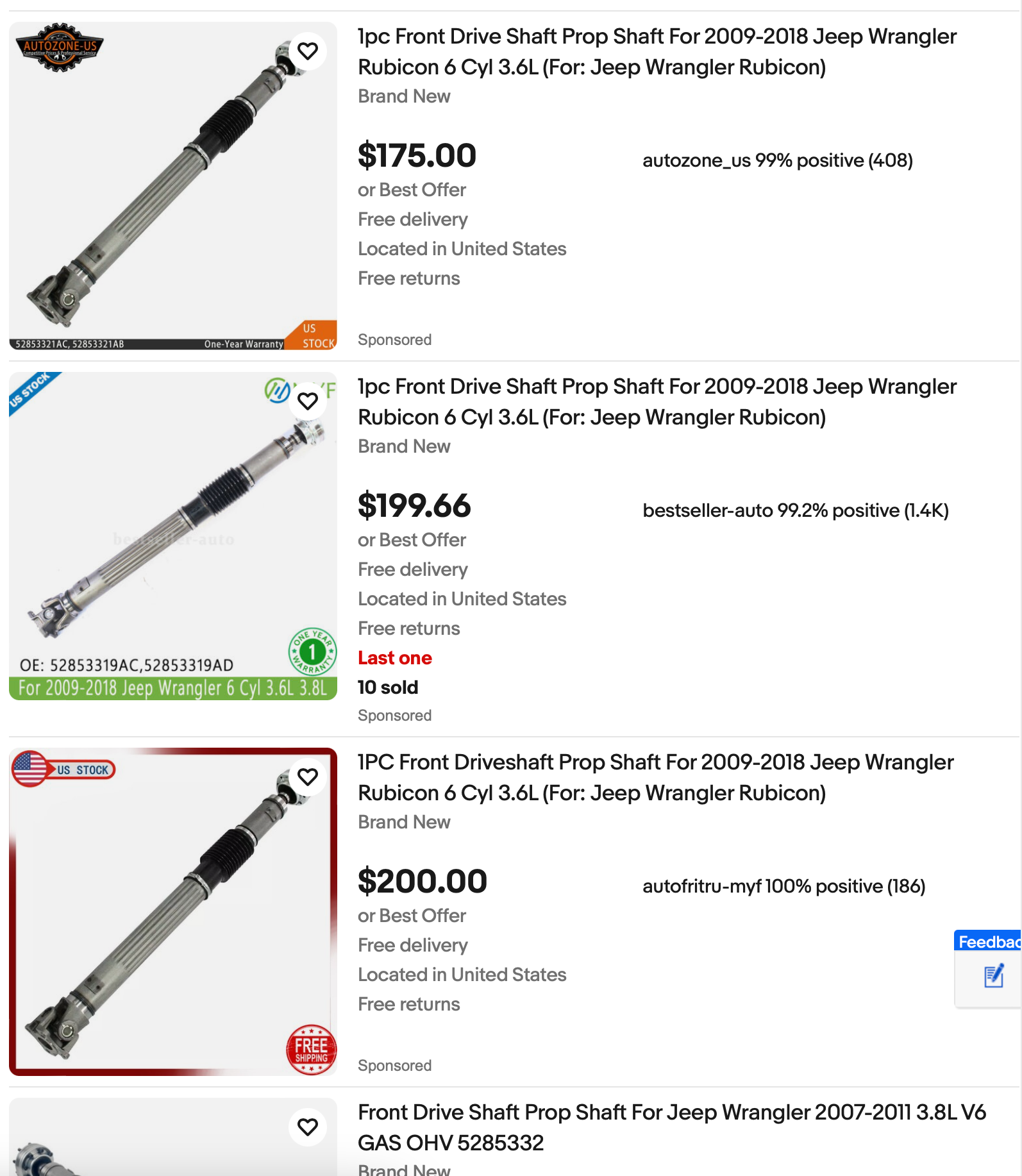

Hello y'all, I have a vibration above 70, and have had the wheels/tires road force balanced, tire pressure checked, and new shocks. The Jeep suspension is stock, and I am leaning towards an issue with the driveshafts and would appreciate thoughts on replacing the front driveshaft with one of these units on Ebay; I do not plan to lift the Jeep and off-road adventures are light.
